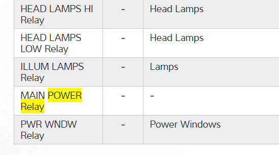

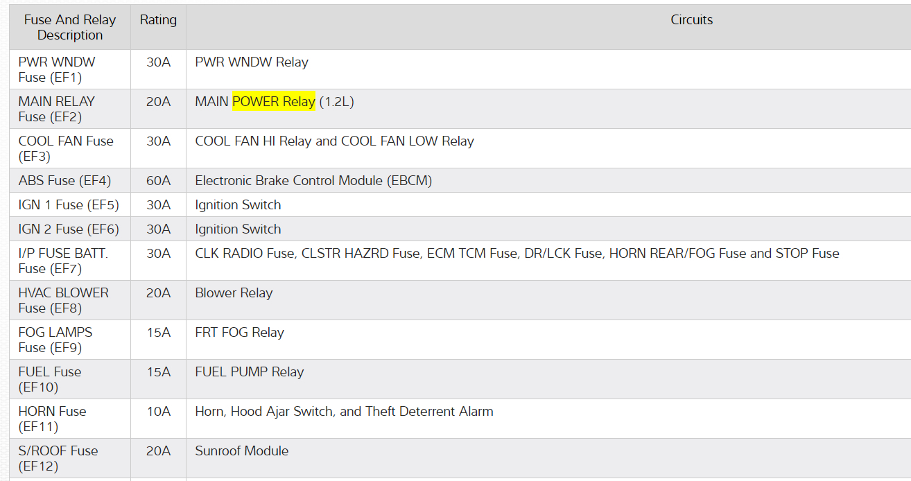

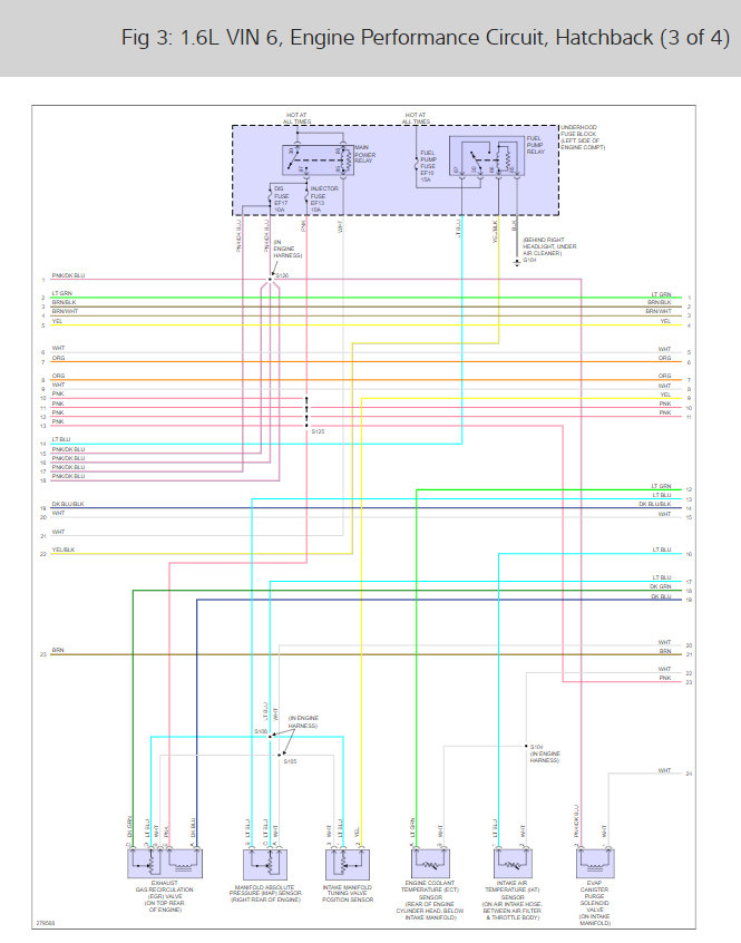

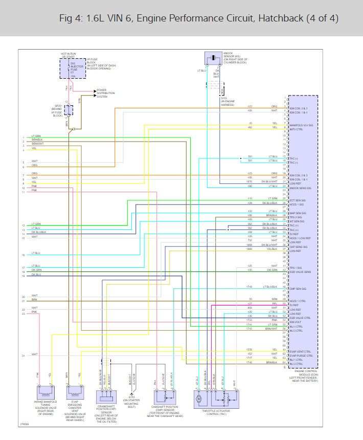

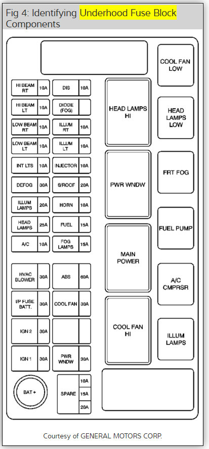

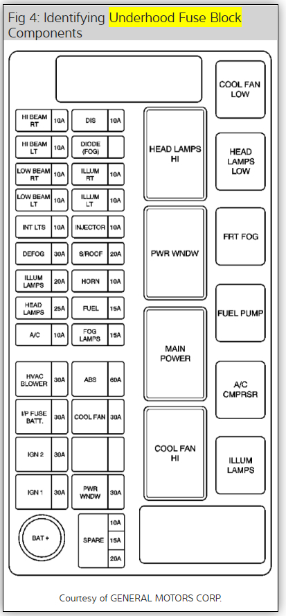

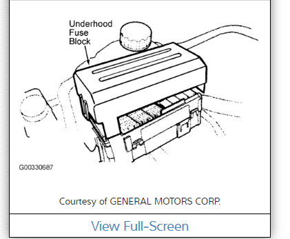

It sounds like the main power relay is not working. Here is a guide to help you test the relay:

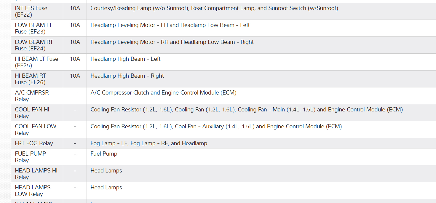

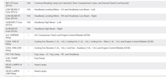

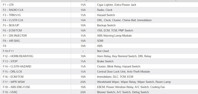

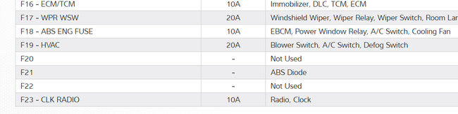

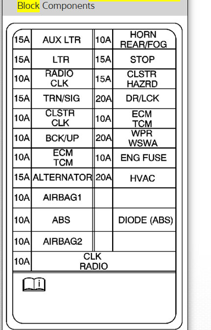

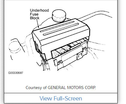

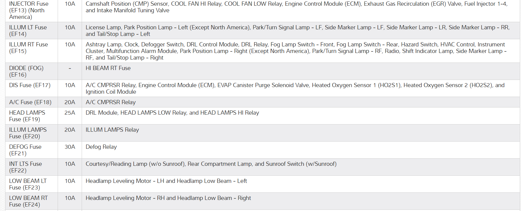

Here are the fuse panel and relay locations for your car. Check out the diagrams (below).
