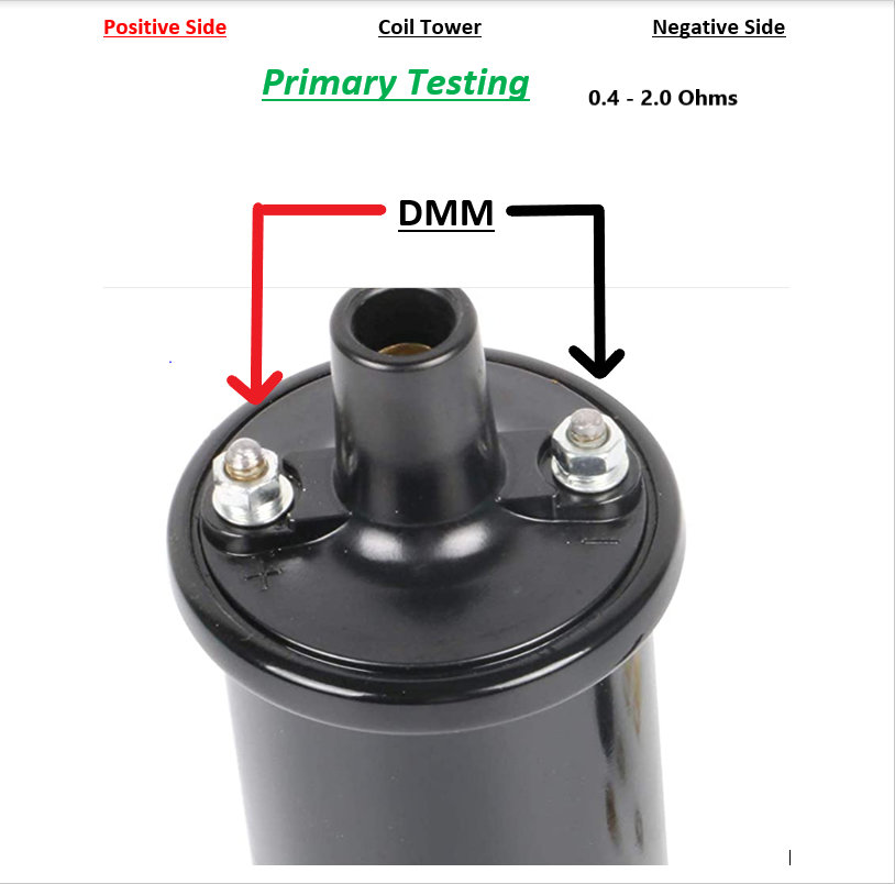

Primary Resistance Check
3) Primary Resistance check: Touch the red DMM terminal to the + side of the coil and the black terminal to the - side of the coil.
4) Expected Resistance: Many manufacturers indicate variations in the acceptable range, but in most cases, resistance will fall between 0.4 and 2.0 Ohms.

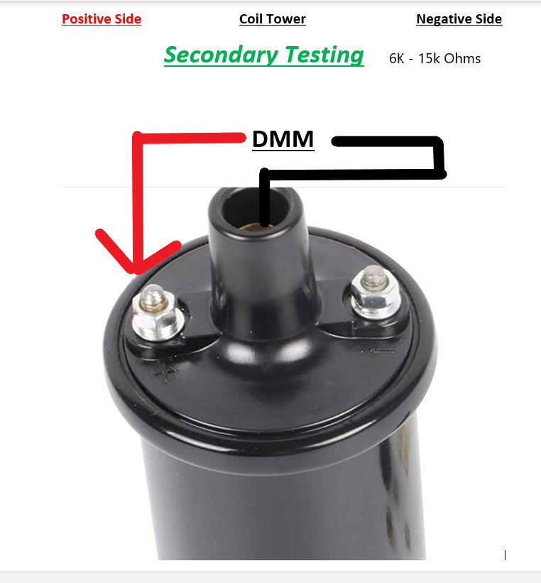

5) With the coil still disconnected, place the DMM red terminal on the + side of the coil.
6) Place the DMM black terminal to where the coil wire would go (coil tower).
7) Expected Resistance: Many manufacturers indicate variations considered in the acceptable range. However, in most cases, resistance will fall between 6K and 15K Ohms.
I tried to draw a couple of pics below to help identify where the wiring goes from the DMM.
If the readings are far from what I indicated, I suspect the coil is shorted internally and needs to be replaced.
