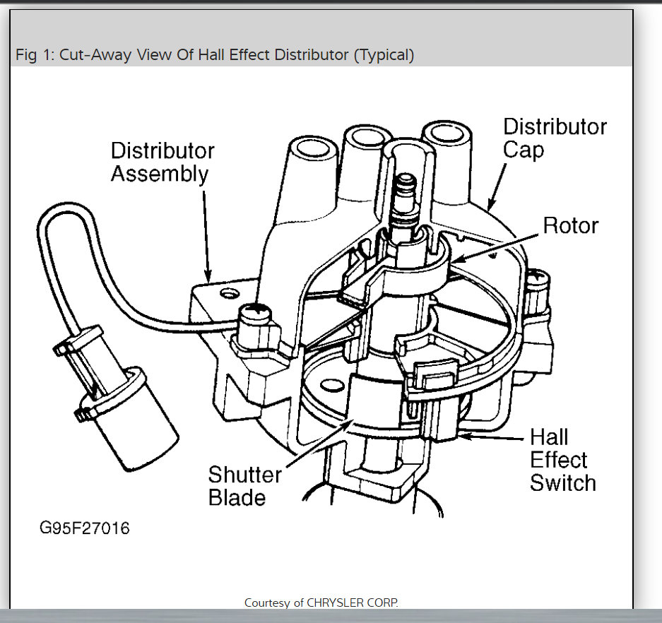

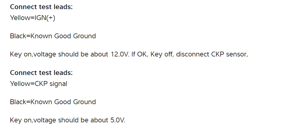

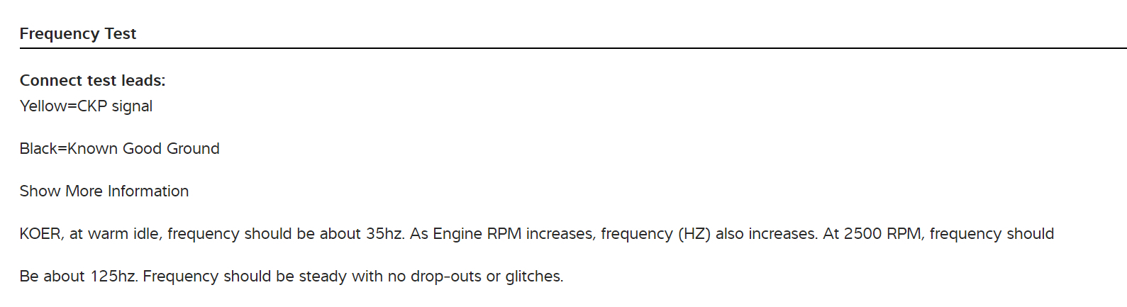

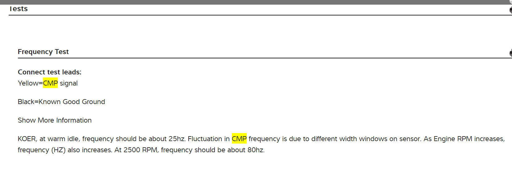

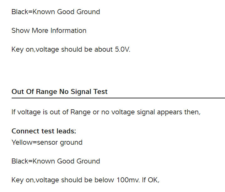

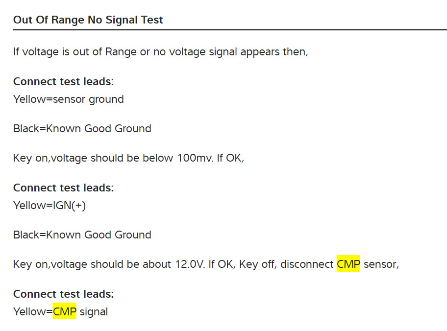

I have injector pulse, fuel pressure, had multiple misfire code 300, when it ran for a day power to coil 2 pins, no pulse from coil lead. all fuses good, relays good, no sensor codes. just bought it. feels like a bad coil when running, all sensors look like they have been replaced, timing on top dead center. coil is in distributor. how do I check coil values/crank sensor/ PCM/cam sensor no spark at plugs ?
