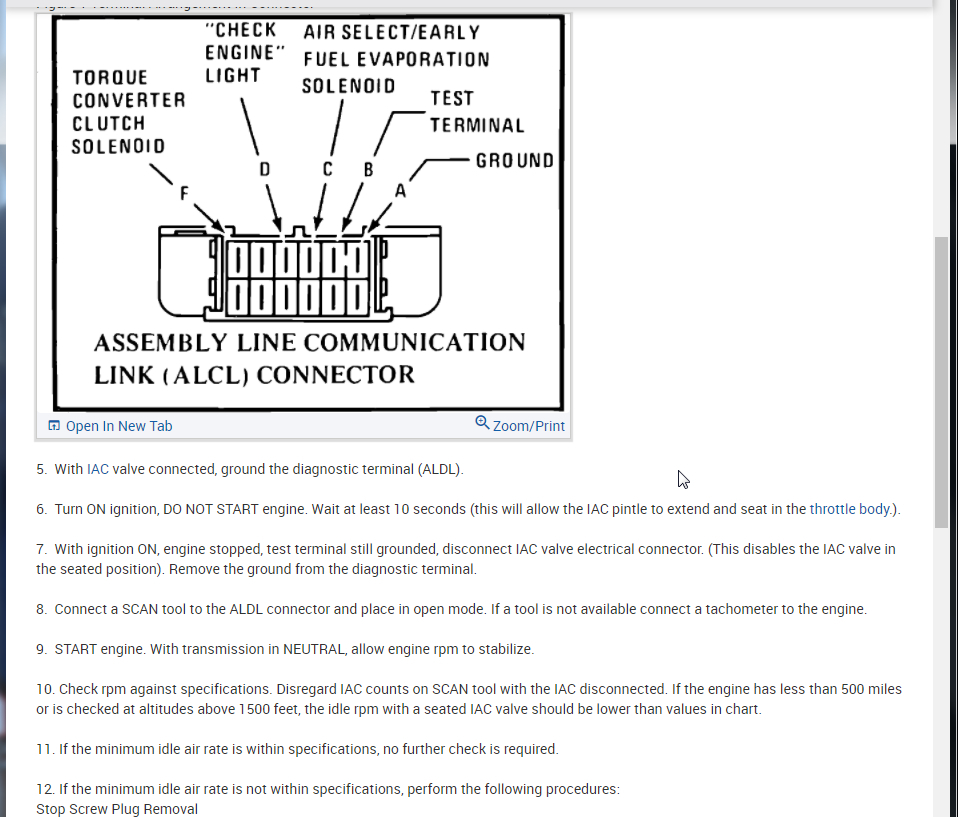

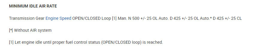

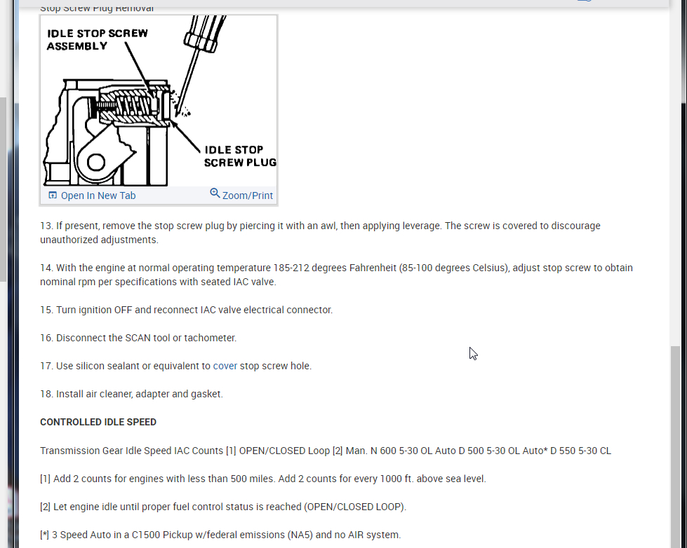

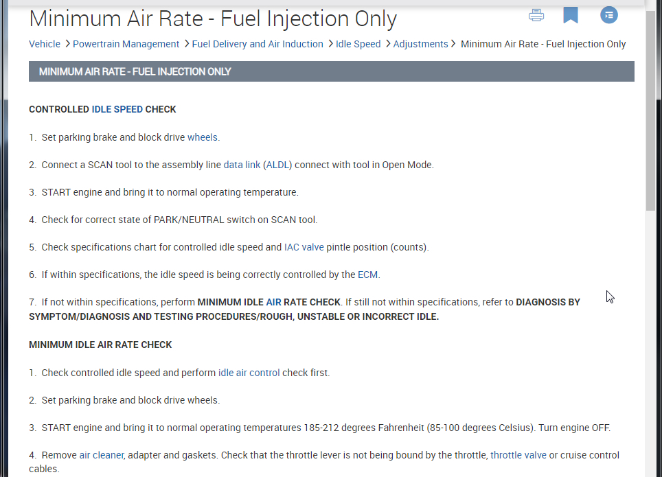

Also, we need to make sure the air flow rate is correct. I attached the process below that will help with this.
Let's run through this material and we can go from there. Thanks
