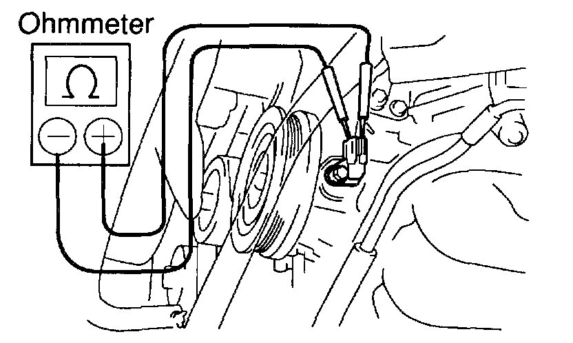

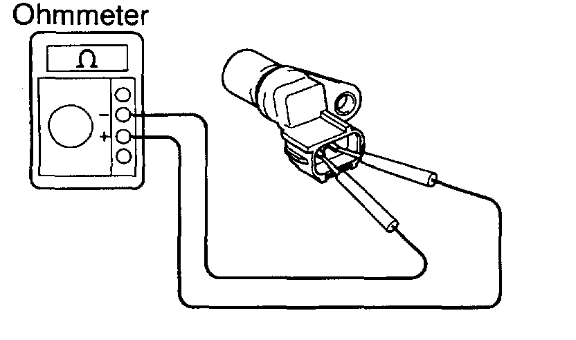

If there is no RPM signal, the first thing I would check is the crankshaft position sensor. Take a look through this link:
Here are directions specific to testing the one on your vehicle. The attached pics correlate with the directions.
1999 Lexus Truck RX 300 FWD V6-3.0L (1MZ-FE)
Component Inspection
Vehicle Powertrain Management Sensors and Switches - Powertrain Management Sensors and Switches - Computers and Control Systems Crankshaft Position Sensor Testing and Inspection Component Tests and General Diagnostics Component Inspection
COMPONENT INSPECTION

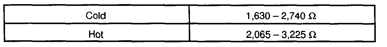

NOTE: "Cold" and "Hot" in these sentences express the temperature of the sensor itself. "Cold" is from - 10°C (14° F) to 50°C (122°F) and "Hot" is from 50°C (122°F) to 100°C (212°F).
INSPECT CRANKSHAFT POSITION SENSOR RESISTANCE
Using an ohmmeter, measure the resistance between terminals.
Resistance:
pic 1
pic 2
pic 3
RESISTANCE
If the resistance is not as specified, replace the crankshaft position sensor.
