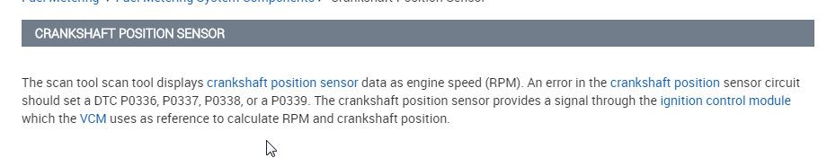

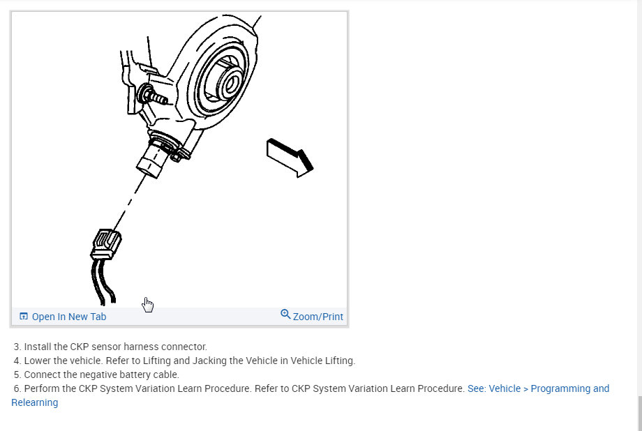

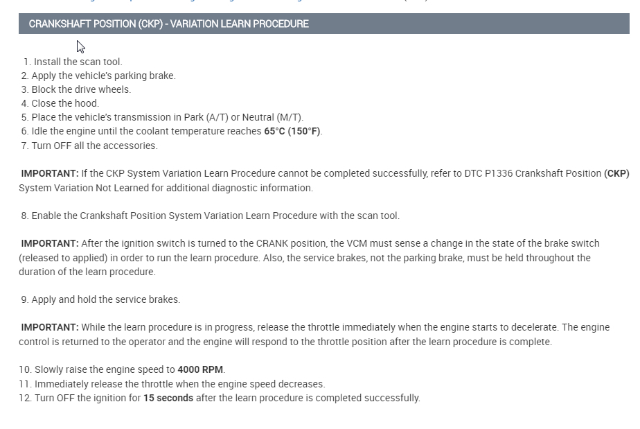

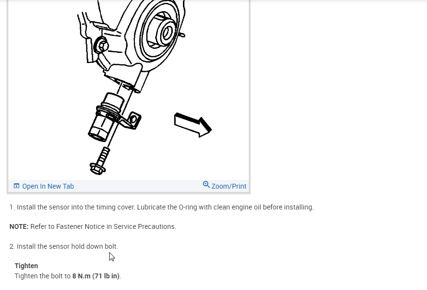

This sounds like a crank sensor issue. Here is a guide that walks through the symptoms of a cranks sensor issue. Pay particular attention to its intermittent operation when it gets hot.

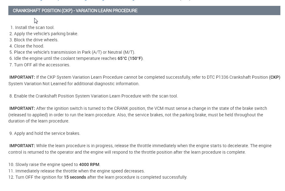

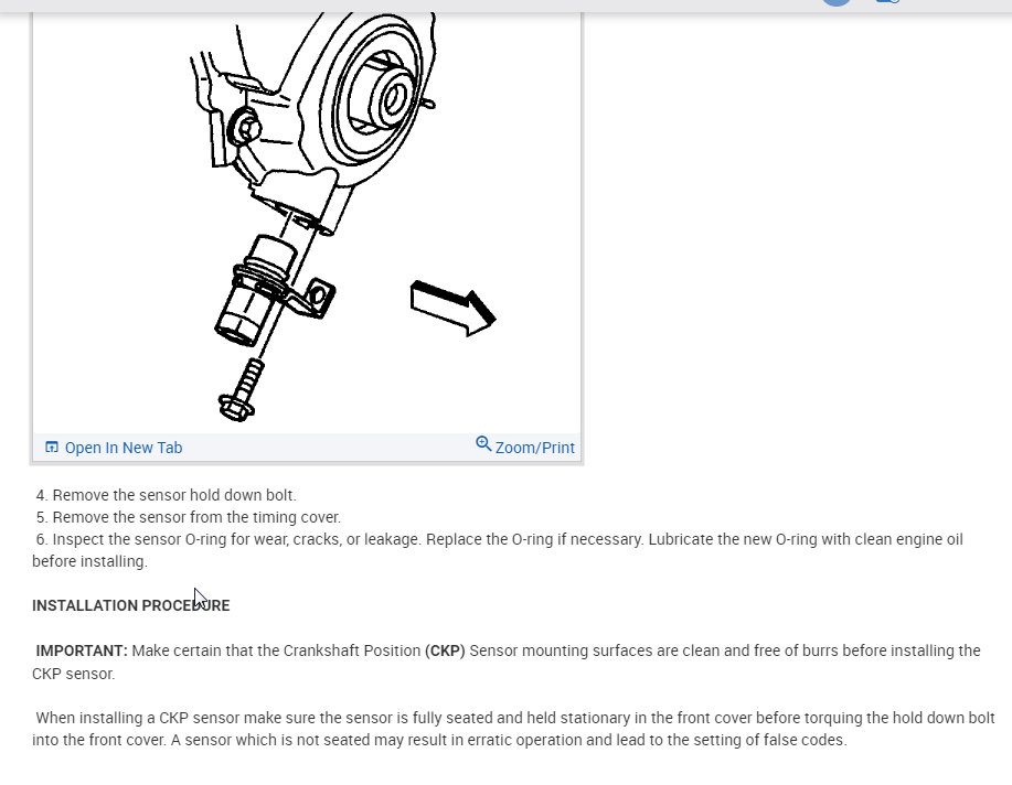

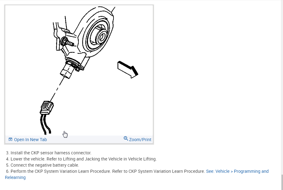

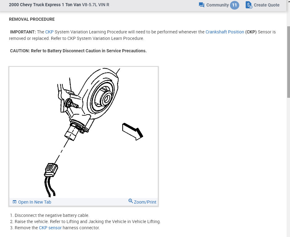

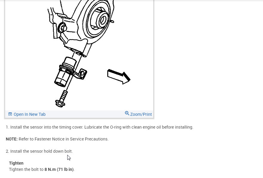

Attached is the procedure to replace it if you find it is the issue. Thanks
