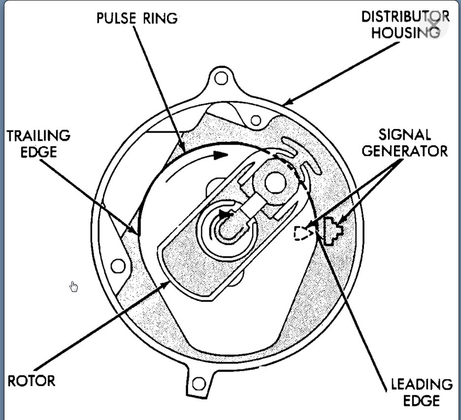

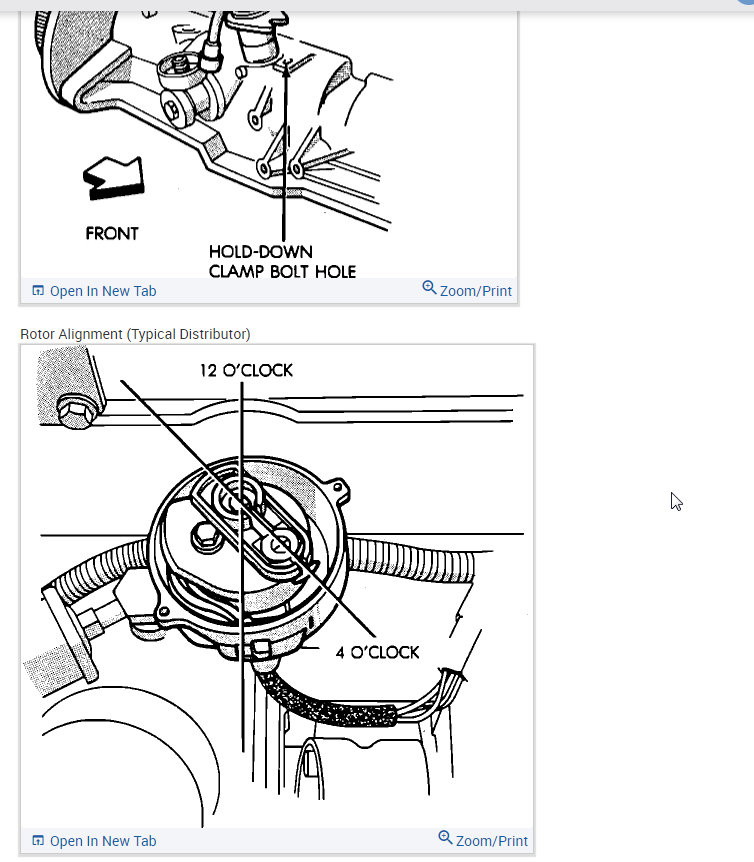

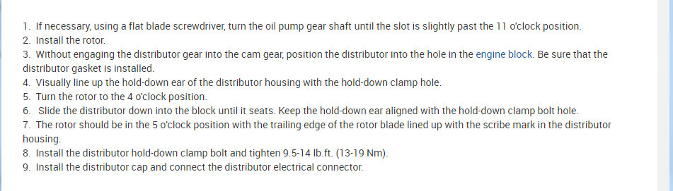

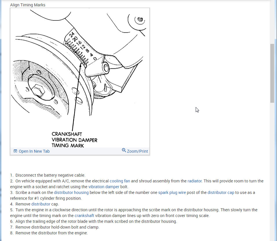

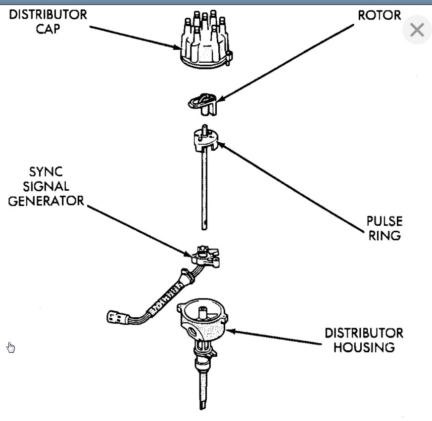

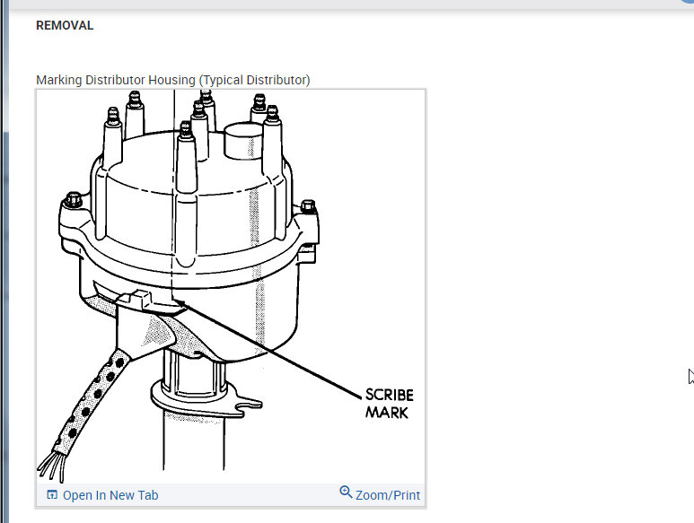

Vehicle listed above is a Cherokee.. Cranks but won't start. Spark on #1 and #2 cylinders only. Good fuel pressure. Replaced the Crankshaft position sensor, coil and the distributor pickup (camshaft) senor in the distributor. Cleaned the grounds. What am I missing? Any help would be appreciated, I'm pointing my finger at the PCM, but usually when I head down that road I'm wrong.
