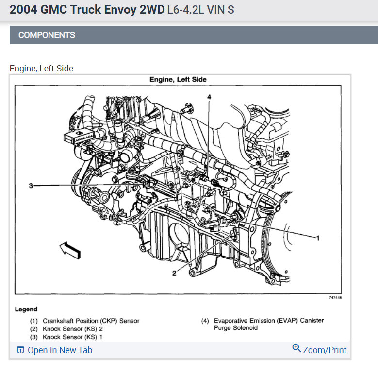

It sounds like the crankshaft angle sensor is not working this guide can help us check it with the location of the sensor in the diagrams below.
Check out the diagrams (Below). Please let us know what you find. We are interested to see what it is.
