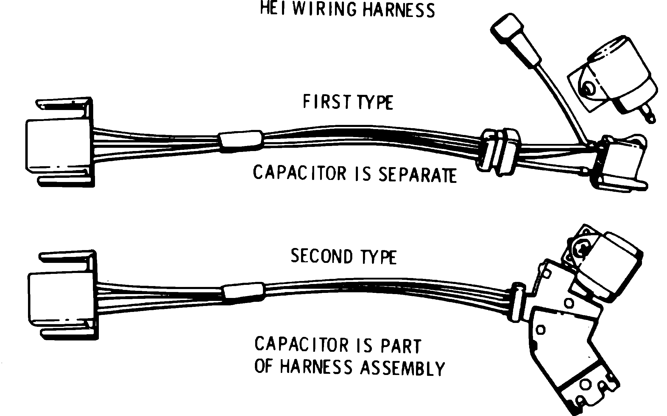

Okay, someone has changed it to HEI. It came with points and condenser. Lets try something. There are two wires in the plug on an HEI distributor, the hot wire and the tachometer wire. Run power to the hot wire on the HEI primary plug and see if it starts or if you get spark.
I attached two pictures. They show the first and second type of HEI connectors. See if it is what you are dealing with.
