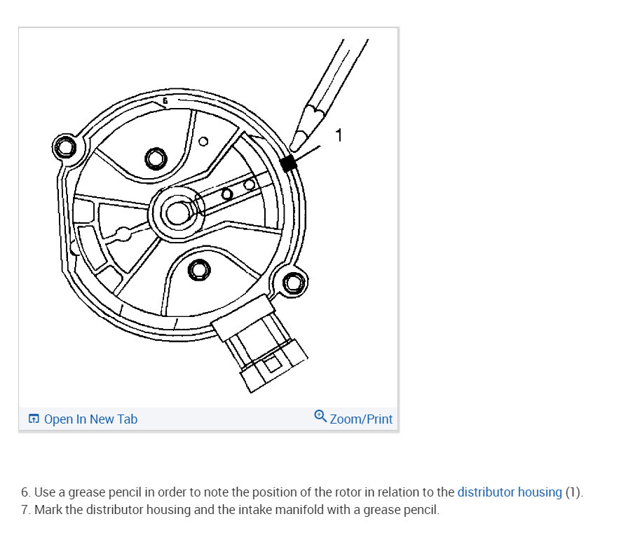

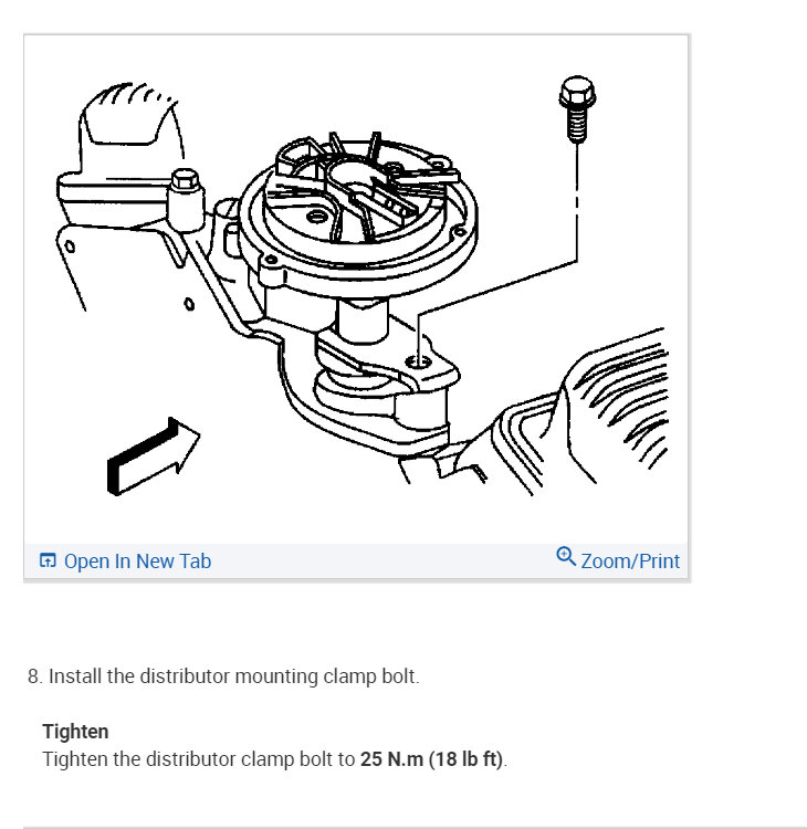

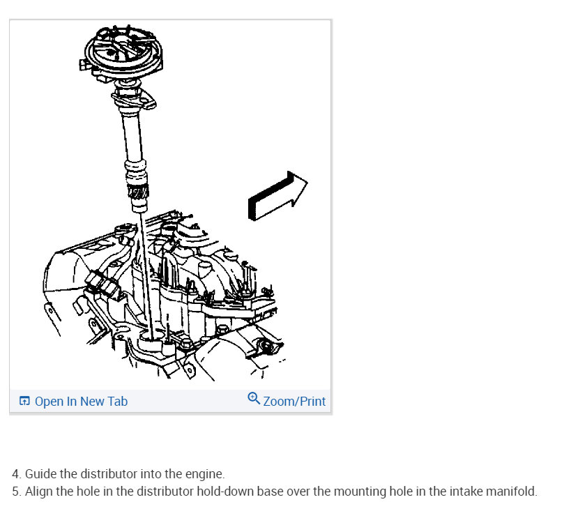

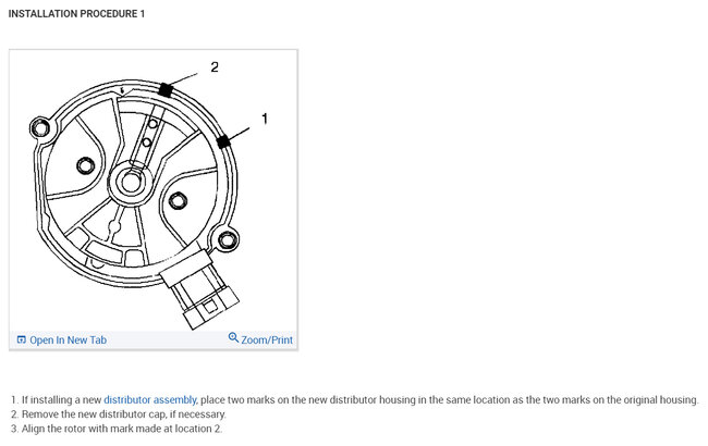

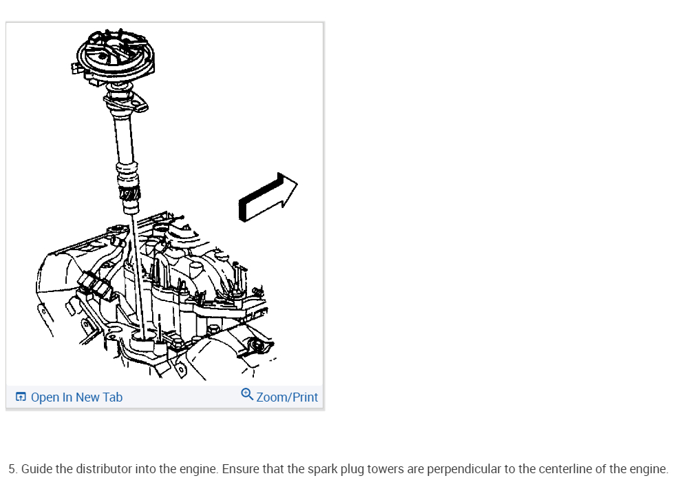

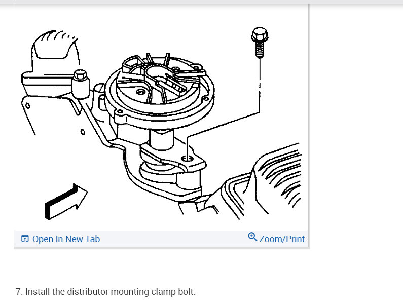

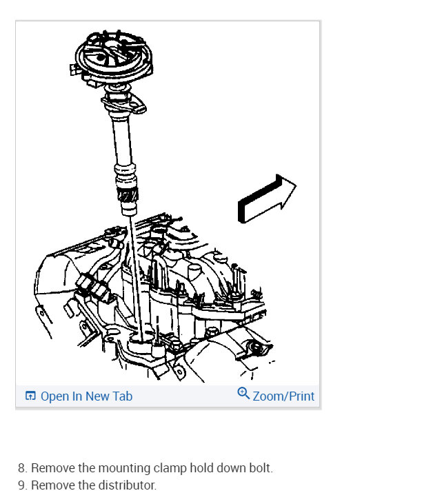

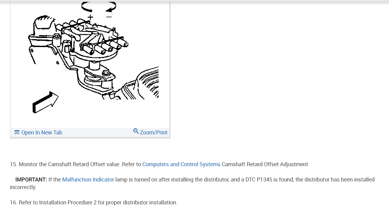

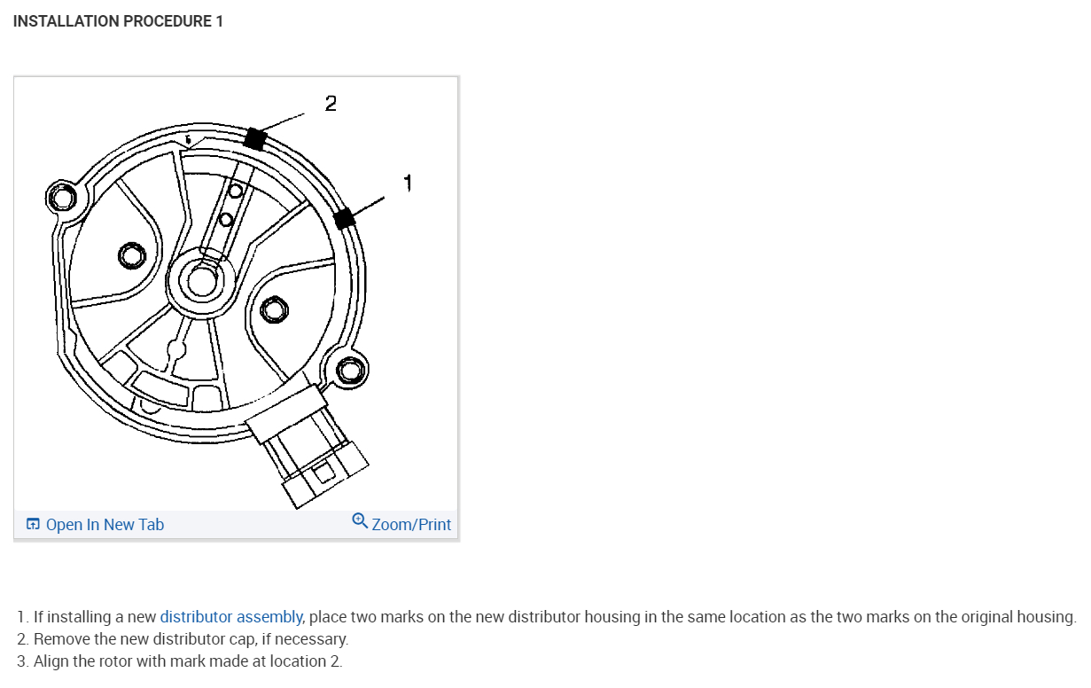

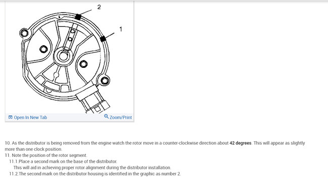

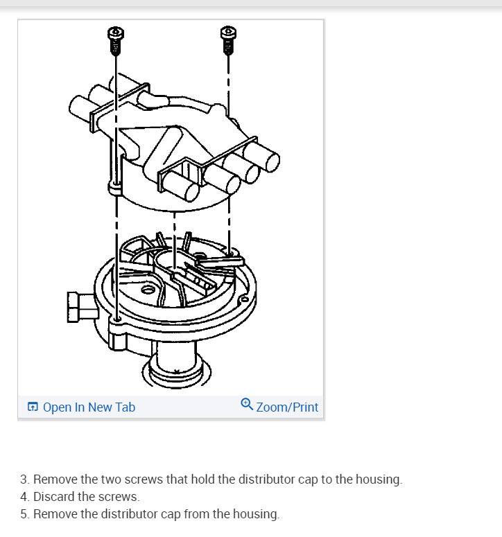

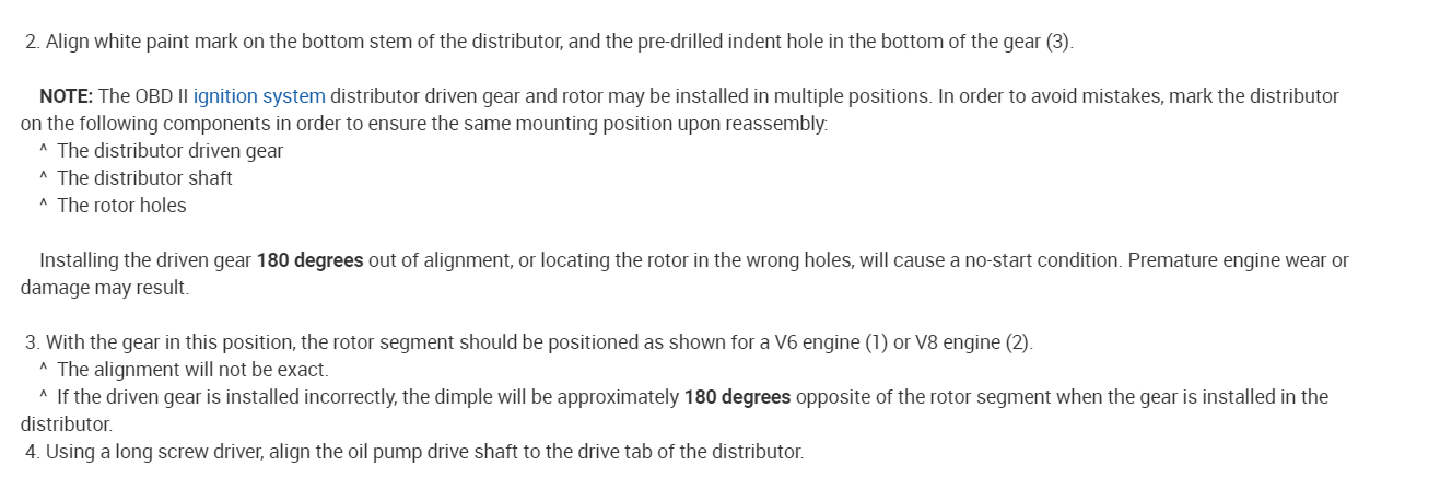

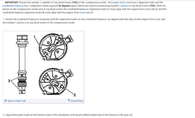

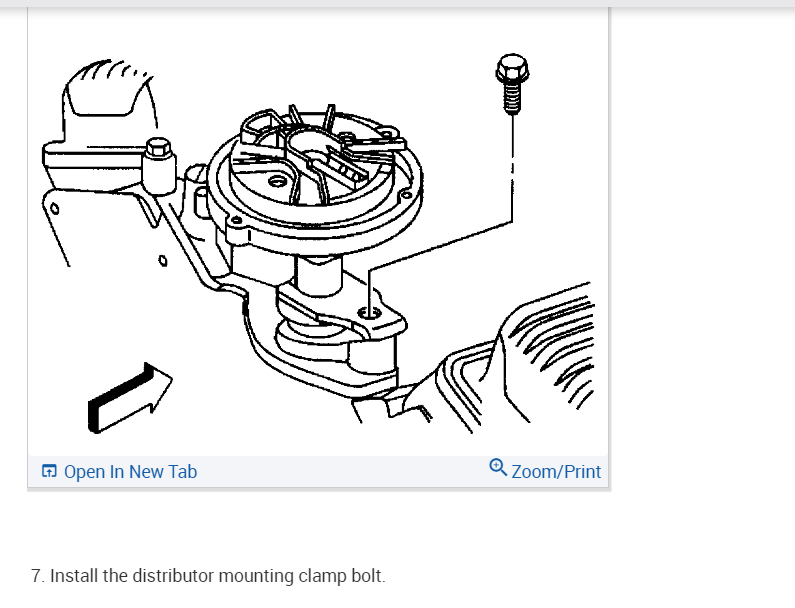

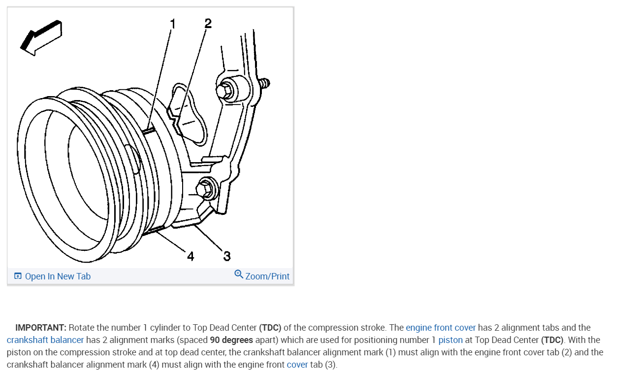

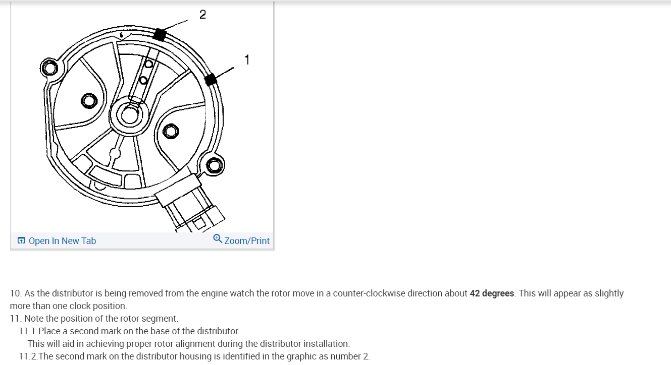

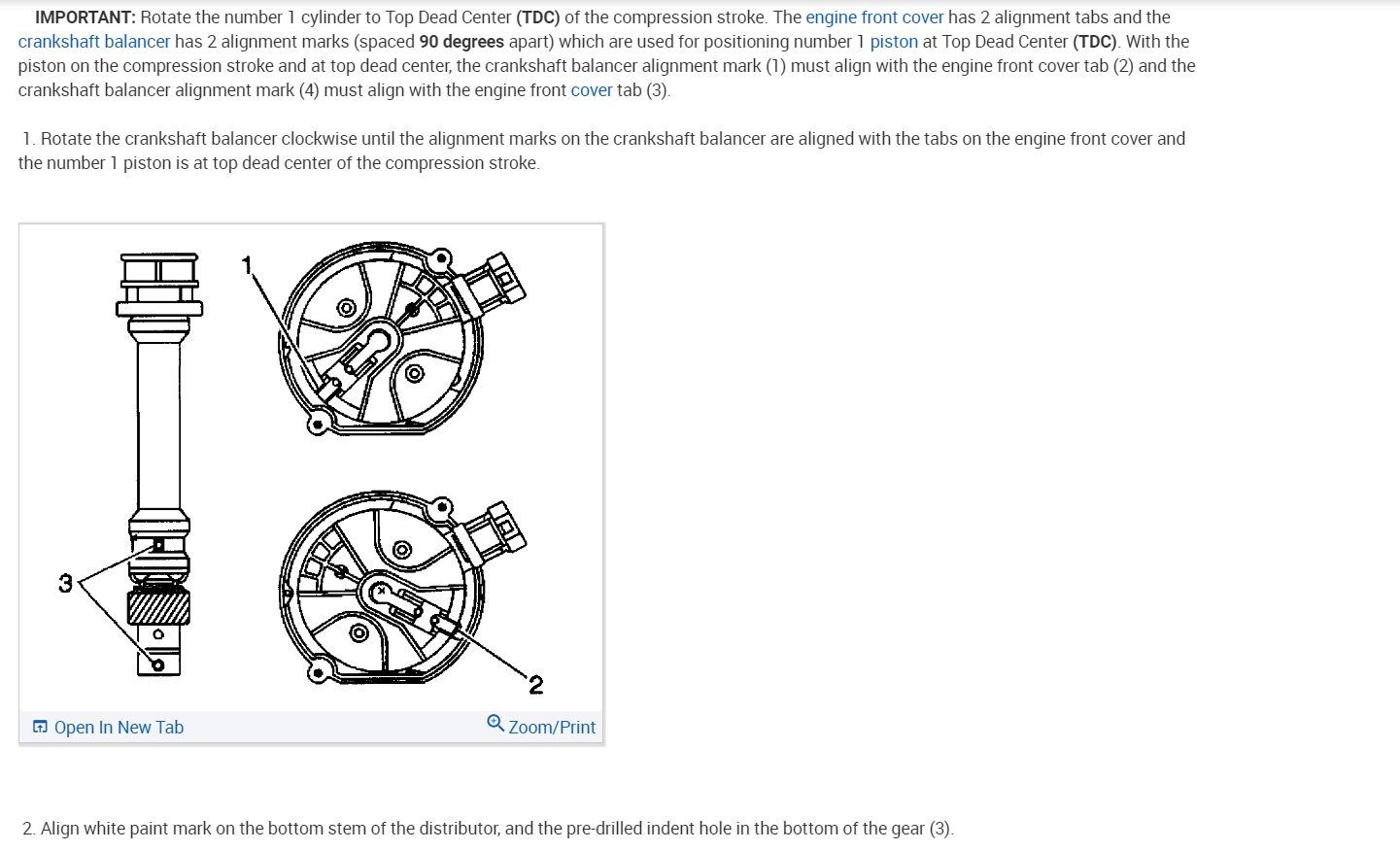

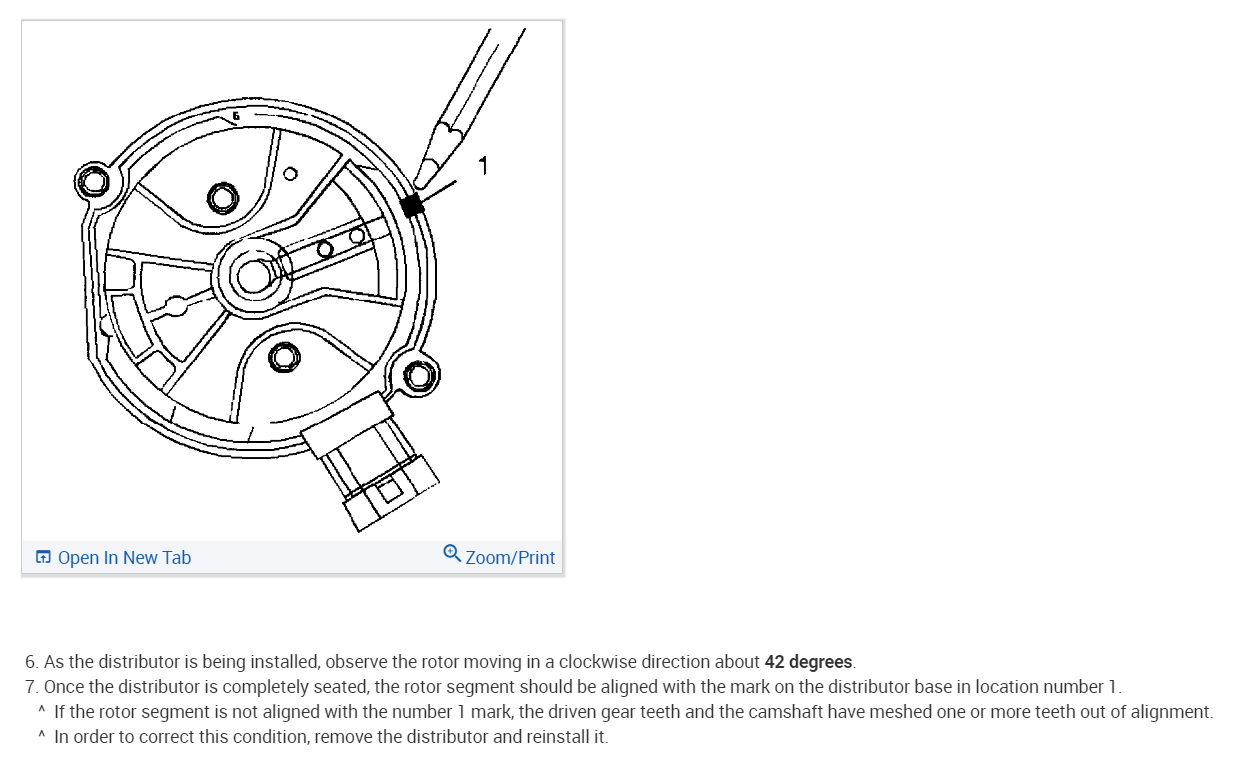

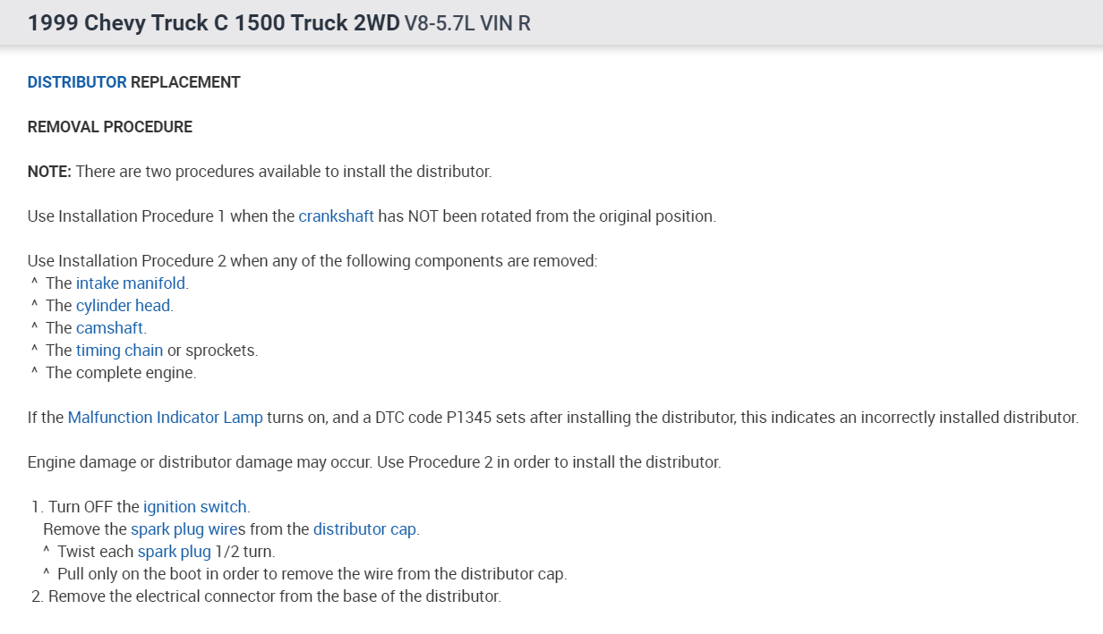

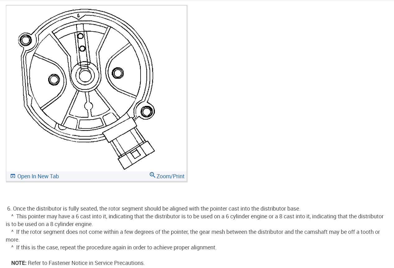

It sounds like the distributor is not installed correctly so the timing is off. Here are the instructions on how to install the distributor correctly. Check out the images (below). Please let us know what happens.
Sep 12, 2023 at 1:33 PM
AYME
  • 15 POSTS
The distributor was checked, checked, checked again, and checked again when it was put in.

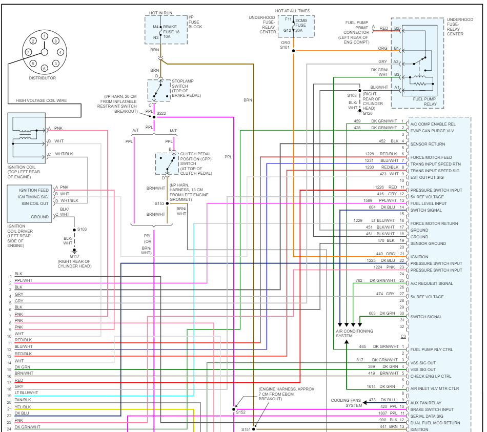

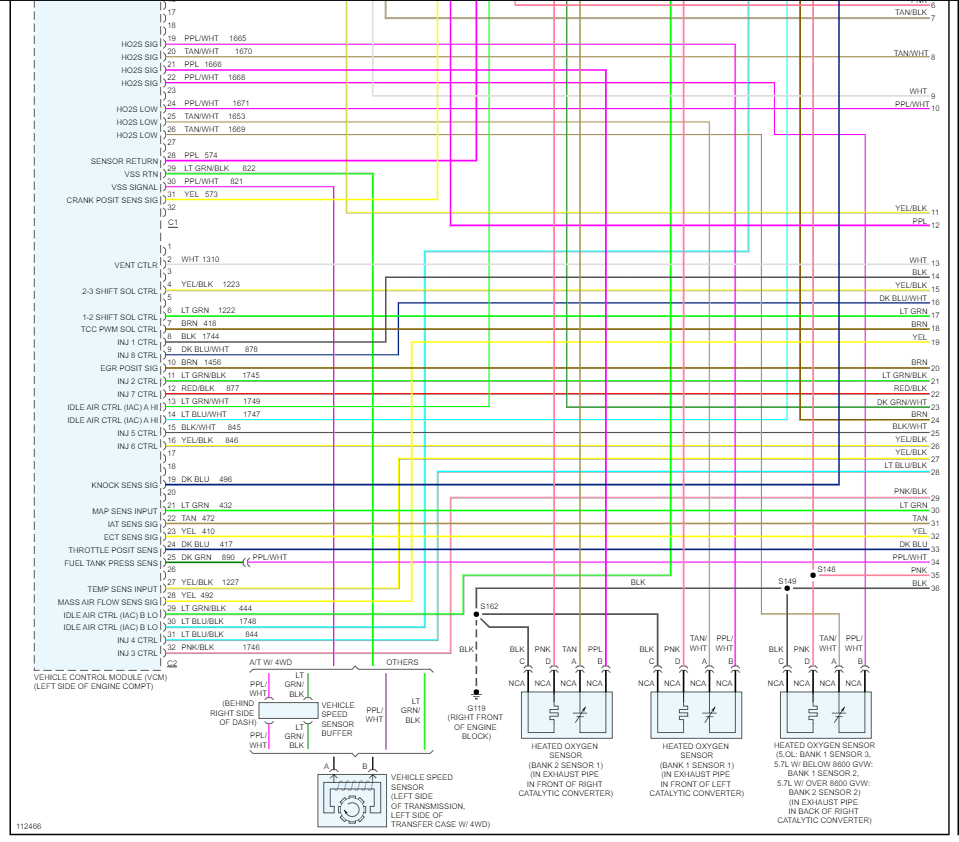

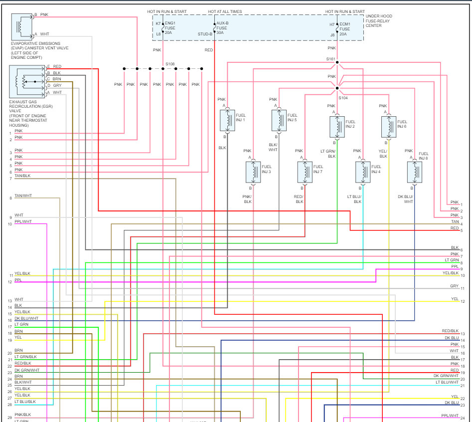

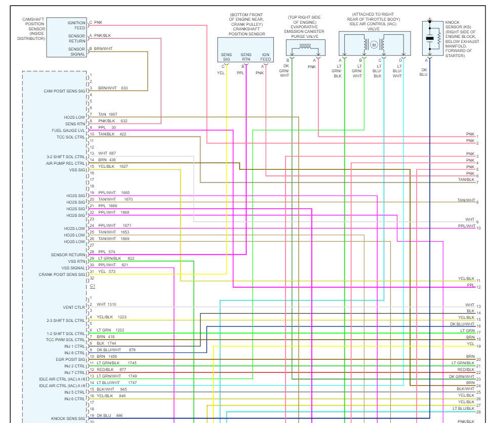

Okay, do you have power at the positive side of the coil (pink wire - key on).
This guide can help:

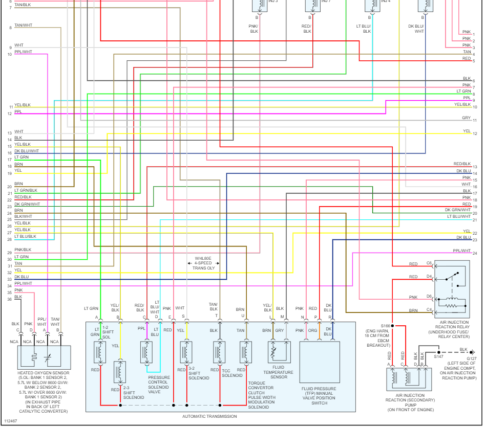

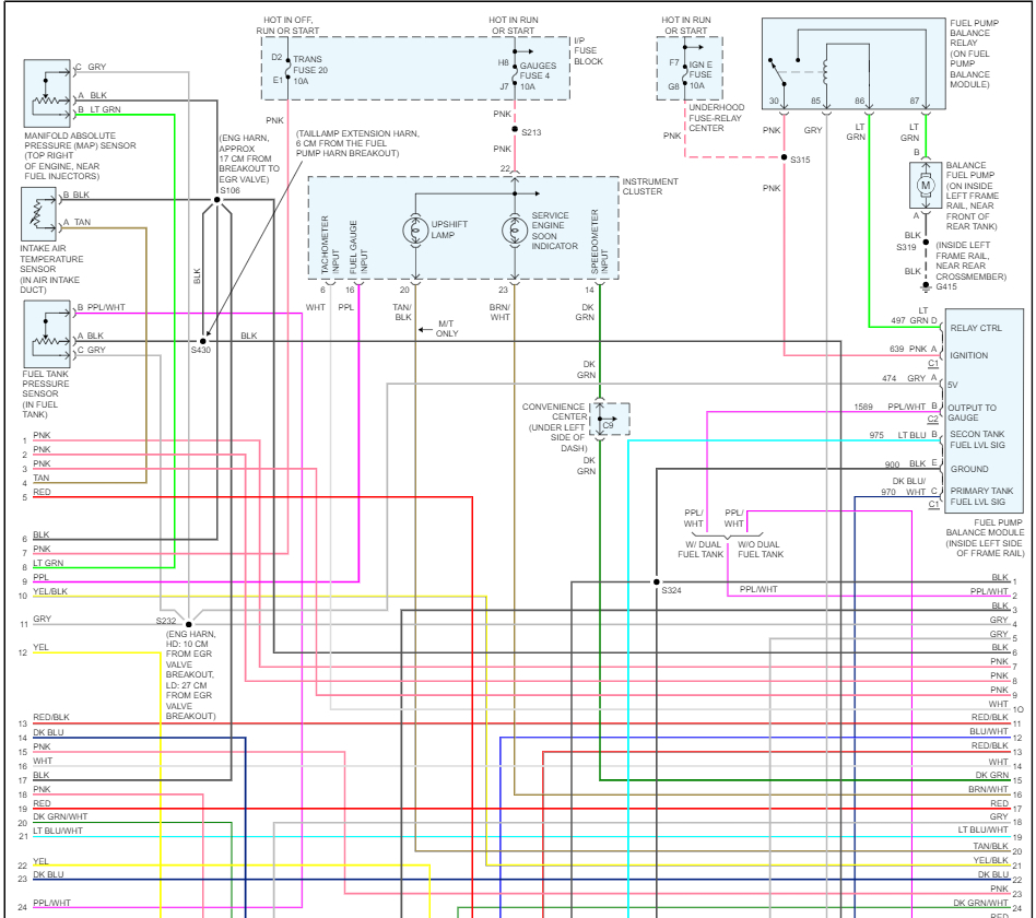

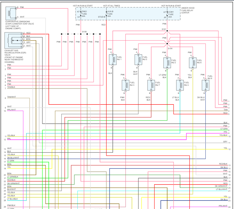

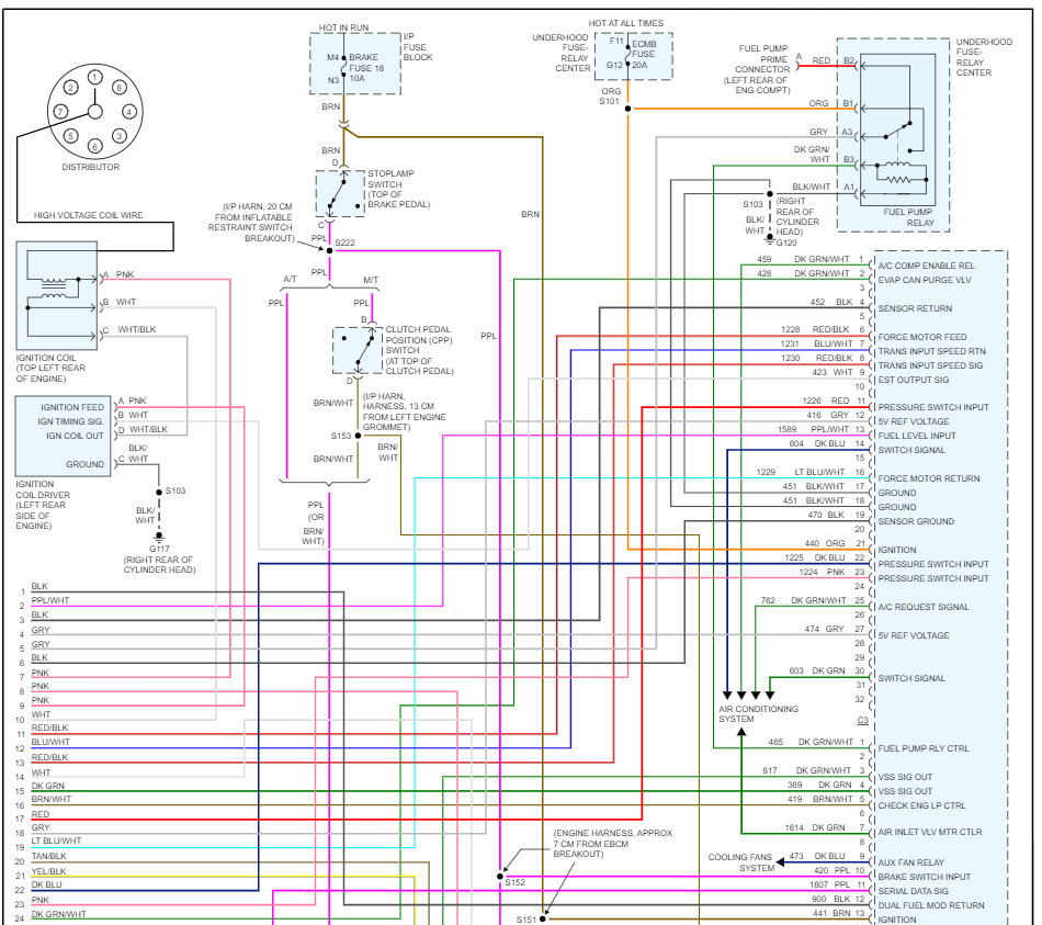

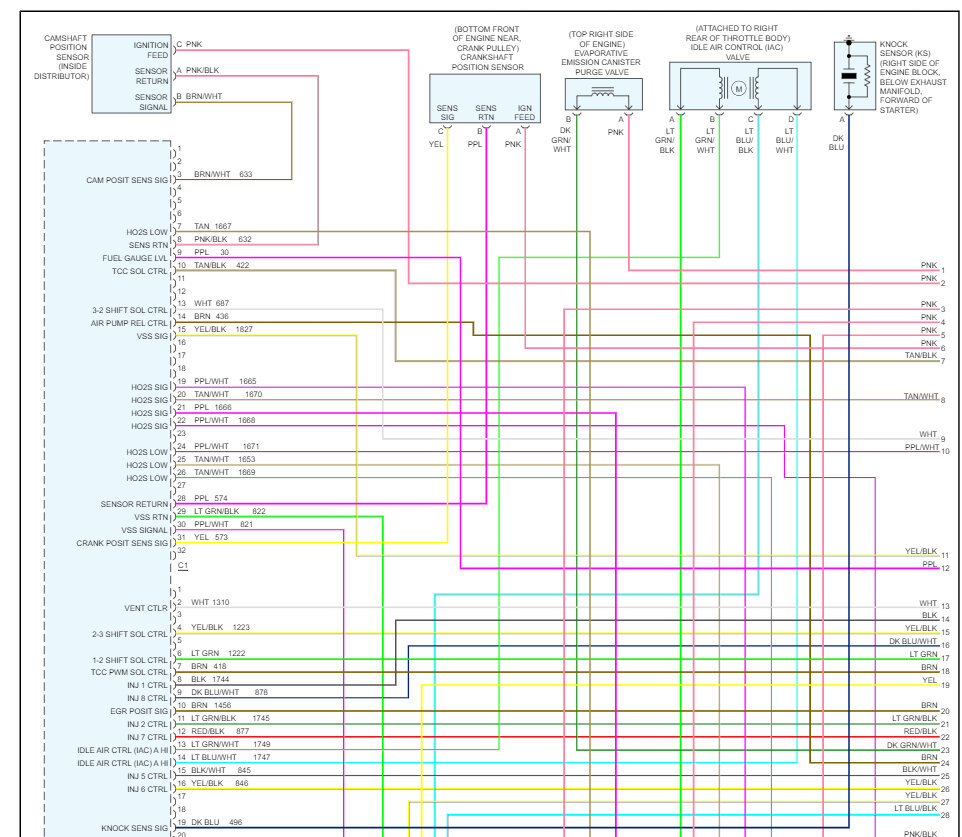

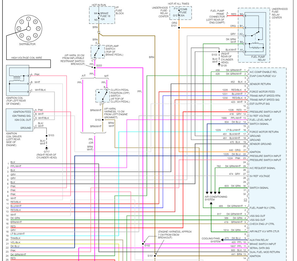

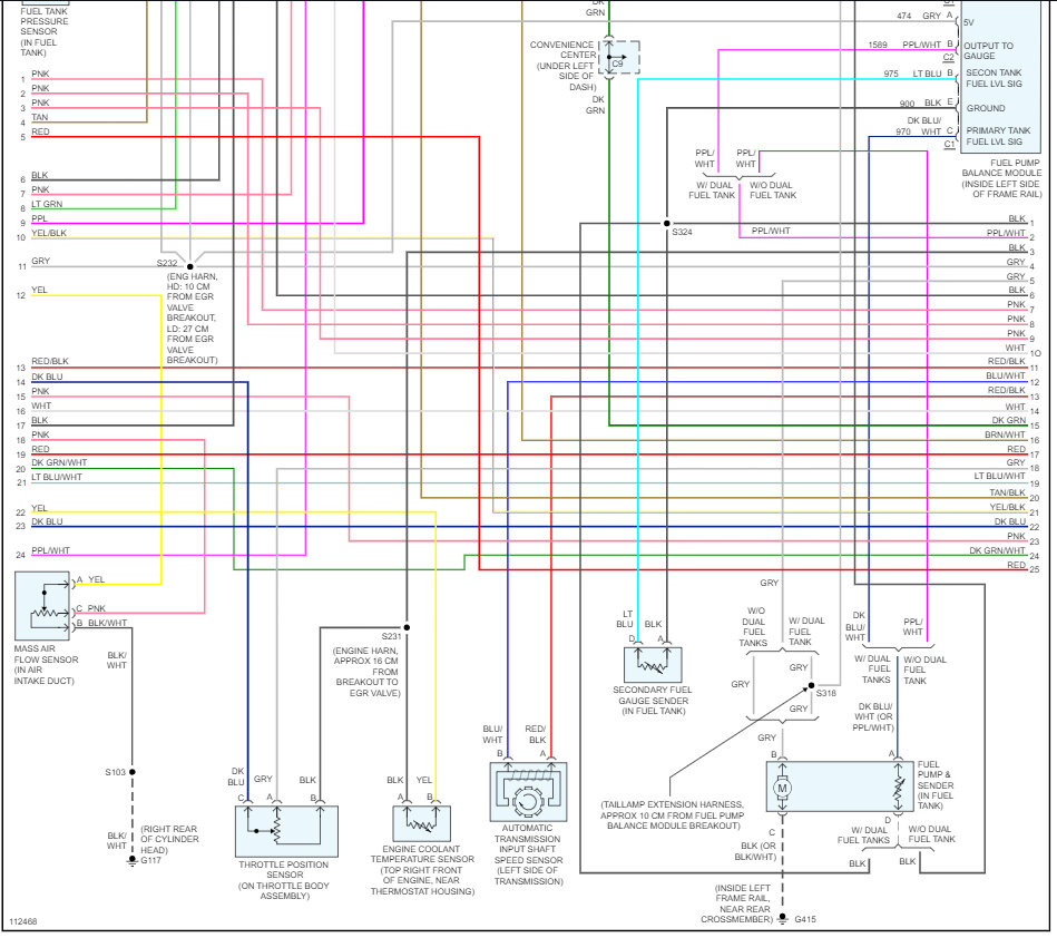

Also, do the same test for the pink wire on the fuel injectors, I would check all fuses in the vehicle and here are the engine wiring diagrams so you can see how the system works.
The wiring diagrams show which fuses to check the PCM and ignition system. Check out the images (below). Let us know what happens and please upload pictures or videos of the problem so we can see what's going on.
Sep 13, 2023 at 11:02 AM
AYME
  • 15 POSTS
Yes, power to positive side of coil and yes power to fuel injectors. Have checked all fuses multiple times.

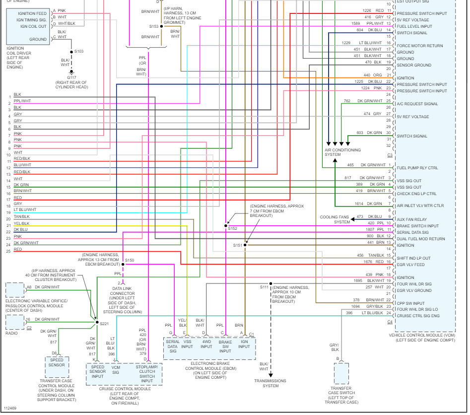

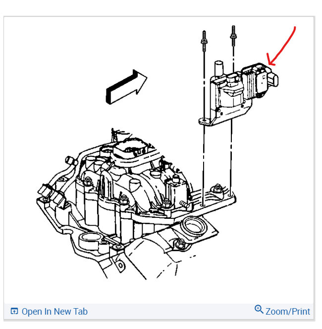

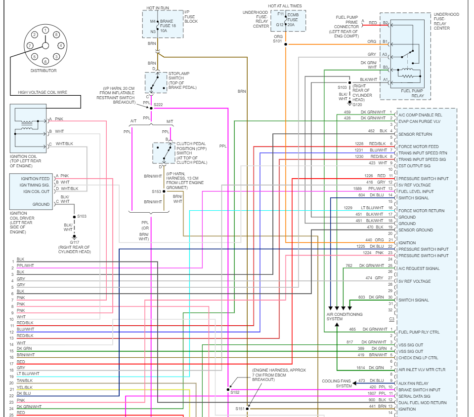

Sorry, the opposite side of the coil, which is either white wire should tell you, remove the connector to test. Also, I have seen the coil driver module go out and cause this issue as well. Here are the coil and module wiring diagrams so you can see how the system works. Check out the images (below). Please let us know what you find.
Sep 25, 2023 at 8:58 AM
AYME
  • 15 POSTS
Nope... No flash... next?

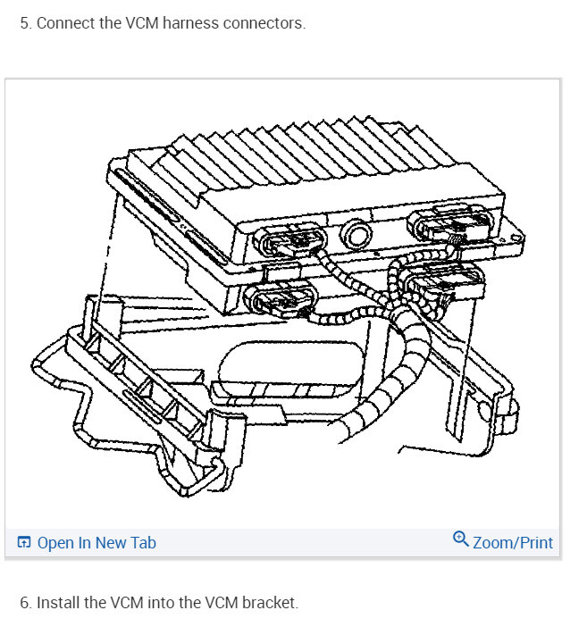

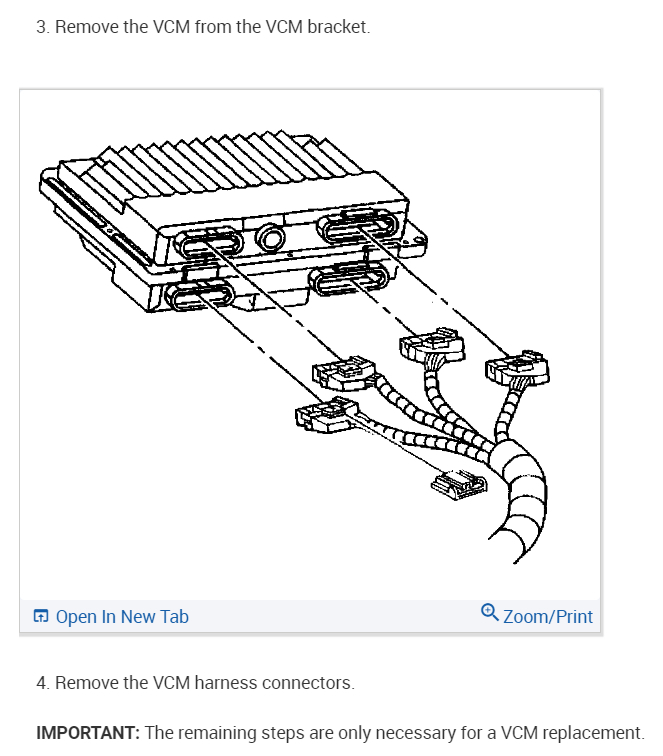

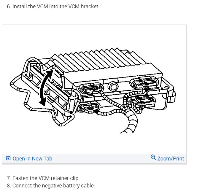

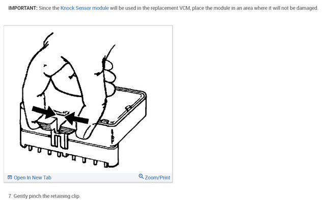

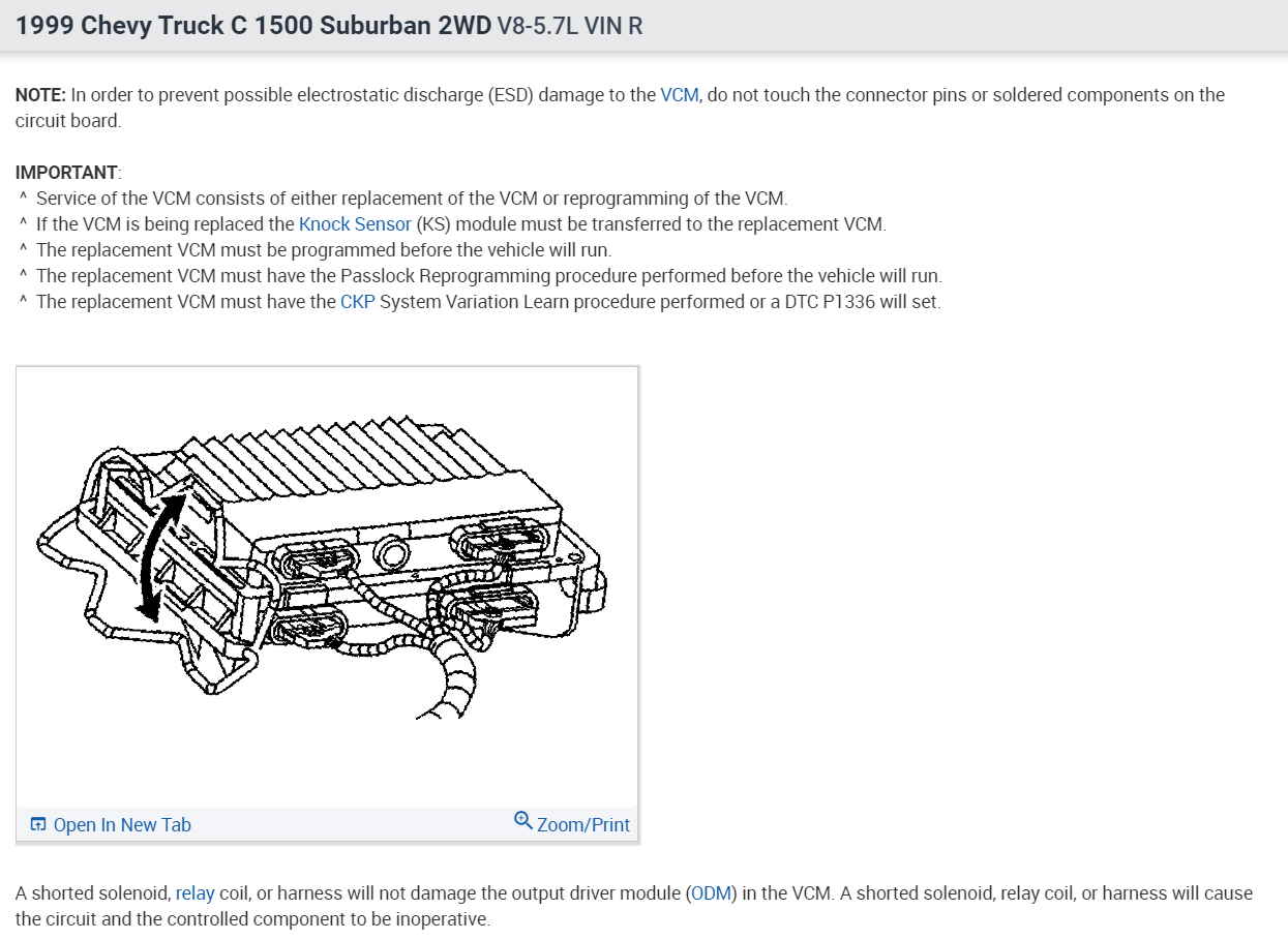

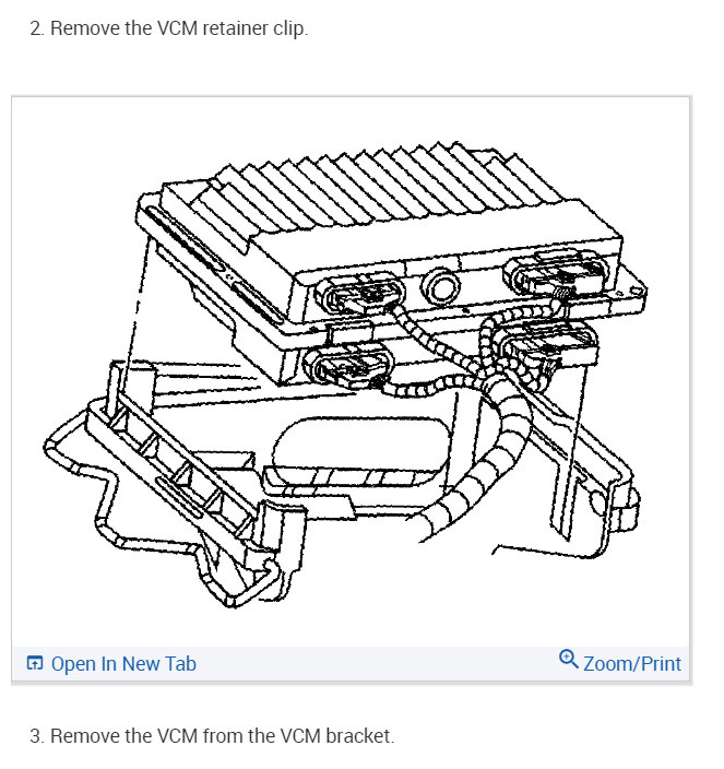

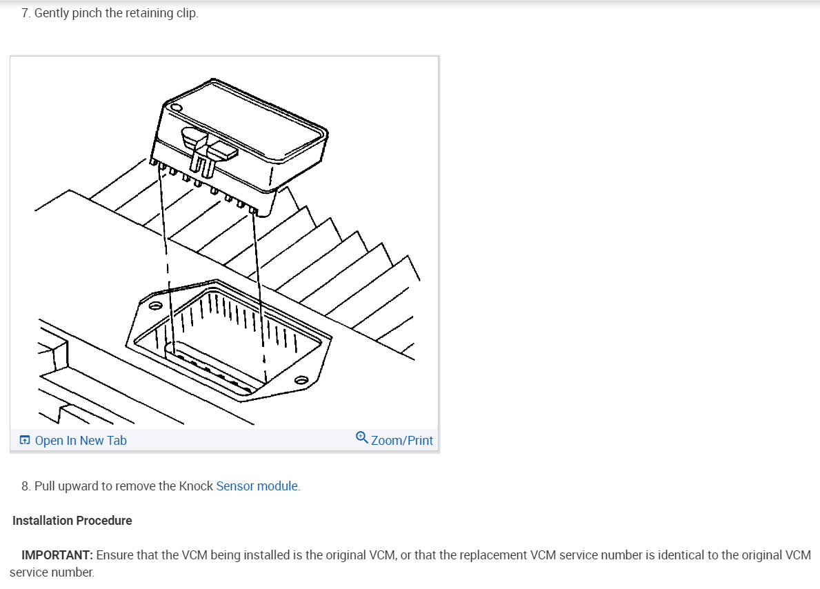

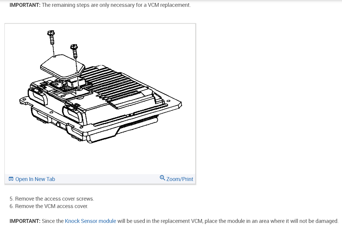

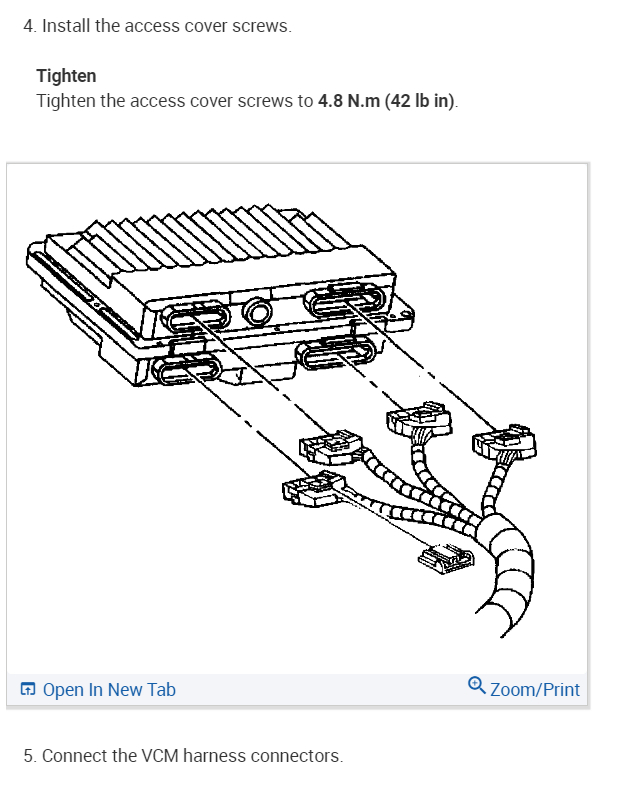

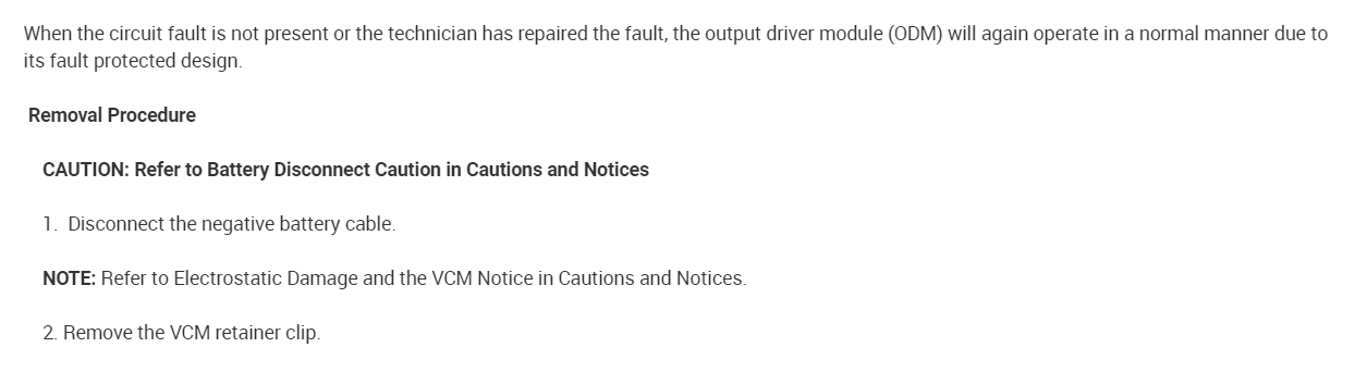

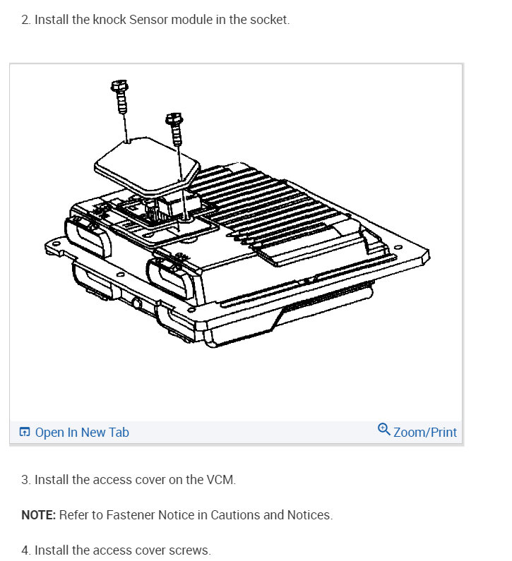

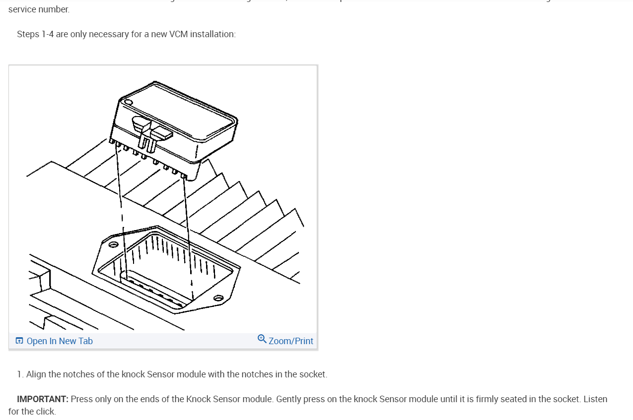

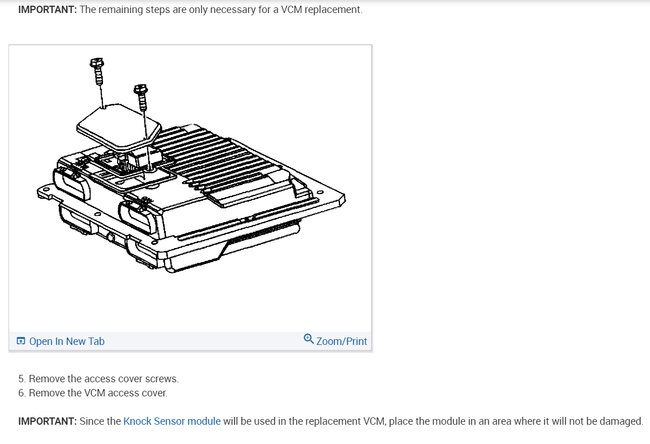

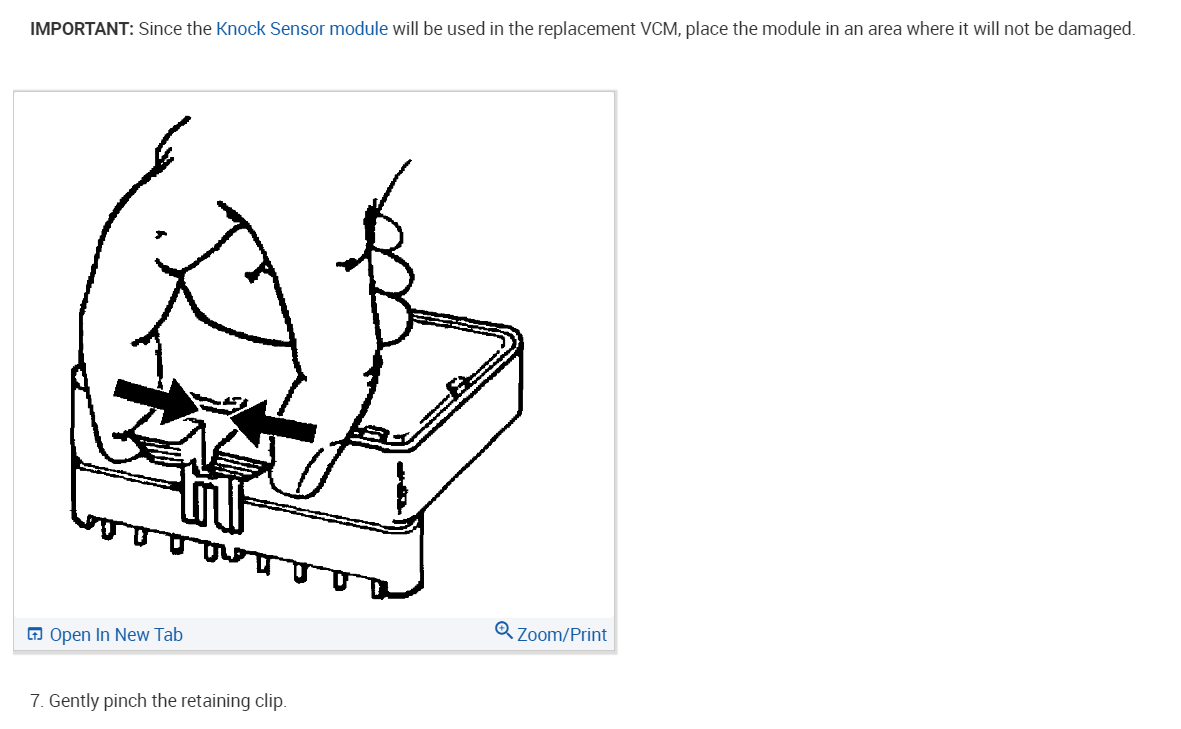

It sounds like the PCM is bad, if you are getting no pulse at the coil and the PCM is seeing RPM the ignition driver inside the PCM is bad. here is how to change the unit out or send it in for testing. You can get a preprogrammed unit by searching Google or Ebay. Check out the images (below). Please let us know what happens.
Sep 28, 2023 at 12:37 PM
It sound sliek the PCM is bad, if you are getting no pulse at the coil and the PCM is seeing RPM the ignition driver inside the PCM is bad, here is how to change the unit out or send it in for testing. You can get a preprogrammed unit by searching Google or Ebay.
