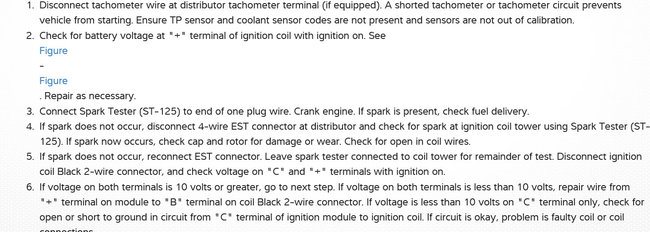

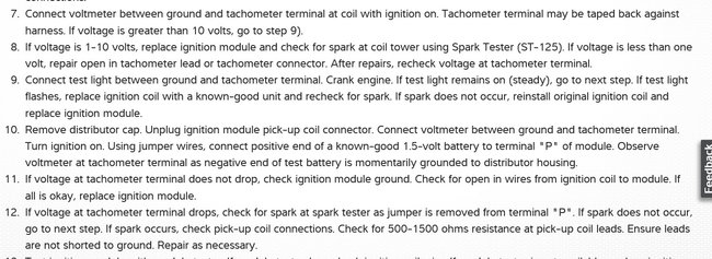

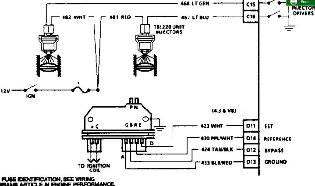

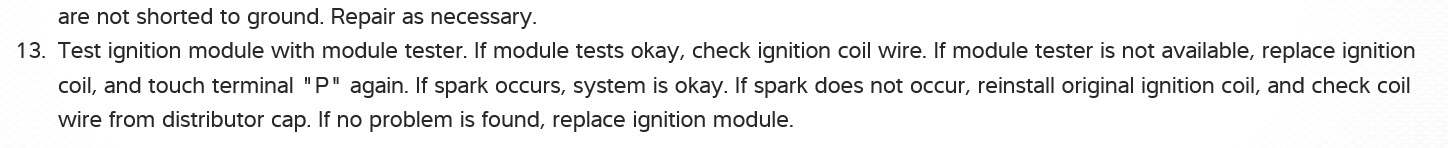

Hello, i bought a 1994 Chevy suburban k1500 with 5.7tbi. it has no spark, it has compression and fuel, but no spark. Can someone help me diagnose this issue? I have tried doing testing, but I'm not sure I'm doing it right, please help.
