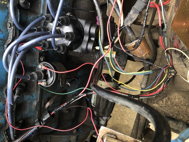

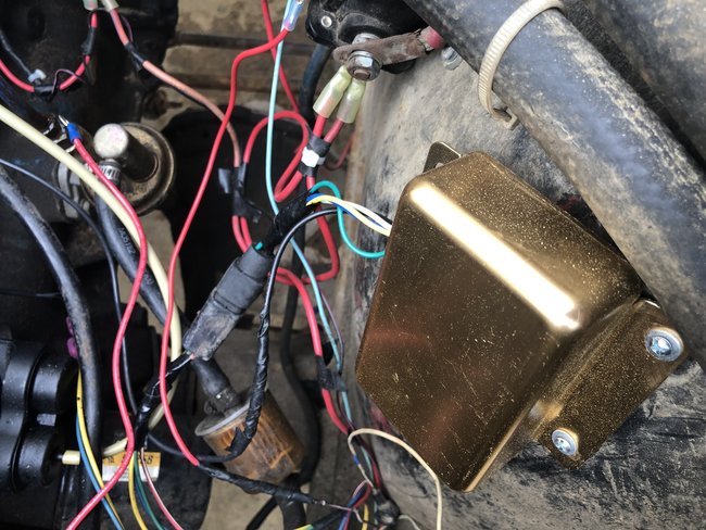

Maybe some nice pictures - overhead/ left/ right sides of Mr. Engine with hood back on the windshield and the breather removed. Sometimes things get changed in forty years time. Sometimes I can spot an issue!

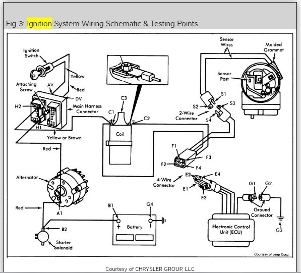

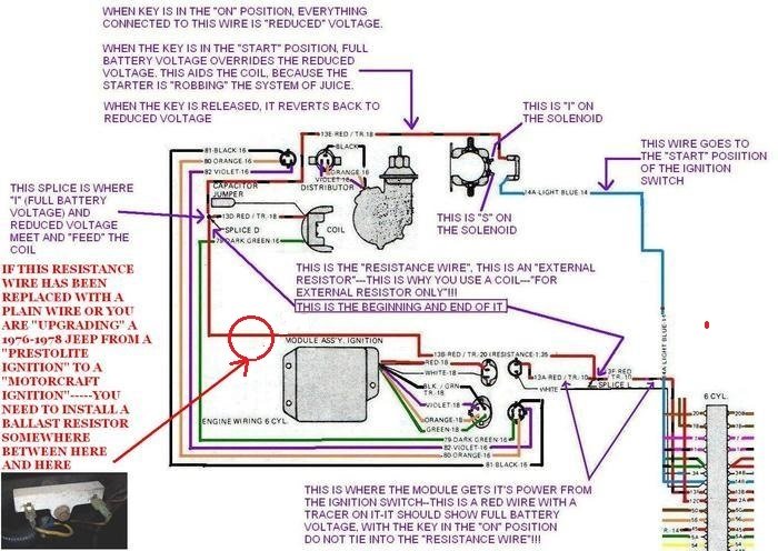

I found this diagram in "Prodemand", it may help you too.
Use a little dielectric grease on your connections.

That pic you uploaded appears to be the layout I am looking for. I am expecting the new, correct coil sometime Monday. I am out of town for work until Tuesday. I will verify all wiring and install the new coil when I get back.

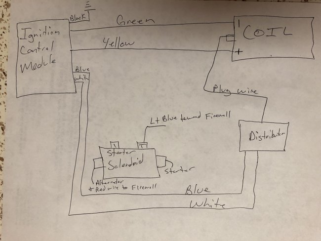

Meant to get back to you guys earlier in the week. Between work and personal stuff, I haven't had much time. I did get a chance to verify wiring last night. My ICM has four wires, blue, green, yellow, and white. These are terminated inside a four pronged plug. Two female and two male connections. On the vehicle side of the wiring, I have a similar plug, but with blue, green, yellow, and red with tracer. The diagram provided doesn't show a white. Should I assume that the white wire goes to the red with tracer wire? This is what I thought. However, on the side of the plug that goes into the ICM, the white corresponds with the yellow and the yellow with the red with tracer wire on the other end of the plug. Thoughts? The ICM did making a high-pitched sound after I connected everything. I immediately unplugged the connections to prevent damage.

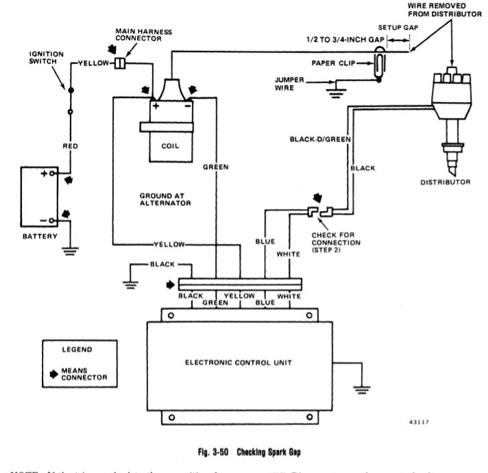

This one do you a little better?

That definitely helps! I just got back from a family trip (took the ball and chain to Florida for a concert last night). Told the wife I’m headed to the garage and to only bother me if the sun is coming up.
I ensured everything was connected as your picture shows I hooked on the paper clip and grounded it to the engine. I was able to get spark. I did the alligator clip from the starter solenoid to the positive side of the battery.
I’m charging the battery at the moment. Then I am going to test for spark from the distributor to the plug in cylinder one.
Oh yeah, tightened every screw and verified every mechanical connection involved with the ignition.

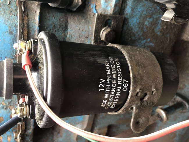

Alright. Everything checked out as far as wiring goes. However, Crown sent a “external resistor” coil. I called their customer service and they stated I required an external resistor coil. If my memory serves me correctly, I did have a resistor on there at one point. After speaking to the wife, she said she might have threw something similar to a resistor away when I re-did some of the wiring. Now, I have no idea where the resistor would go. Any help in that area? I uploaded some pictures too. I will be following up shortly with a current wiring diagram of what I have going on. I hope to get this resolved in the next two days because I have to go out of town for about thirty days or so.

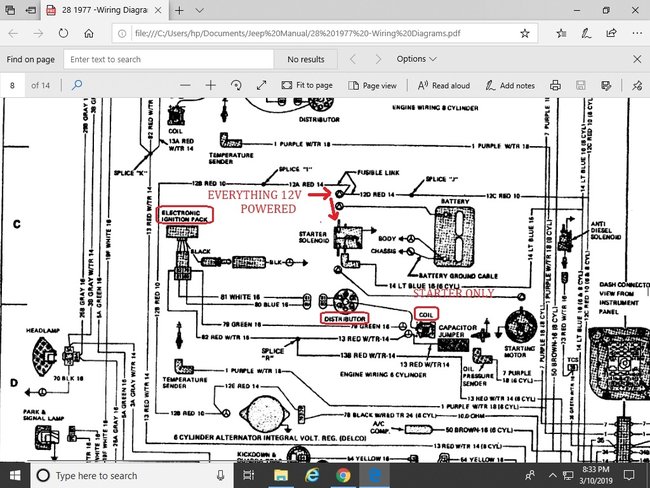

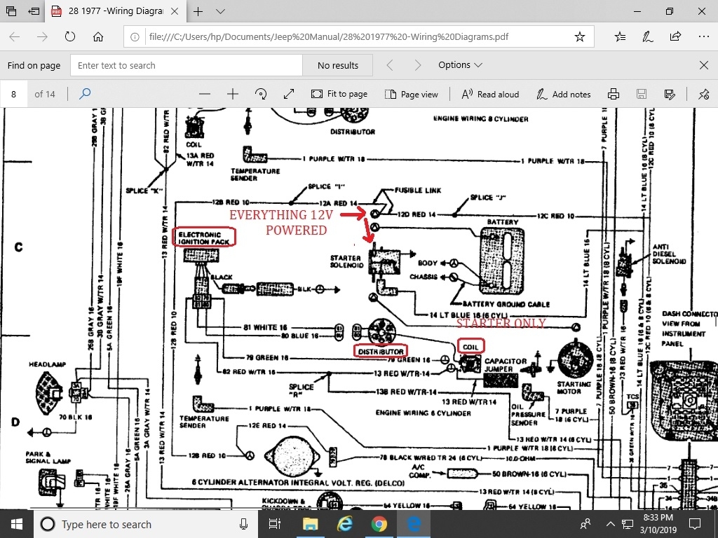

Current wiring. See anything wrong? Need a better picture? Where would the ballast resistor go? Between I and positive coil side?
Mar 10, 2019 at 5:16 PM
CJ MEDEVAC
  • 11,004 POSTS
Solenoid is right. (Drawn diagram)
If you have the correct coil, there is no ballast resistor at all ever 1976-1978!
There is no resistance wire for Prestolite.
There is a capacitor shown at the coil.

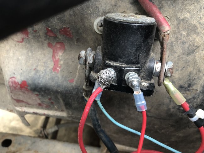

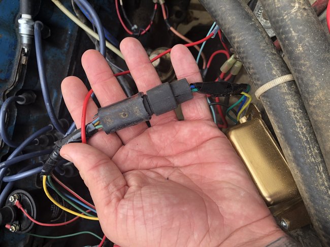

Your pictures
1) Is the connector all the way in or is the skirt crumbling off appearing like that?
2) Second red wire on "S" is a temporary way to crank?
3) Wrong coil, should have internal resistor (specific for your Jeep)
4)
5)
6) Nice Jeep!
When upgrading, it would be on the wire to the positive side of the coil. (Only reducing the coil) (Not before other wire intersections)
Yes, the connector is all the way in. I am not sure why it looks like that. I made it a point verify it.
Yes. I jumped from the "S" to the positive side of the battery. I was doing this when testing for spark by pulling a plug and grounding it. I should have taken that off before I took the picture
Can you reference a part number for me? I will go buy one today. Unfortunately, everywhere I am going to is giving me the external type.
4) Question was blank.
5) Question was blank.
6) Nice Jeep!
Thanks! The family and I really enjoy cruising in it.
When you say on the positive side of the coil. Is that from the ignition wire or from the ICM wire?

Positive (and negative) side of coil is marked on the top near the terminals.
Here's one:
https://www.autozone.com/ignition-tune-up-and-routine-maintenance/ignition-coil/spec-ignition-coil/883605_0_17367
Here's another:
https://www.autozone.com/ignition-tune-up-and-routine-maintenance/ignition-coil/duralast-ignition-coil/111849_576402_17367
Not meant for you! (Yet!)
When I upgrade, I use all of the ignition parts as a 1979 would have, this cuts down on mismatching/ confusing stuff during a later repair/ tune up.
Here's a diagram for upgrading to Motorcraft from a '76, '77, '78
Beings that those years did not have a "resistance wire" as does a '79 on up. The ballast resistor takes the place "that special wire"!
It's installed nearer to the coil on the wire that feeds the positive side of the coil (we don't want to reduce anything else back towards the firewall!)
Notice the ballast resistor feeds right to the "Tee" at the coil. "I" terminal feeds to the other side of that "Tee". The explanation on my diagram should explain how "I" helps while cranking.
