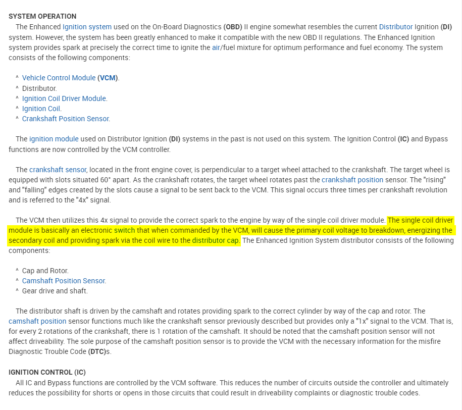

Take a look at this attachment let me know what you thing. Thanks
