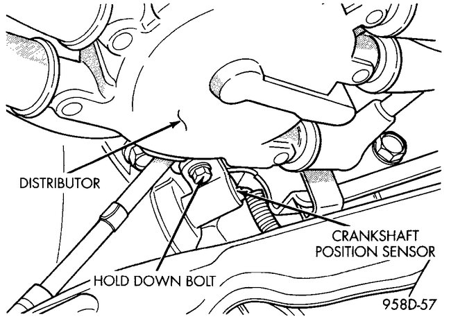

My first suspect is the crankshaft position sensor. If it came disconnected or has gone bad, you will lose spark. The easiest way to check it is by using a live data scanner and checking to see if there is an RPM signal when cranking.

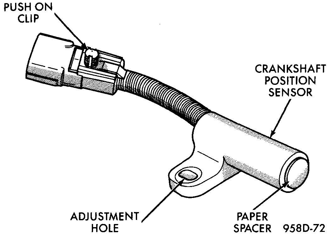

If you determine the sensor is bad, here are the directions for replacement specific to your vehicle. The attached pictures correlate with these directions.
_____________________
ROCEDURES
Fig. 9 Crankshaft Position Sensor
See Pic 1
REMOVAL
1. Remove speed control servo from driver's side strut tower.
2. Remove crankshaft position sensor retaining bolt Fig. 9.
3. Pull crankshaft position sensor straight up out of the trans-axle housing.
4. Disconnect crankshaft position sensor electrical connector from the wiring harness connector.
INSTALLATION - ADJUSTABLE
Some vehicles may be equipped with an adjustable crankshaft position sensor. This can be identified by an elongated mounting hole in the sensor.
Fig. 10 Crankshaft Position Sensor And Spacer
See pic 2
If the removed sensor is to be reinstalled, clean off the old spacer on the sensor face. A NEW SPACER must be attached to the sensor face before installation. If the sensor is being replaced, confirm that the paper spacer is attached to the face of the new sensor Fig. 10.
1. Install sensor in trans-axle and push sensor down until contact is made with the drive plate. While holding the sensor in this position, install and tighten the retaining bolt to 12 Nm (105 in lb) torque.
2. Connect crankshaft position sensor electrical connector to the wiring harness connector.
3. Attach connector to heater tube bracket.
4. Install speed control servo. Tighten nuts to 9 Nm (80 in lb) torque.
INSTALLATION - NON-ADJUSTABLE
1. Install sensor in trans-axle.
2. Install and tighten the retaining bolt to 12 Nm (105 in lb) torque.
3. Connect crankshaft position sensor electrical connector to the wiring harness connector.
4. Attach connector to heater tube bracket.
5. Install speed control servo. Tighten nuts to 9 Nm (80 in lb) torque.
Let me know if this helps. Also, this engine does have a timing belt. When cranking to start, does it sound normal, like it is turning faster than normal, uneven?

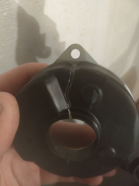

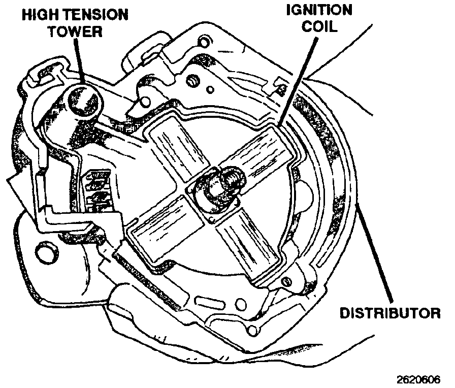

What is this black part under the rotor of the distributor? It is cracked all the way to the middle bolt that holds it in place.
Dec 5, 2018 at 6:22 PM

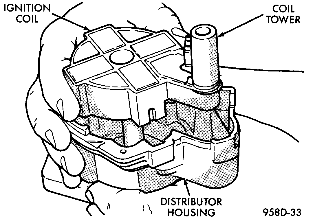

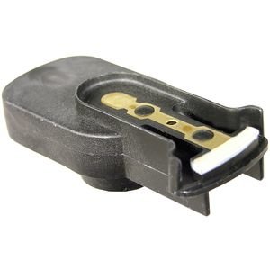

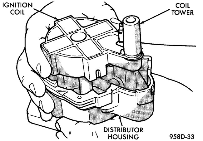

Looking from the side, I cannot tell what is cracked. I attached a picture of an ignition rotor and two of the components in the distributor. Let me know if you can identify the part with these pictures.
Dec 5, 2018 at 6:42 PM

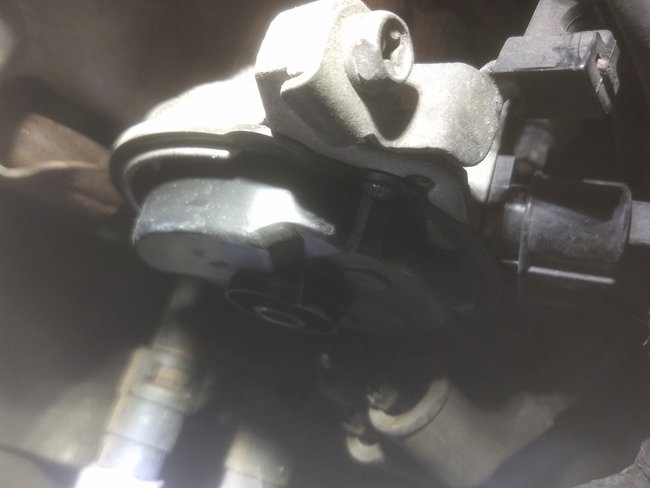

This? It goes cap, rotor than this to cover coil?
Dec 6, 2018 at 2:06 AM
That appears to be nothing more than a dust cover or insulator to prevent arcing within the distributor.

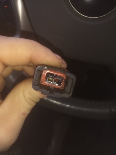

So we took apart distributor got to ignition coil and the adapter plug-in to plug into the coil was completely shot.
Dec 7, 2018 at 7:44 AM
ANGIE WRIGHT
  • 10 POSTS
Here it is:
