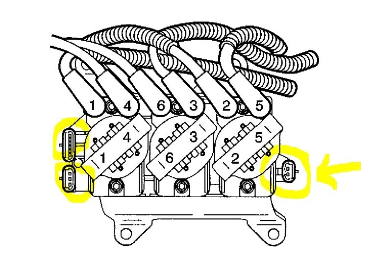

Good evening,
There are three connectors to the ignition module.
Double check the connections. One is from the engine harness and is tough to find.
The one with the arrow in the picture is the common one to forget.
