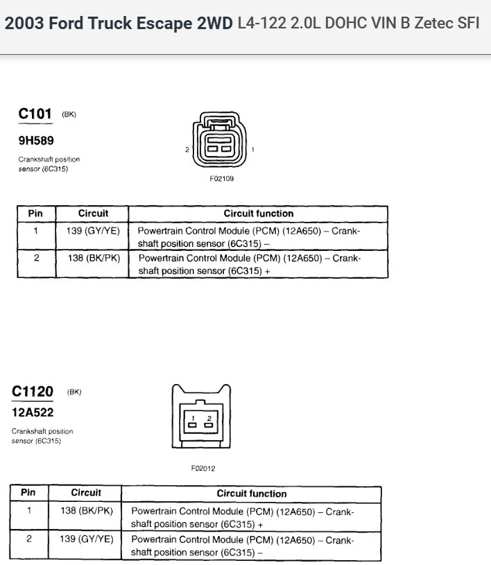

My brother just got this motor was locked up and I swapped the motor I had to fix some wires to the crank sensor. It is a 2003 ford escape 2.0l I'm looking for ecu pin point wiring diagram

Apparently there are two different electrical connectors, here is the connector view for both to help you get your car running again. Check out the images (below). Let us know if you need anything else.
