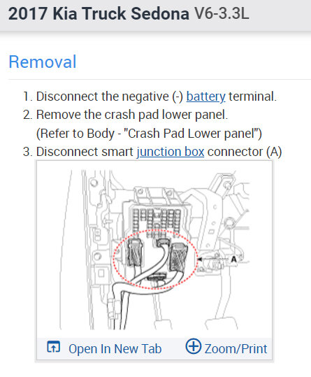

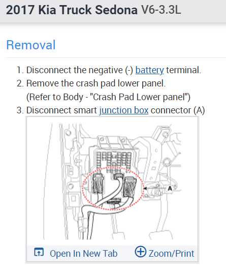

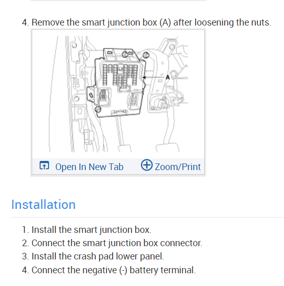

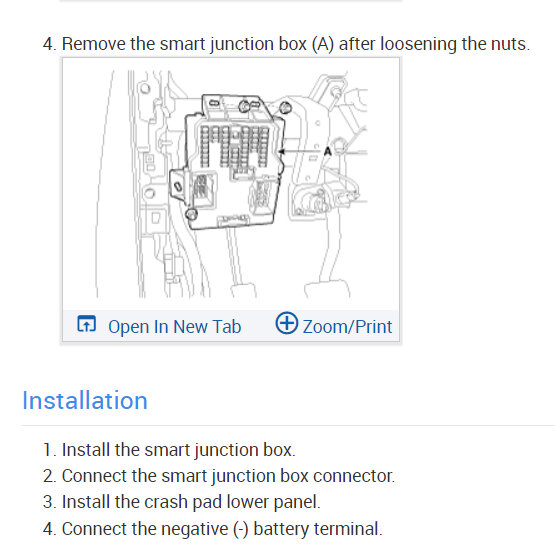

So, the blinker noise comes from the radio speakers, can I ask if the radio is working okay? If it is there is a microprocessor inside the instrument cluster that can go bad and not give the signal to the radio. Do you notice anything strange with the instrument cluster? The signal also goes through the ISP control module inside the smart junction box which can go bad as well, if nothing noticeable is wrong we should do a CAN scan. You can get a CAN scanner (Controller Area Network) which will work on most cars from Amazon.
Here is a video to show you how:
https://youtu.be/u-4syLc-ifQ
This way we can make sure we replace the correct part without guessing. Please go over these guides and get back to us.
