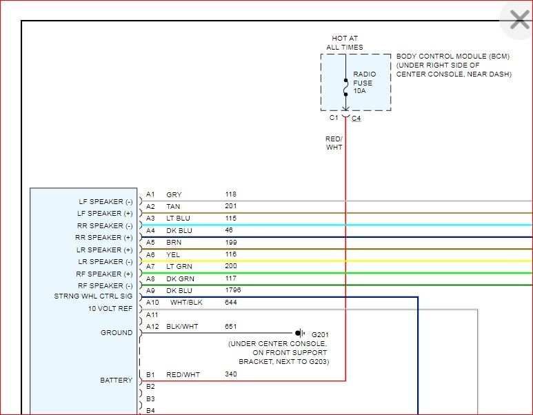

Hi Jayceon,
More then likely the power, ground, or the radio itself is the issue. In the attachment you will see a ground called G201. The location is on the diagram as well. The speakers themselves are just two audio wires so they are not the issue. You need to check for 12 volts at the B1 connector of the radio. If you have power going into the radio and ground on the G201 then the issue is most likely the radio itself. Otherwise it is wiring.
Here are some resources that can help with this type of diagnosis:
Let me know if you need more info and I will be happy to assist. Thanks
