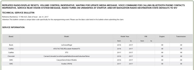

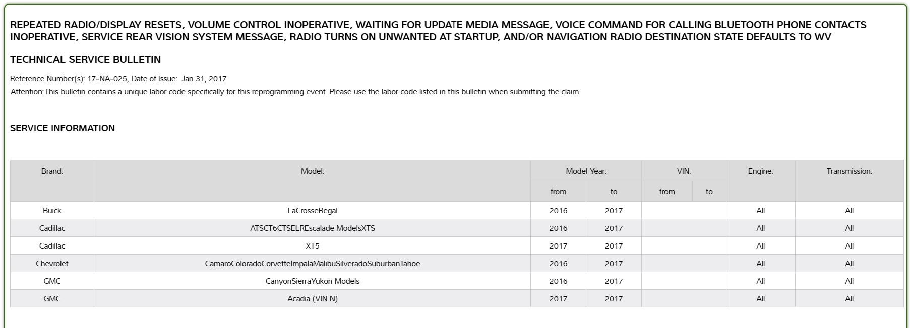

So, this is known issue by GM and affects many models.
There is a Technical Service Bulletin (TSB) on this issue.
Reference number(s) 17-NA-025 Issued: Jan 31st, 2017.

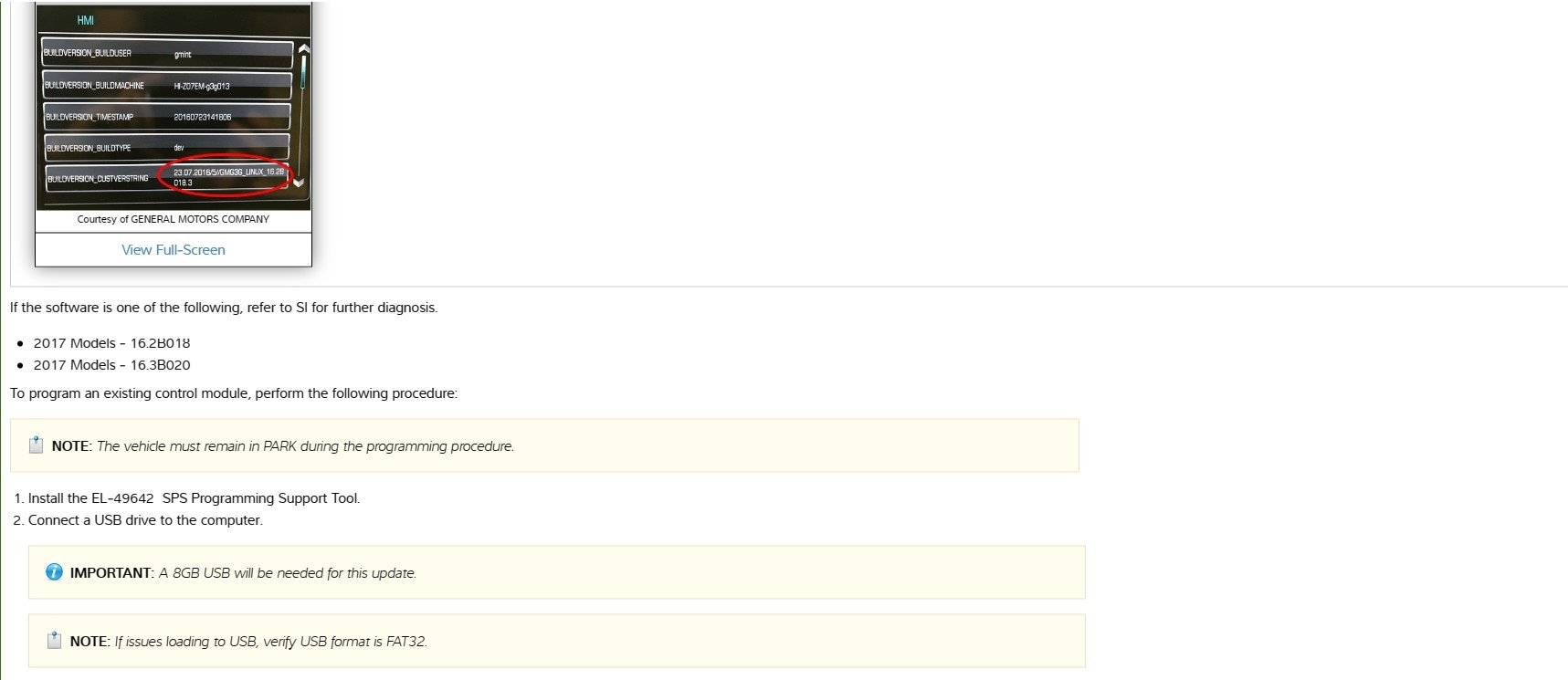

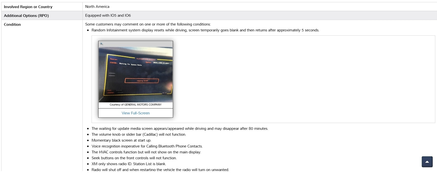

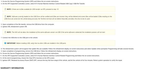

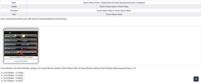

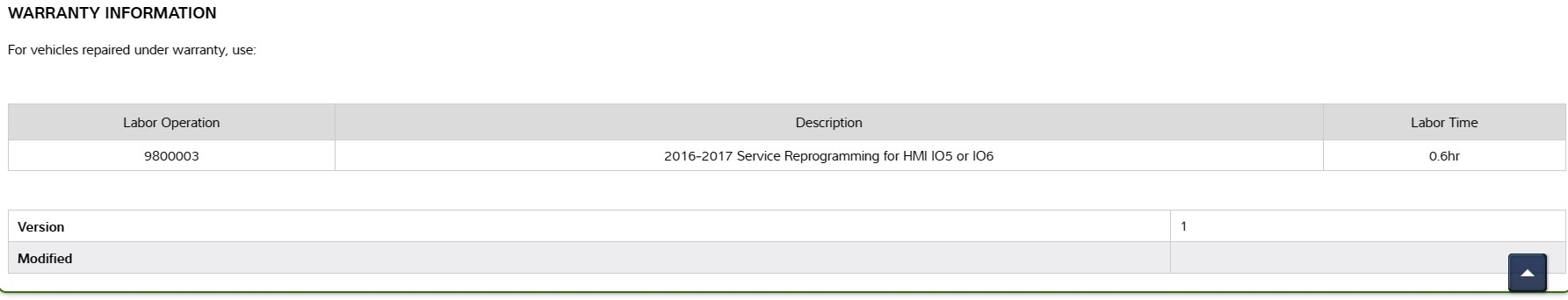

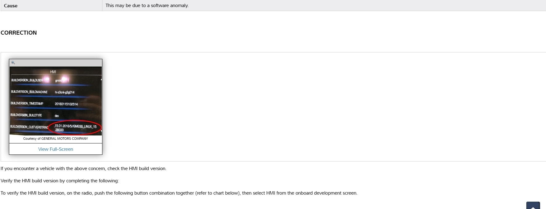

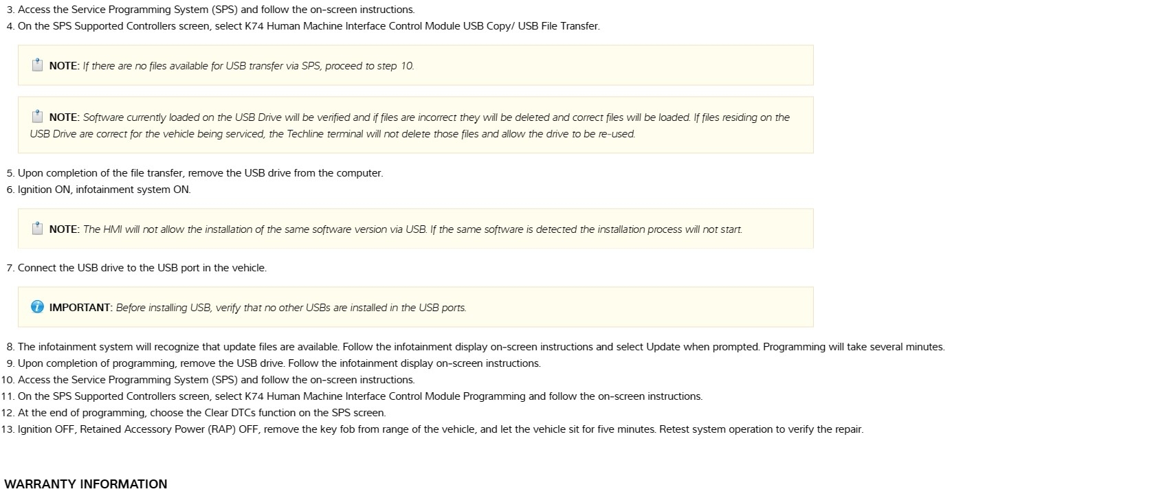

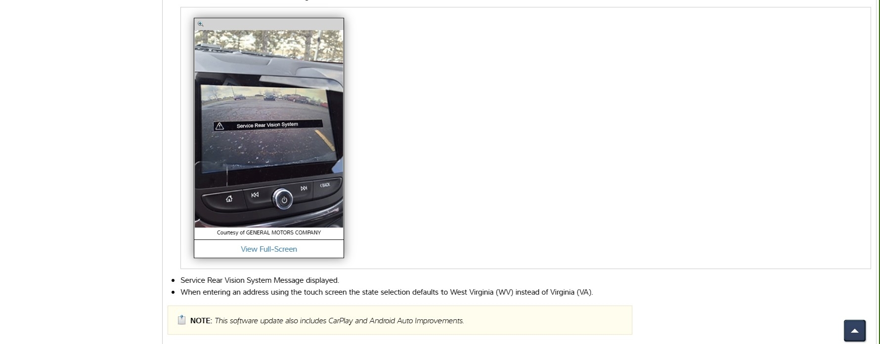

I will add a few screen shots for you of the TSB.
GM says it may be happening due to a software abnormality. This requires the service department of a local GM dealer to perform a reprogram of the unit with updated software. Should take about 30 minutes to an hour to complete.
The dealer is the only one who can update the software.
I would call the dealer and make an appointment; you will need your VIN so have it handy.
Then print out the information I sent you and physically hand it to them so there are no miscommunications as dealers tend to have these issues.
GM only pays dealers 0.6 hrs. to perform this update. So, you shouldn't be there to long.
