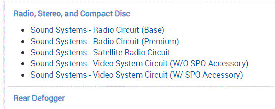

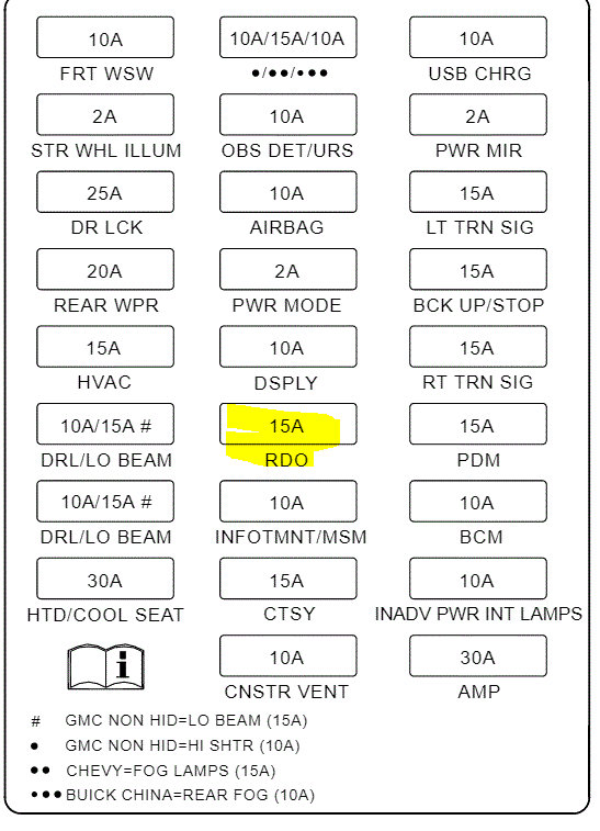

I don't know which radio is in the vehicle, so I attached the options for this vehicle in pic 1. Pic 2 shows the fuse location for the basic radio. I will have to confirm that for other options if it is different than the basic radio.
Check the fuse to see if it is good. If it is, also check to see if there is power to and from it.
Let me know what you find and which radio you have.
