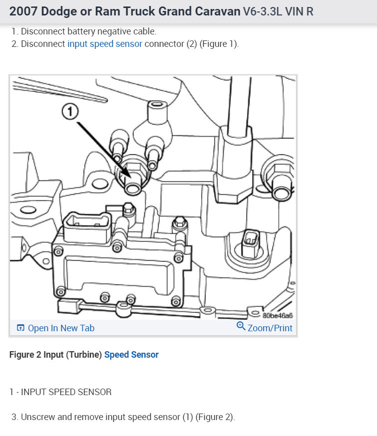

I have seen the input shaft speed sensor cause this issue and sometimes cause a code. here is a guide to help you retrieve the codes and the sensor location so you can check it out:

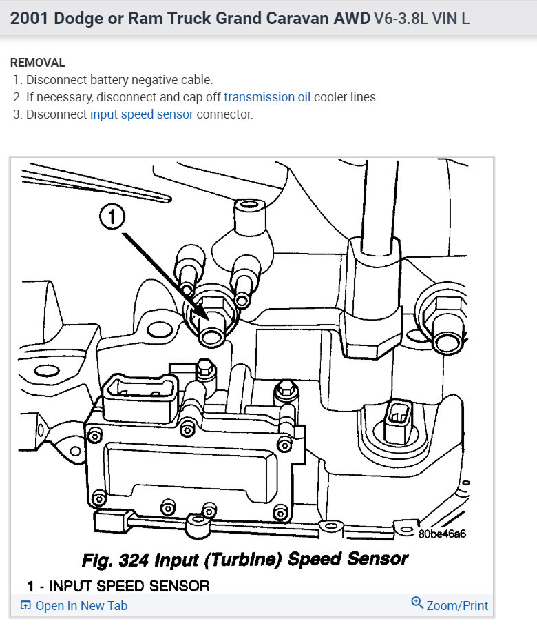

I have seen the input shaft speed sensor cause this issue here is the location so you can check it out. Check out the diagrams (Below). Please let us know what you find.

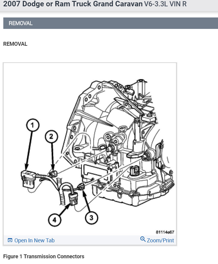

here are the sensor locations
https://www.2carpros.com/forum/automotive_pictures/99387_Graphic1_150.jpg
