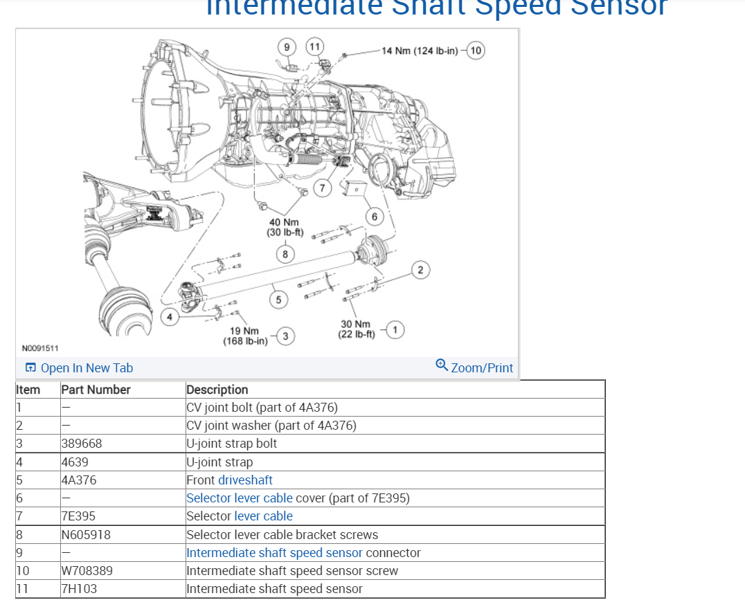

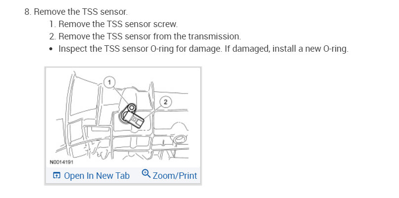

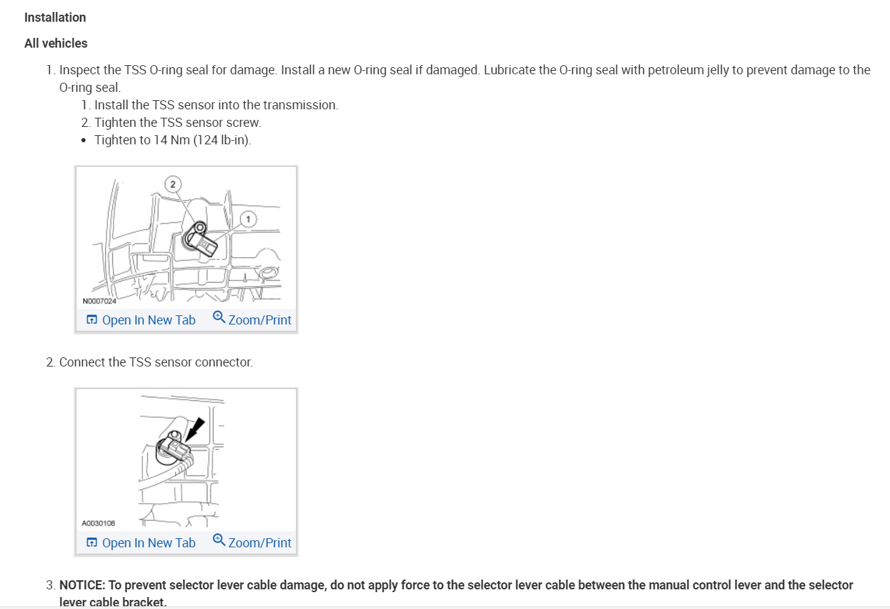

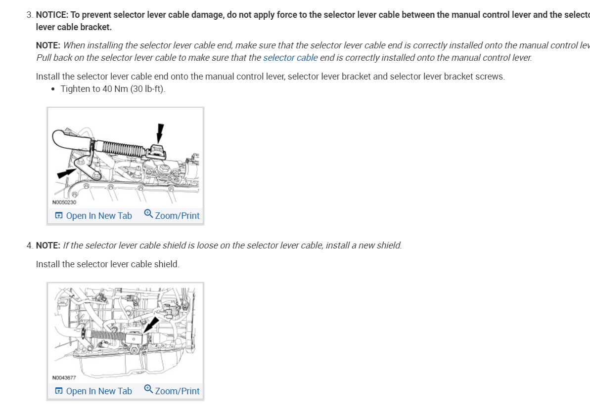

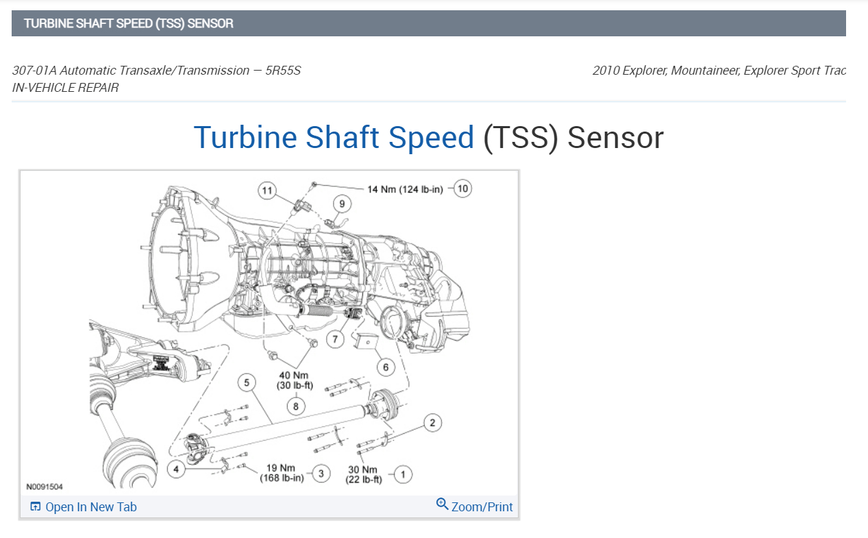

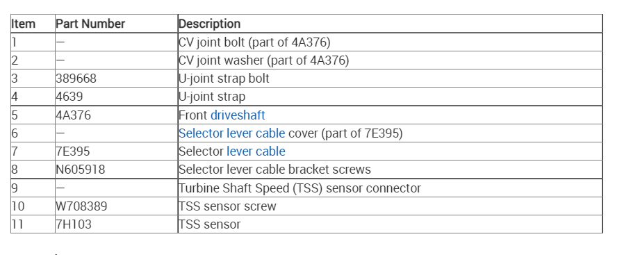

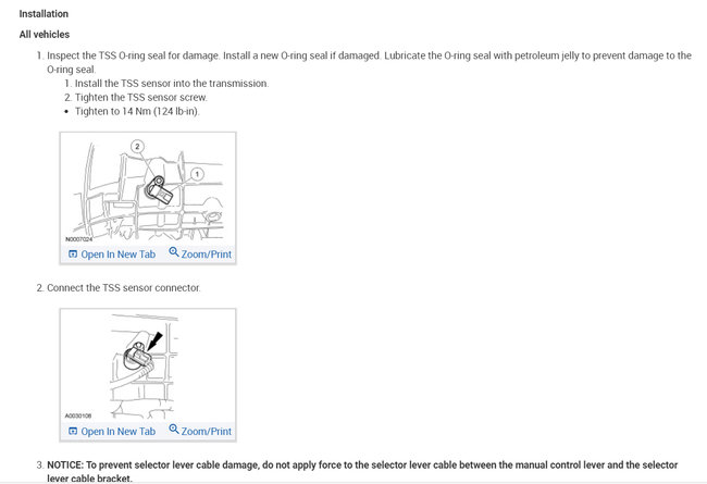

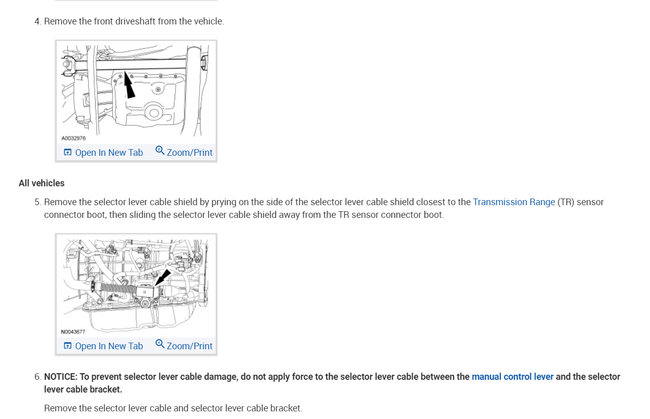

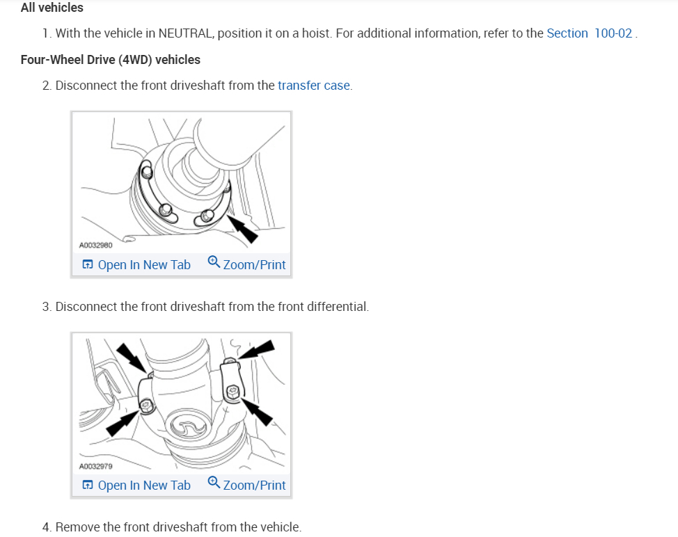

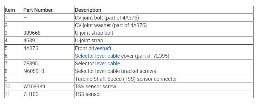

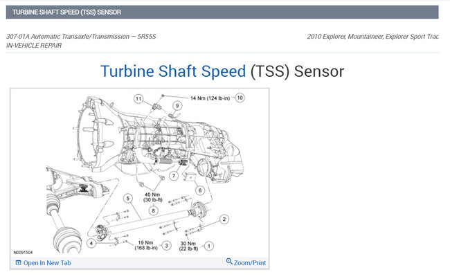

Running it low on fluid may have made the reverse clutches burn up. There are two shaft speed sensors which may not through a code when they are bad, turbine and intermediate. Here are the locations in case you want to try changing them out. Also, you may want to drop the pan and install a new filter and fluid to see if that helps. Here is a guide to help walk you through the service:
Jul 17, 2022 at 10:30 AM
