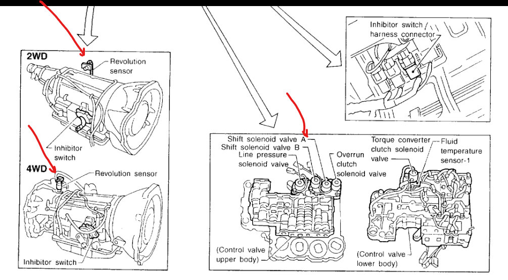

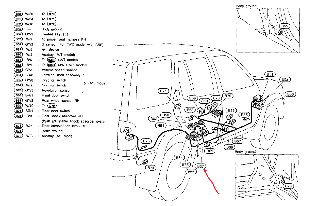

You could have knocked out the first gear shift solenoid or the revolution sensor. we should run the codes to see what comes up. here is a guide to help:
Here is the location of the shift solenoid and the revolution sensor in case you need it. Check out the images (below). Let us know what happens and please upload pictures or videos of the problem.
