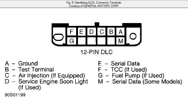

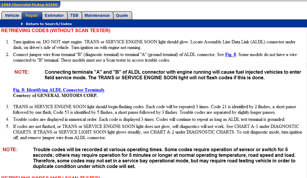

It is good to check the ATF fluid level,selector lever adjustment cable.
to narrow the issue problem read the fault codes,check fig 1 and fig 2 describes how to read fault codes.
here is our guide for transmission problems:
https://www.2carpros.com/articles/automatic-transmission-problems
Please sends us the fault codes for proper diagnosis.
