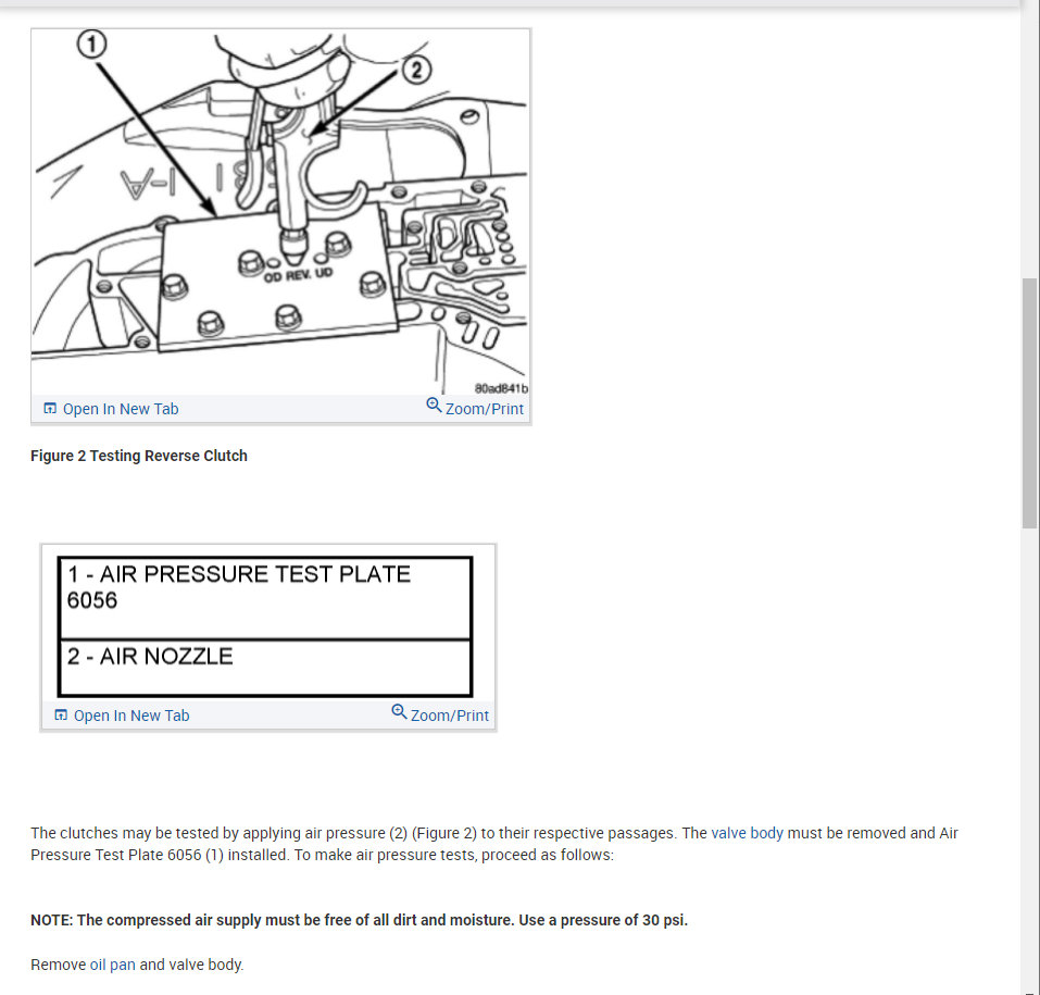

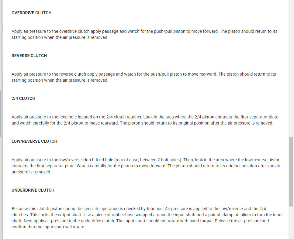

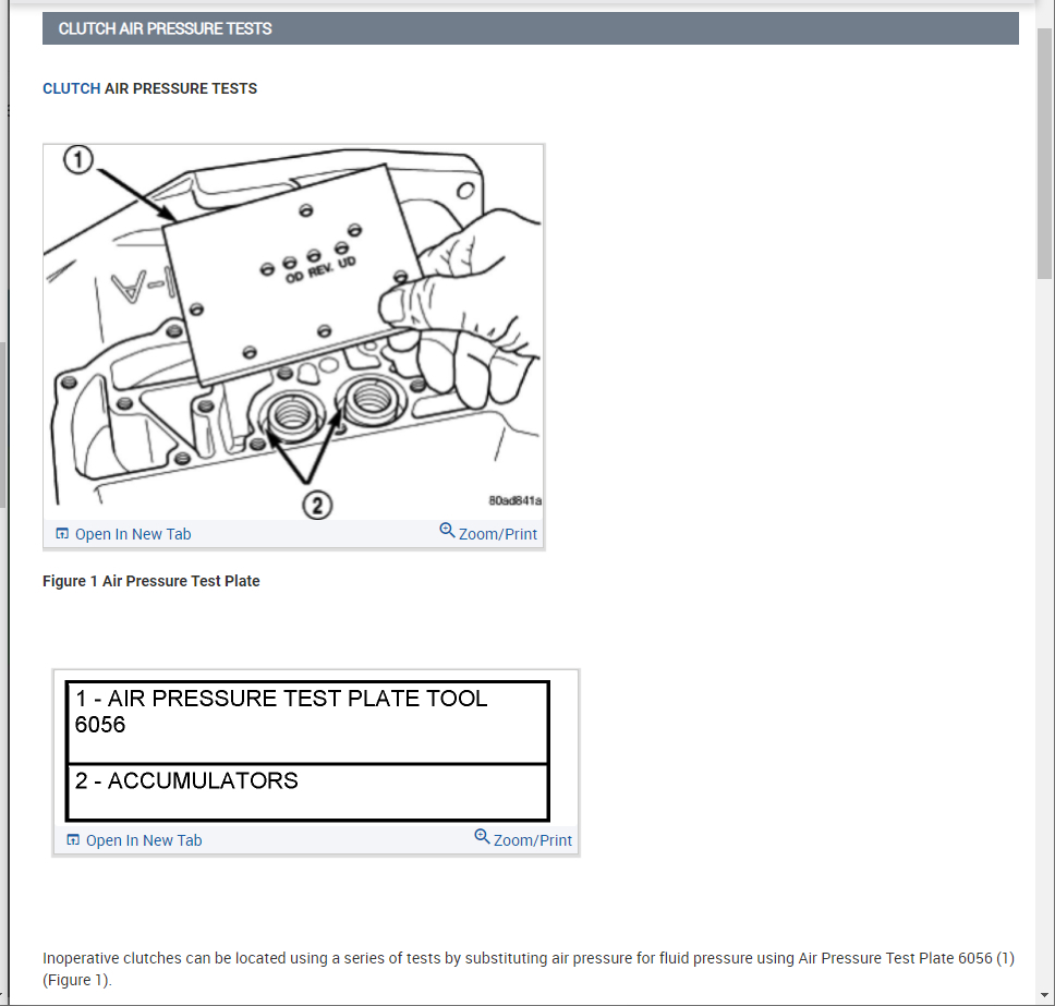

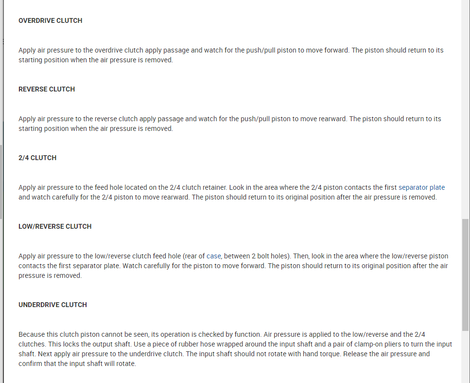

To confirm this is all that is needed, we need to do what is called an air check. This requires the valve body to be removed and then apply air to the channels and make sure the clutches clunk and that proves the seals are okay.
