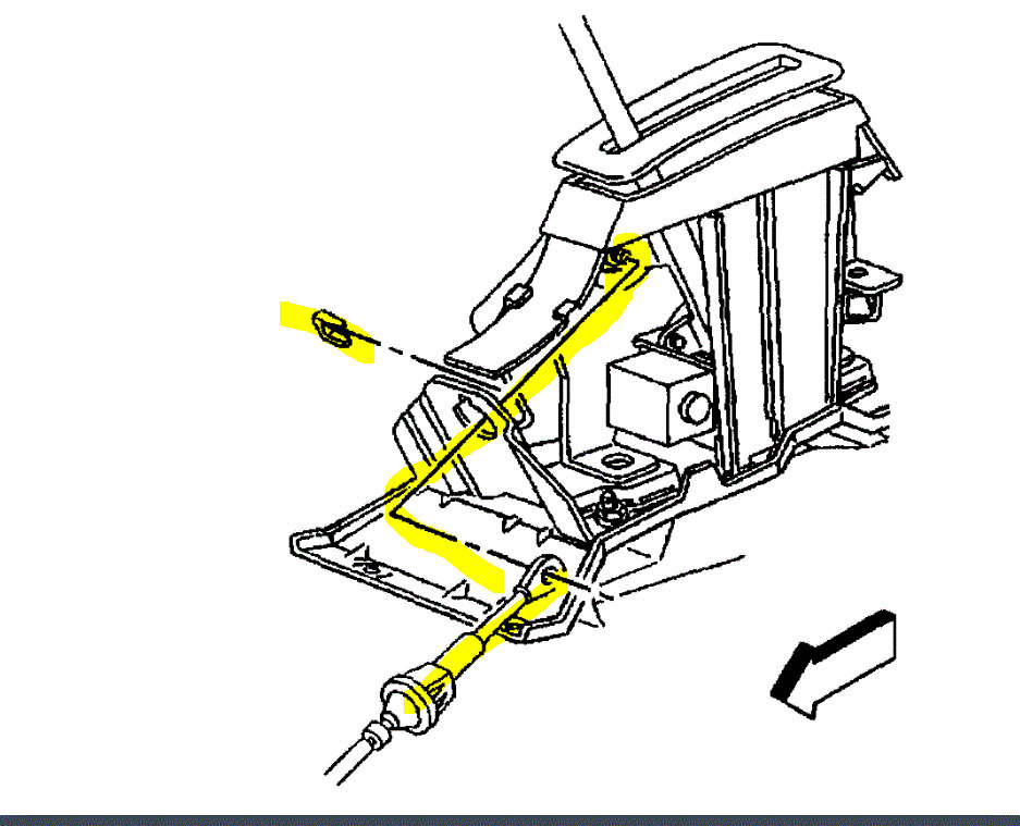

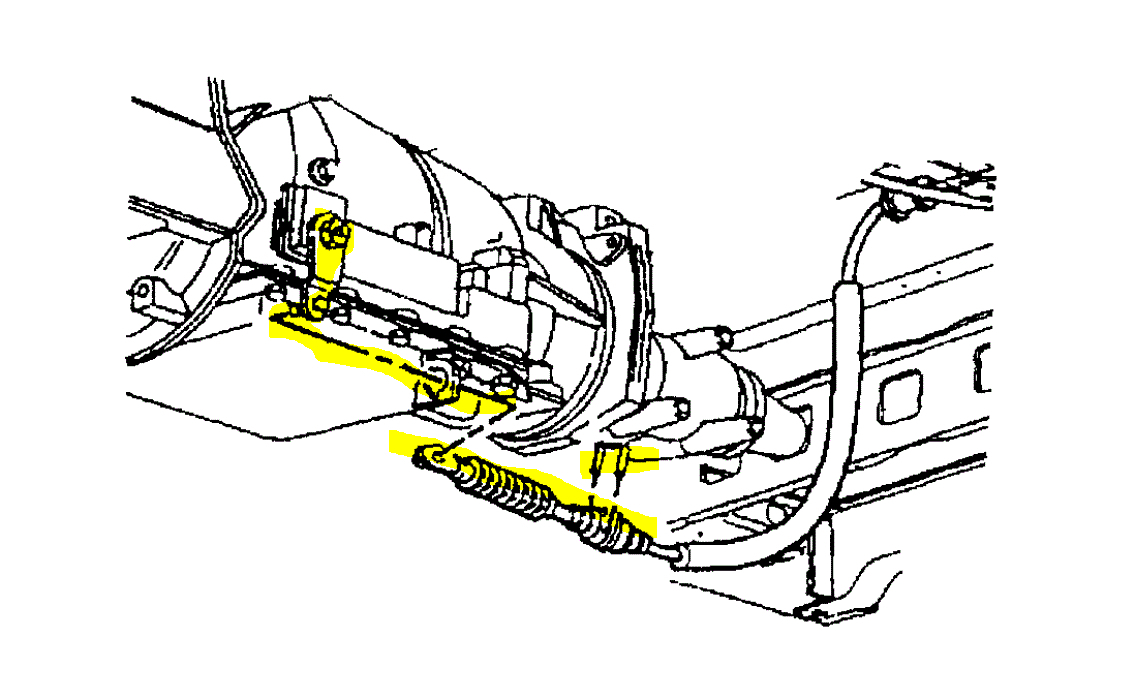

If the fluid is clean and full, first confirm that the shift cable is moving the shift lever on the transmission properly. See pics 1 and 2 for cable connection location.

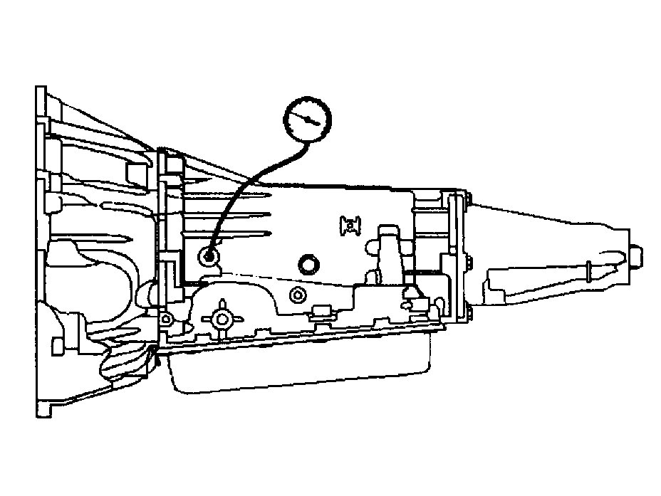

If there are no codes and the fluid is clean and full, the next thing would be to check line pressure. Here are directions for checking:
2000 Chevy Truck S10/T10 P/U 4WD V6-4.3L VIN W
Line Pressure Check
Vehicle Transmission and Drivetrain Automatic Transmission/Transaxle Testing and Inspection Component Tests and General Diagnostics 4L60-E/4L65-E Automatic Transmission Line Pressure Check
LINE PRESSURE CHECK
pic 3

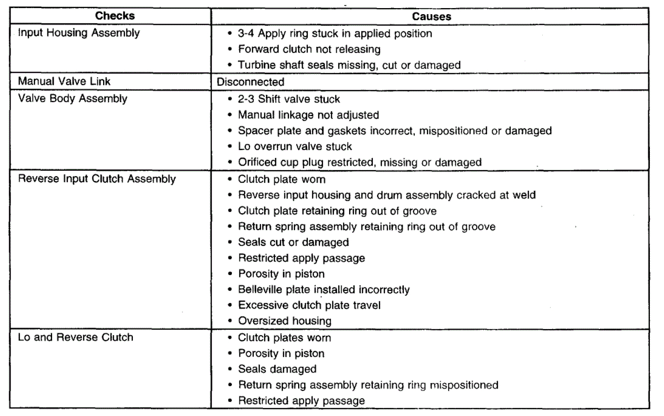

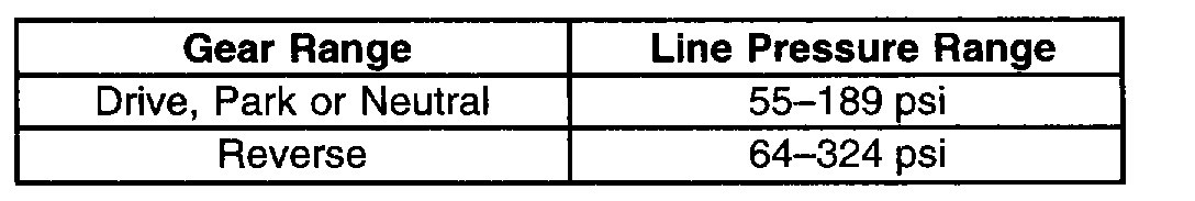

Line pressures are calibrated for two sets of gear ranges-Drive-Park-Neutral and Reverse. This allows the transmission line pressure to be appropriate for different pressure needs in different gear ranges:
pic 4

^ Install or connect the oil pressure gauge at the line pressure tap.

Refer to the Line Pressure table. The pressures in the table assume an engine speed of 1500 RPM and a temperature of 66°C (150°F). The pressure will vary with a change in temperature.
