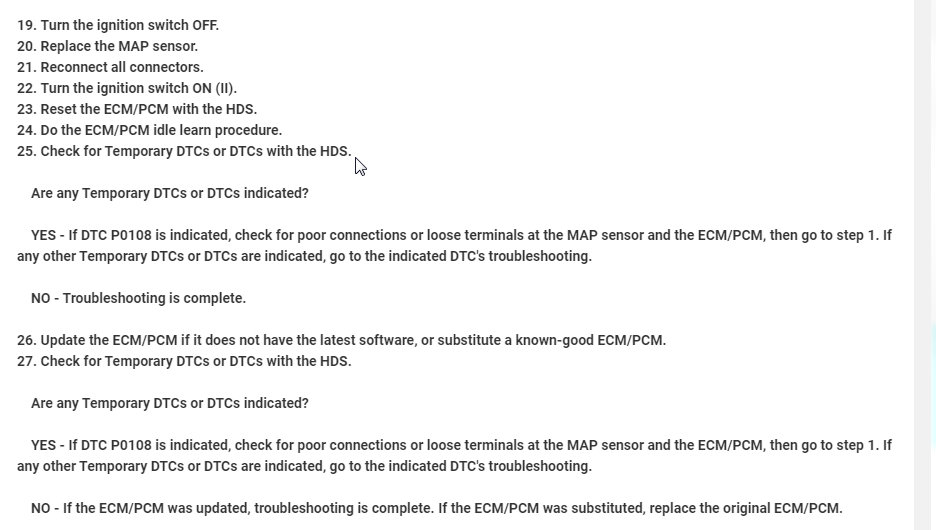

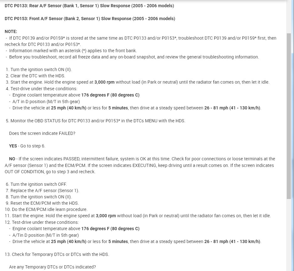

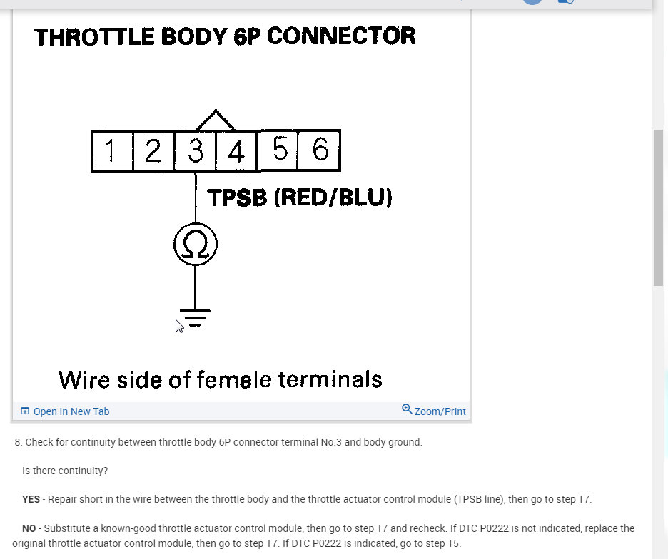

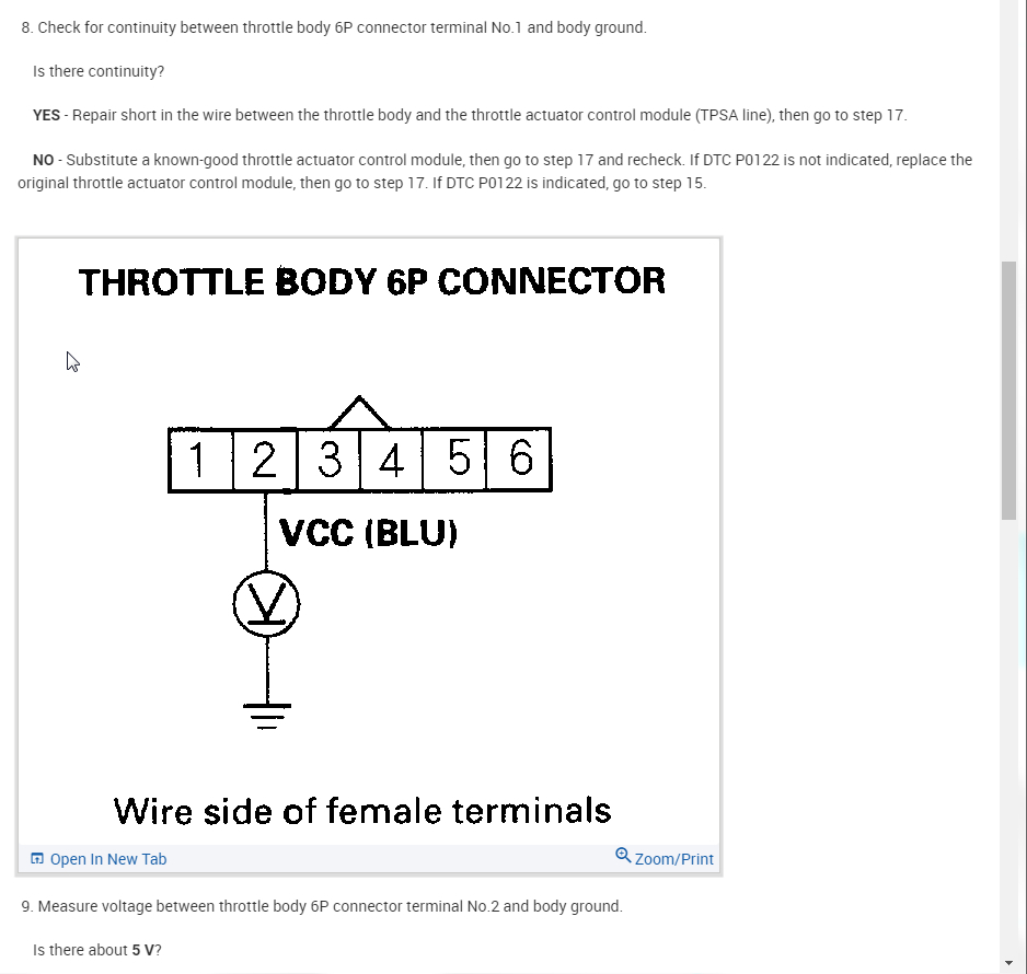

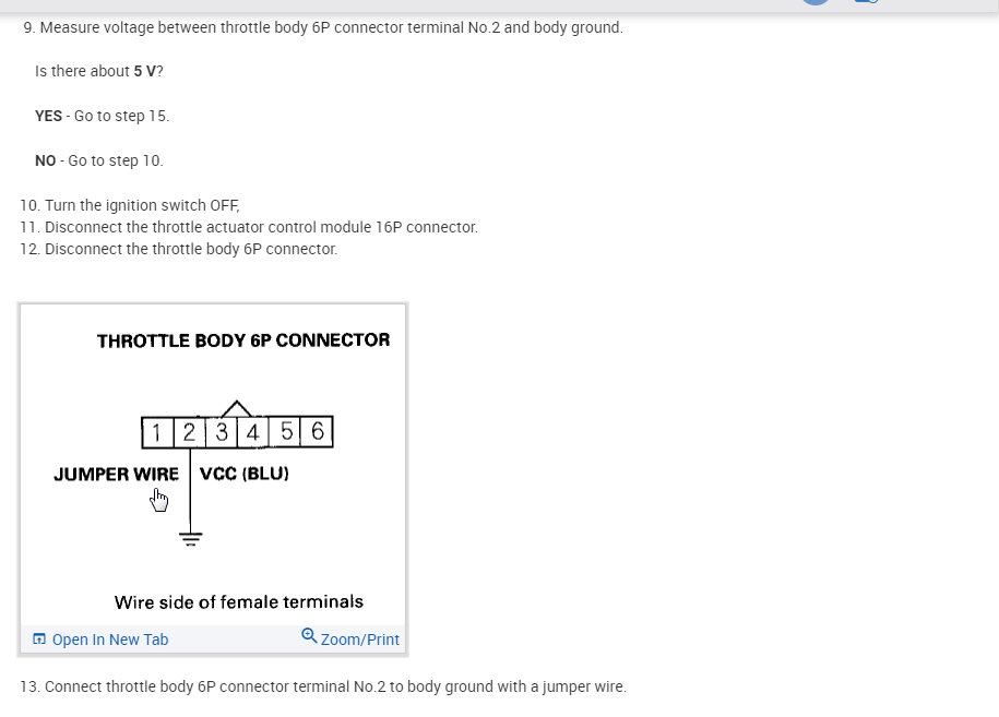

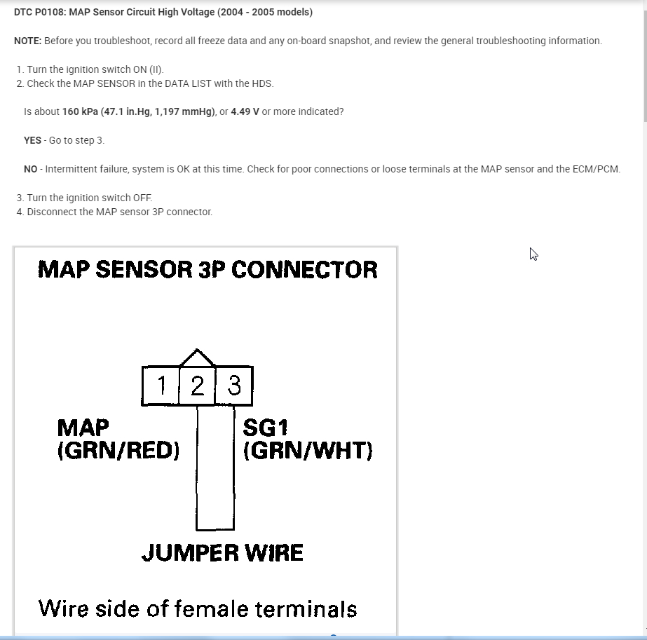

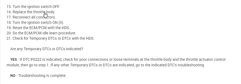

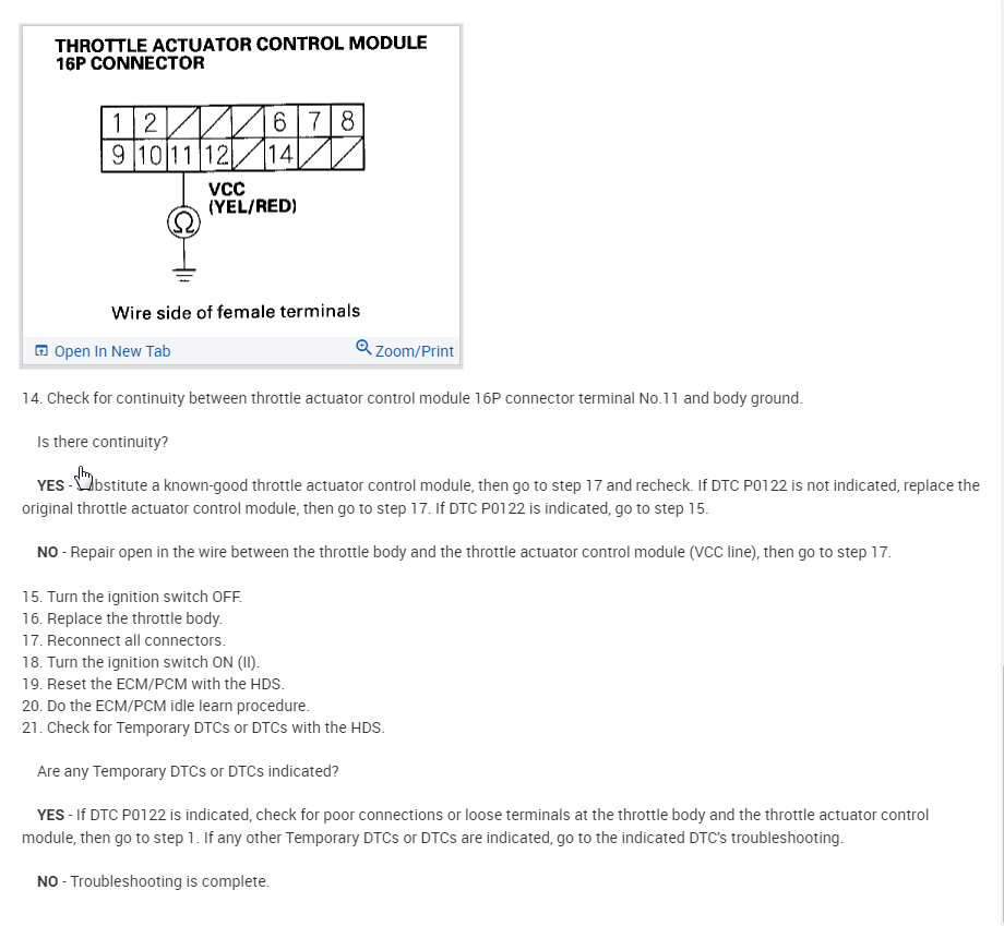

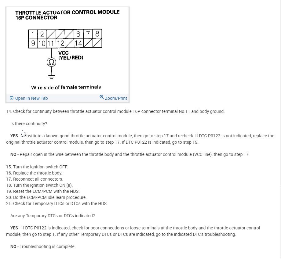

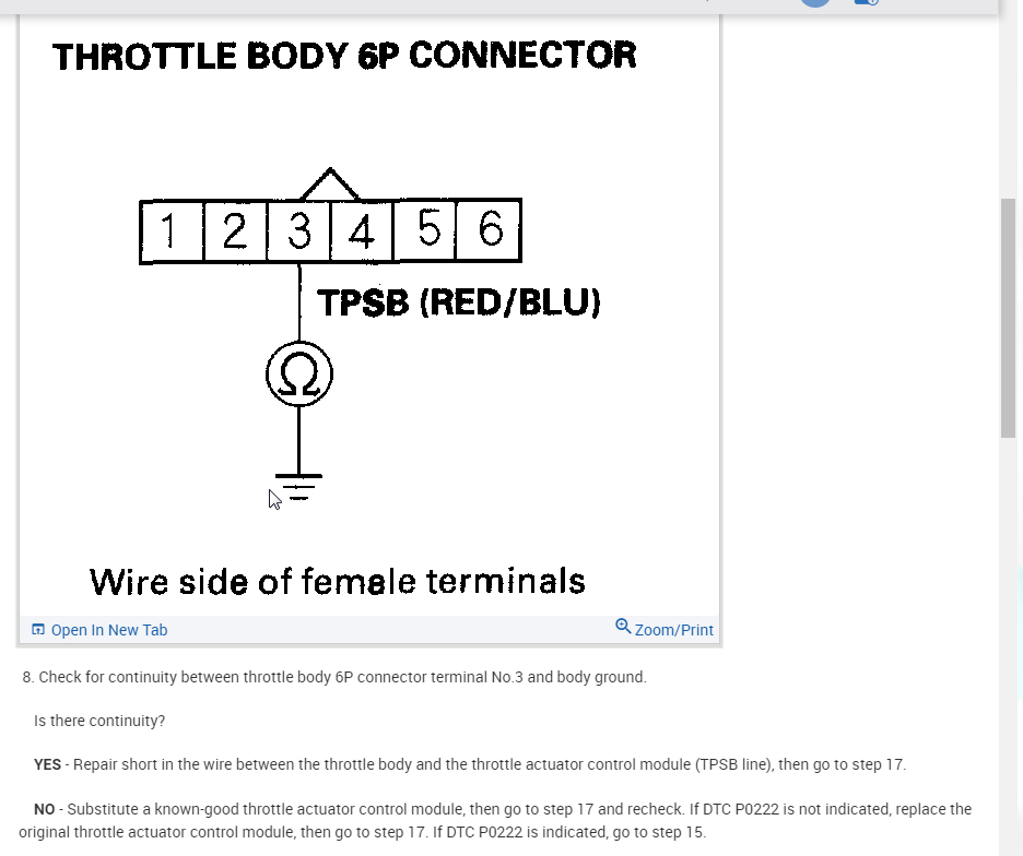

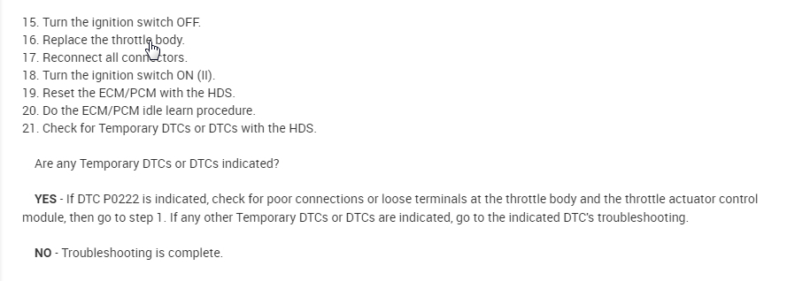

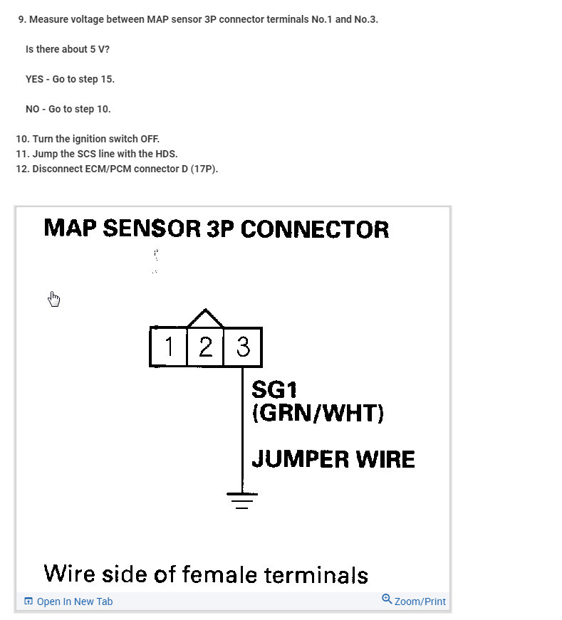

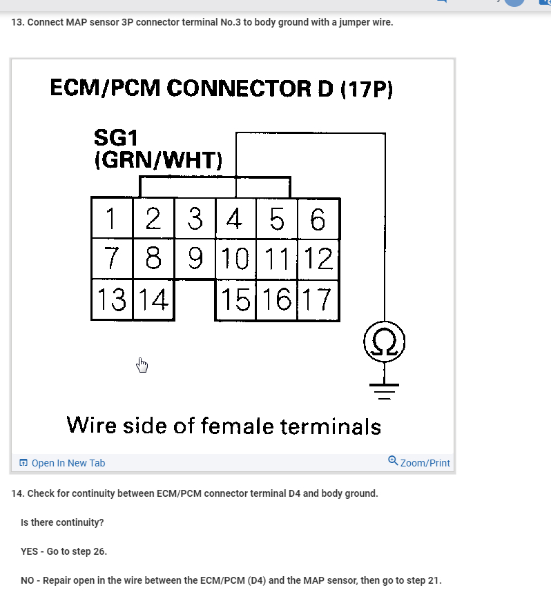

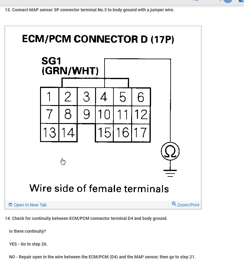

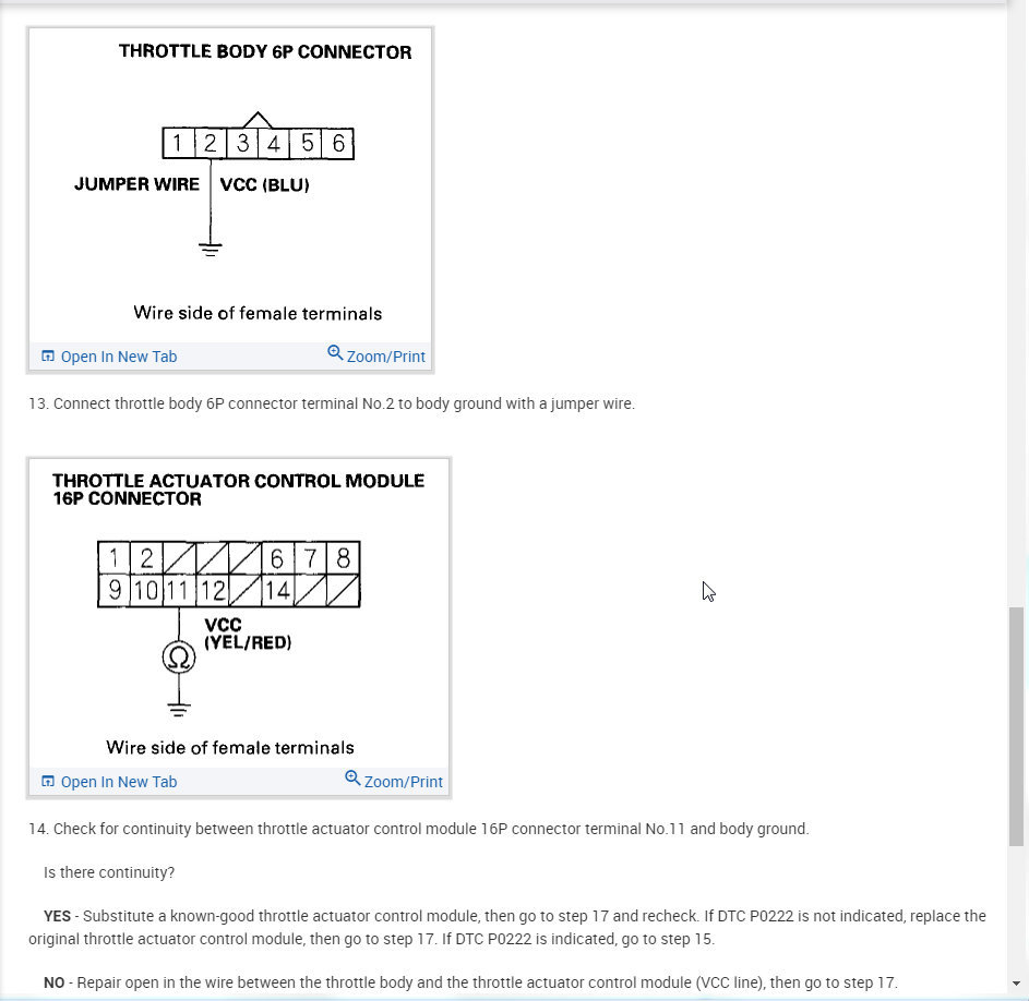

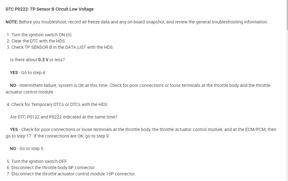

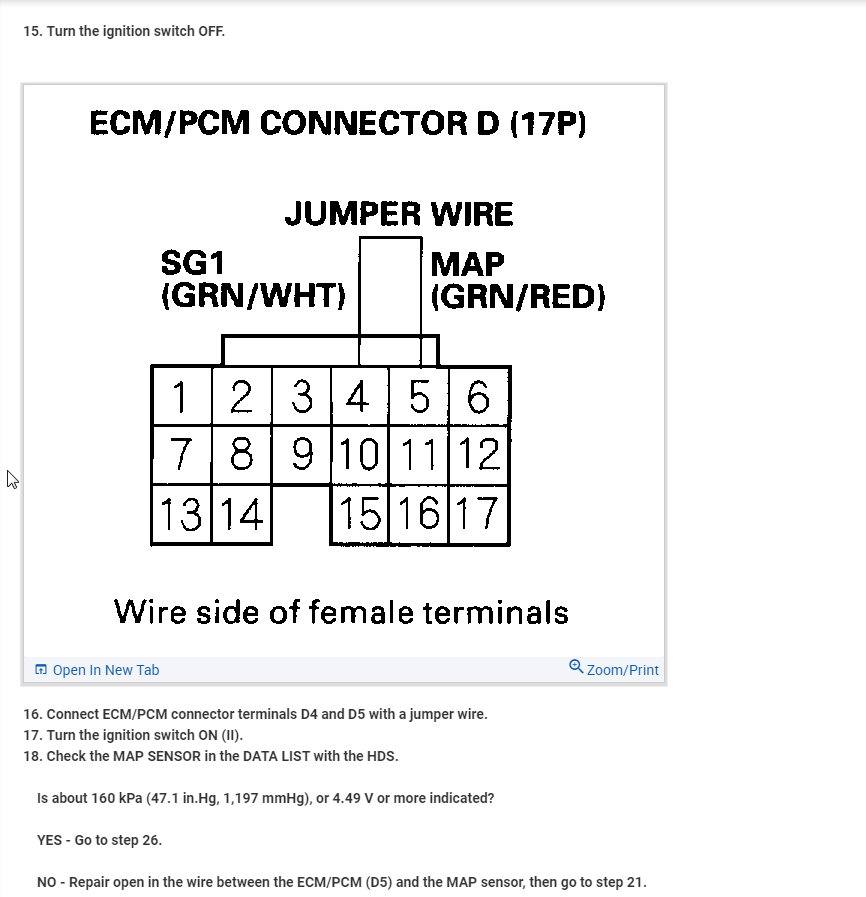

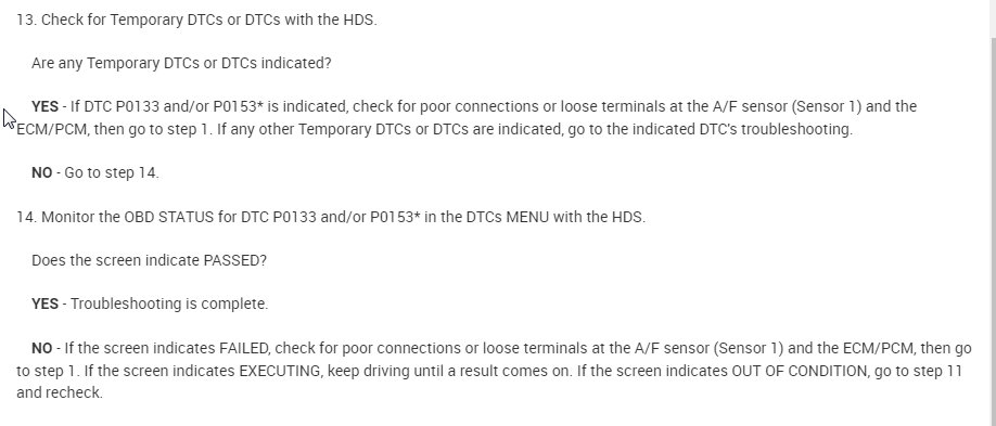

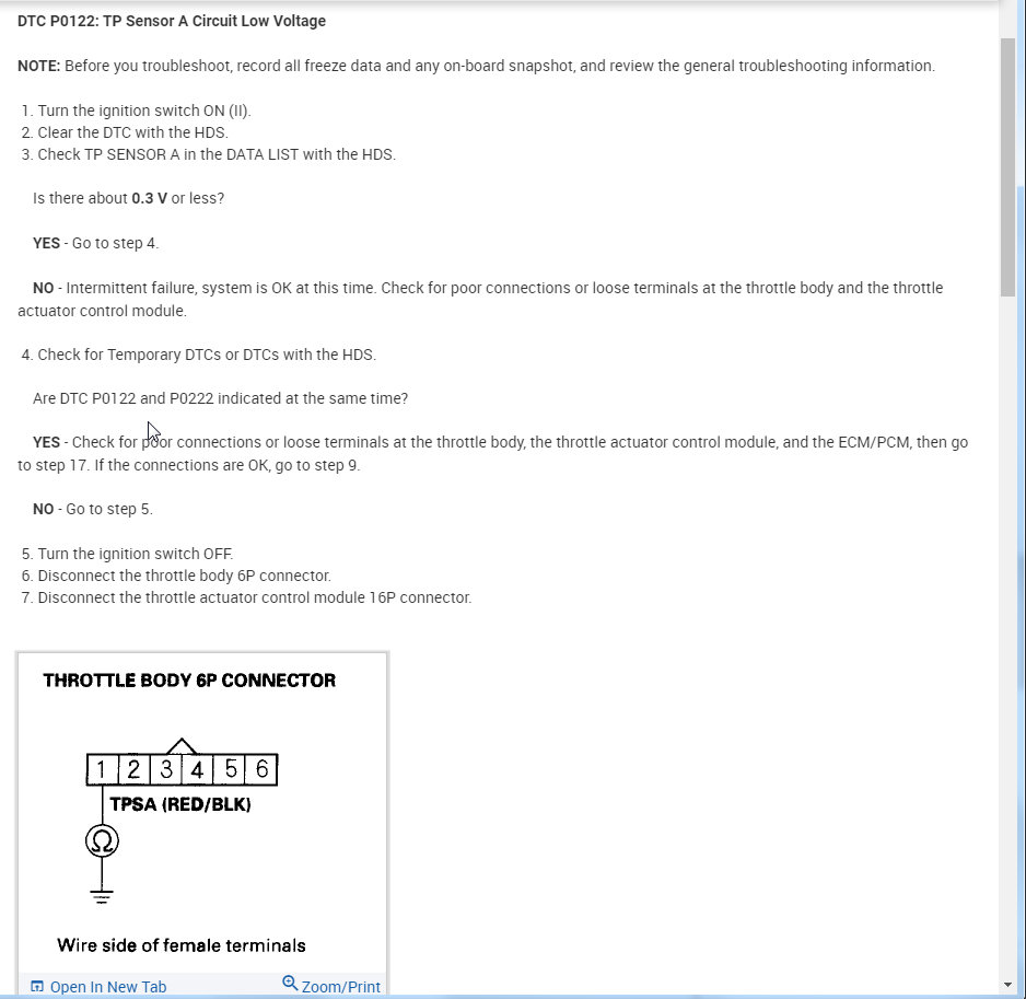

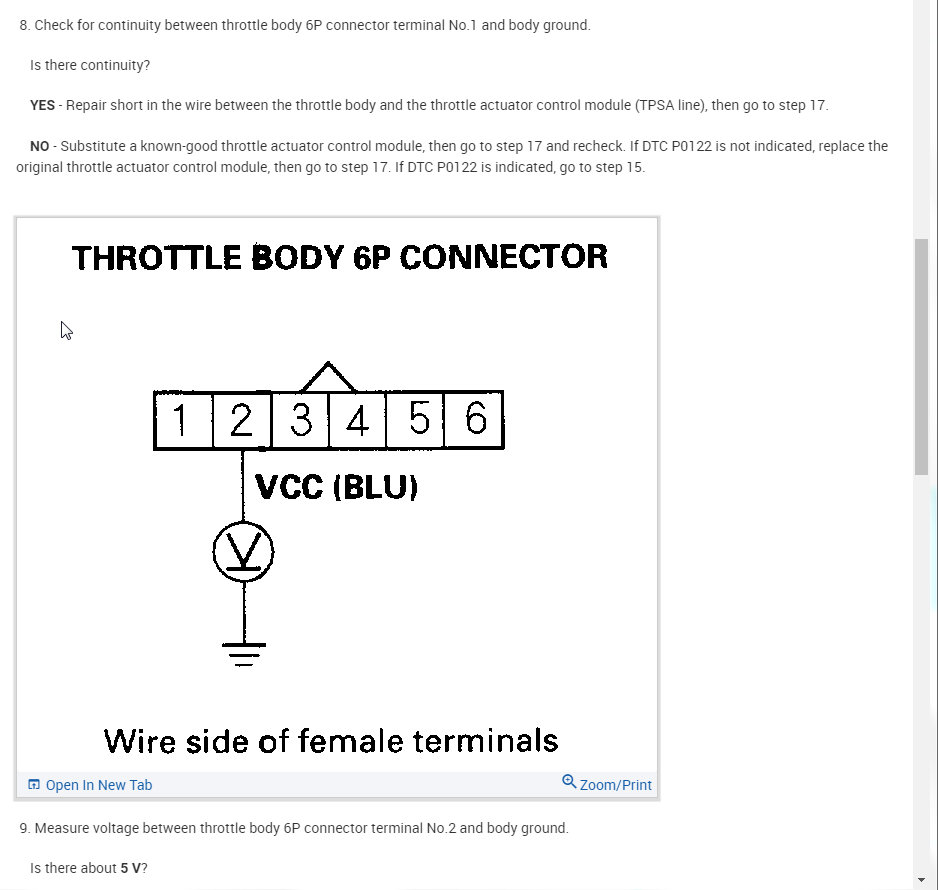

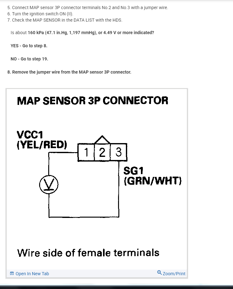

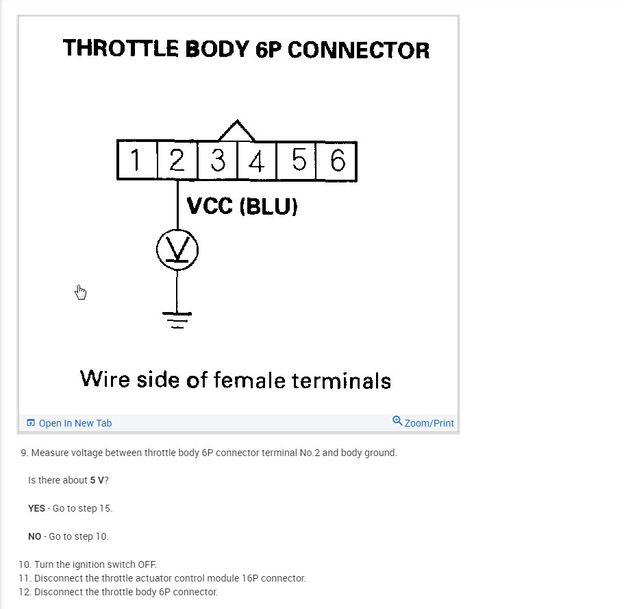

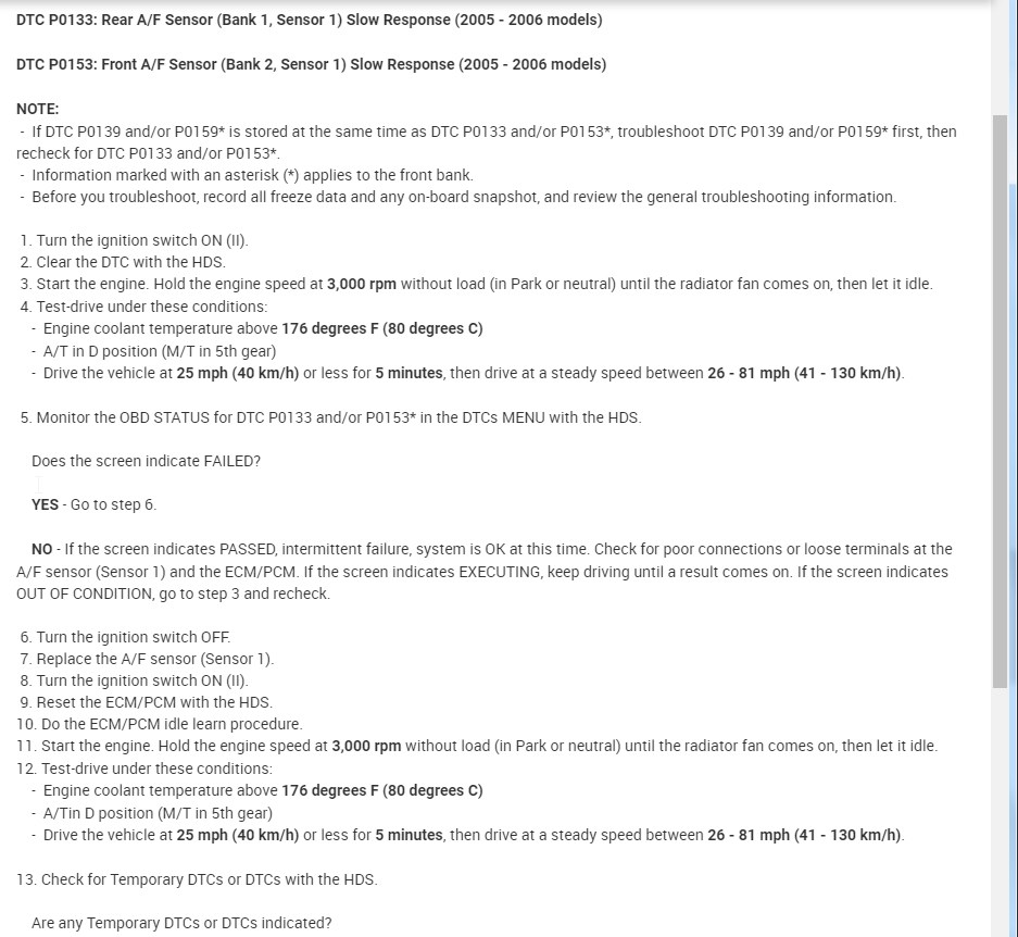

The car started and was moved 25 ft. Left idling while washing exterior. when it was being moved back to parking location there is no response at all with gas pedal. it only idles it has these locked P0122,P0222 P0108 and P0133 codes showing. Car will start and idle but then next time started it will miss (like it is out of timing). The next time it will idle but still no response when pressing on the gas pedal. Codes will not clear.
Side note the full supple line fitting at this time was found to be leaking and was replaced no leaks are present and fuel pressure is normal.
Nov 12, 2019 at 9:09 AM
