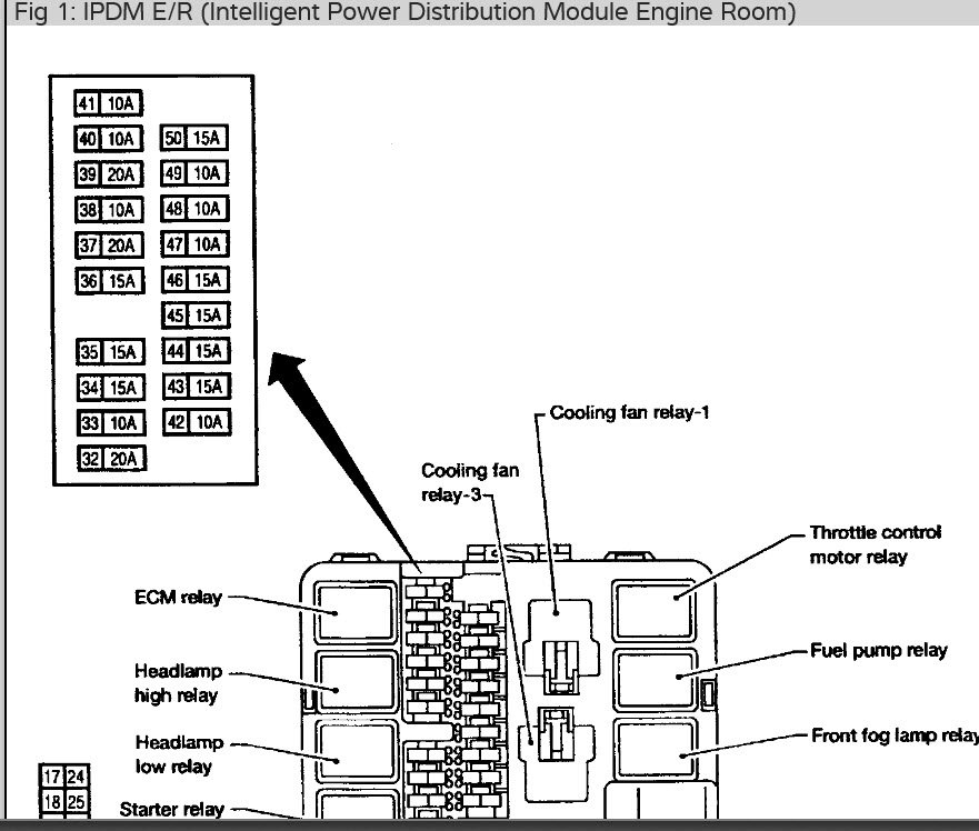

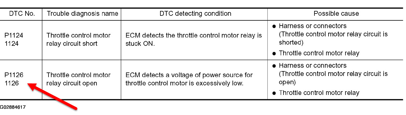

Car temperature went up while driving. There was not enough coolant and the coolant added up. Starting and idle okay. No acceleration. Diagnosis code is P1126 (electronic control throttle control signal system (feedback system).
