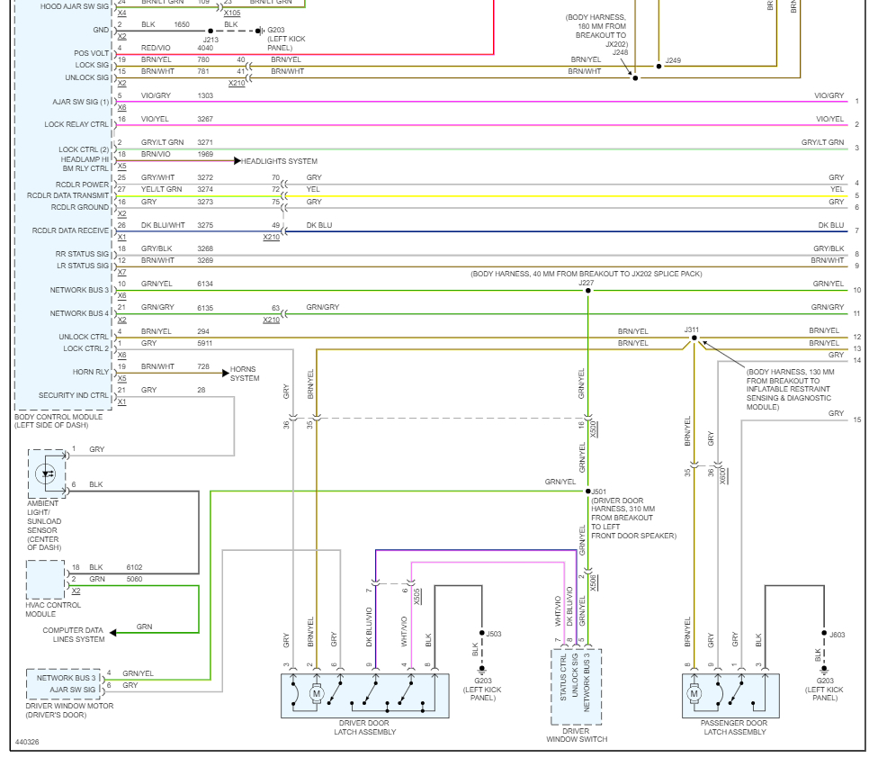

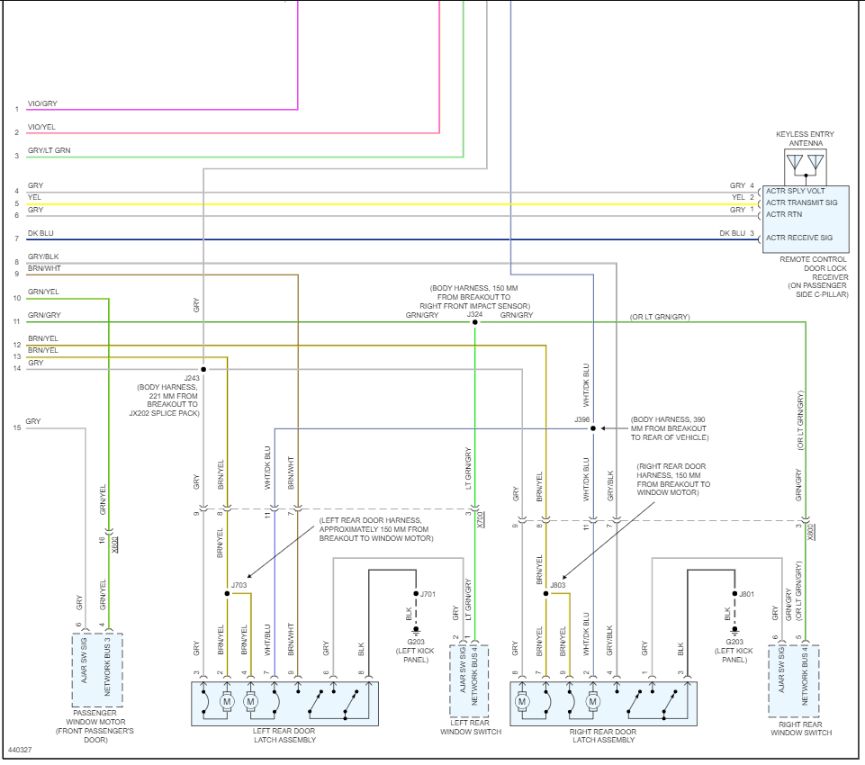

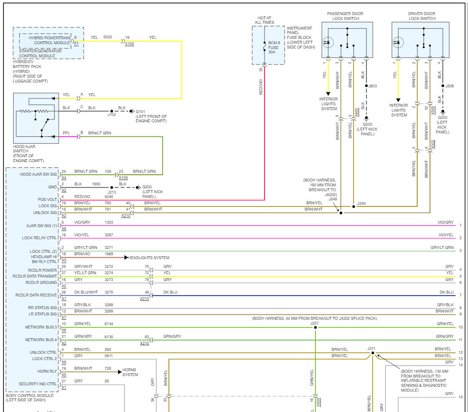

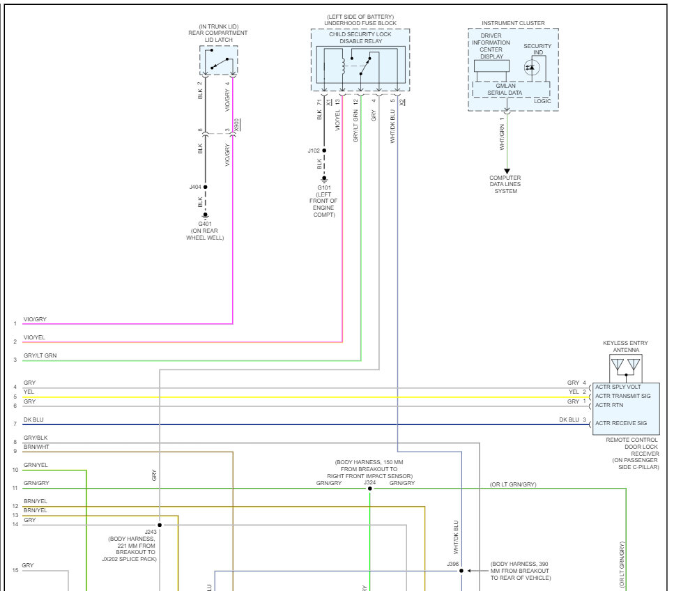

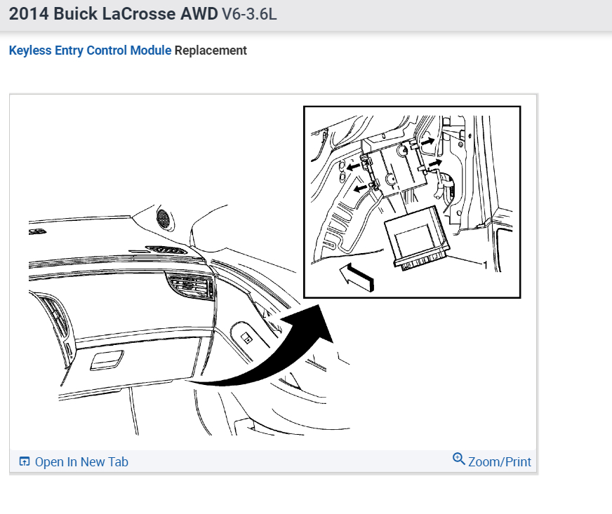

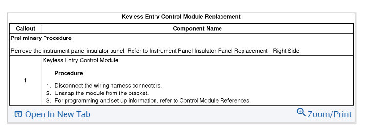

This problem can be the keyless entry antenna, keyless entry control module or the BCM is going out, but you should check the fuse BCM# 8 at the lower left side of the dash panel. I would run a CAN scan to see what codes come up. You can get a CAN scanner (Controller Area Network) which will work on most cars from Amazon.
Here is a video to show you how:
https://youtu.be/u-4syLc-ifQ
and
https://www.2carpros.com/articles/can-scan-controller-area-network-easy
Here is one for about $99.00 if you need it:
https://amzn.to/3ZixY4v

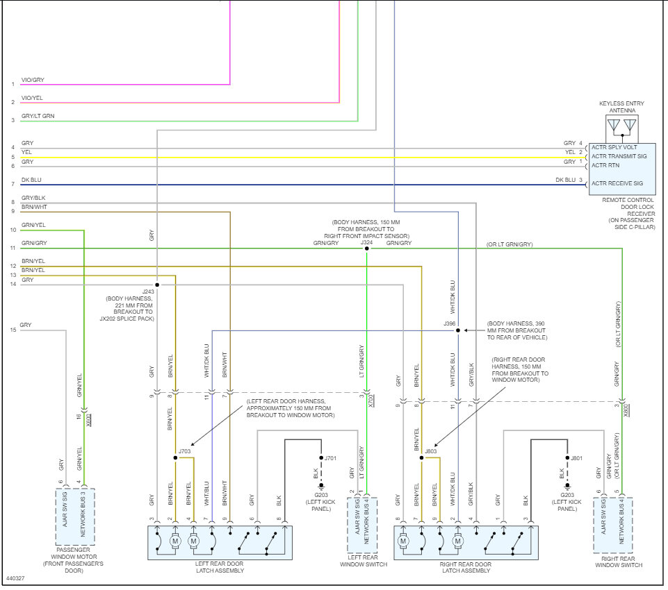

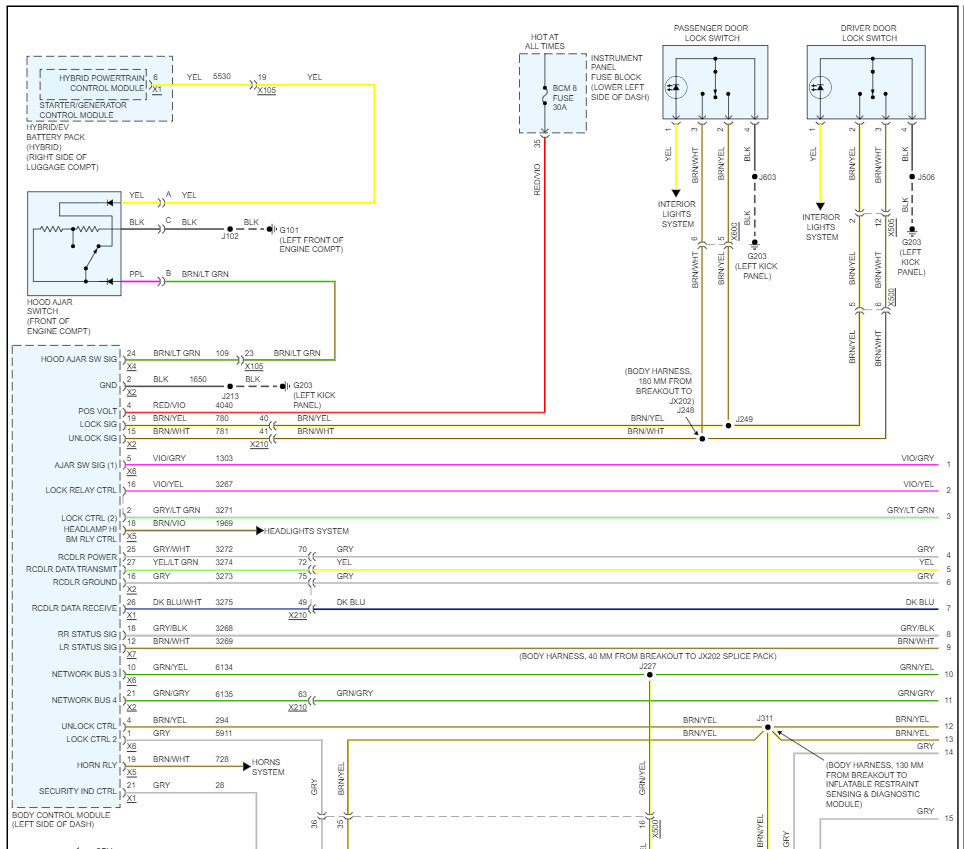

Here is the keyless entry wiring diagrams and module location so you can see how the system works. Check out the images (below). Please let us know what happens.
