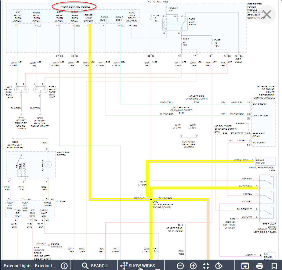

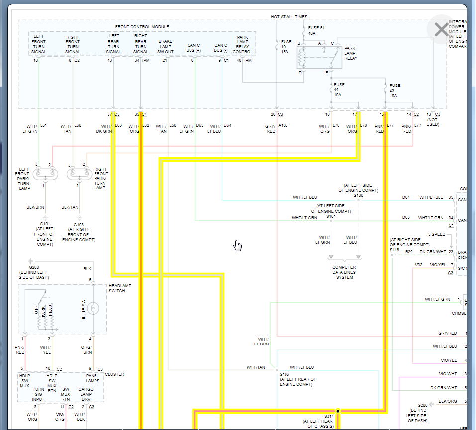

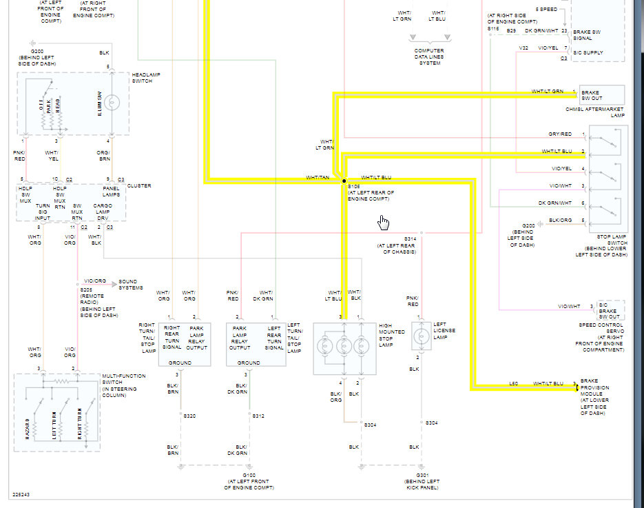

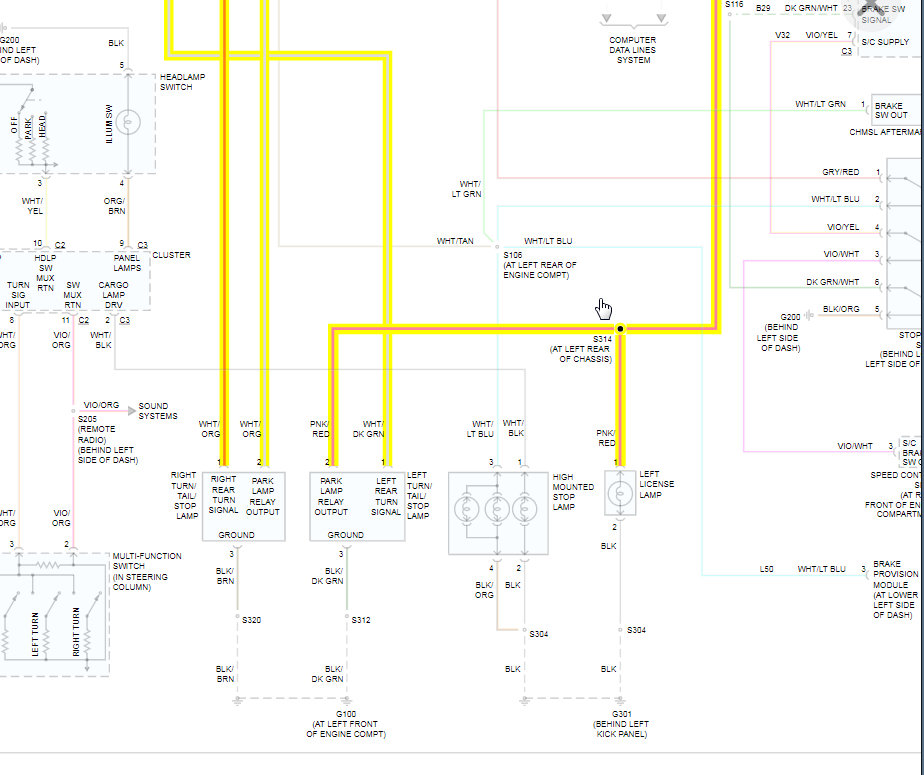

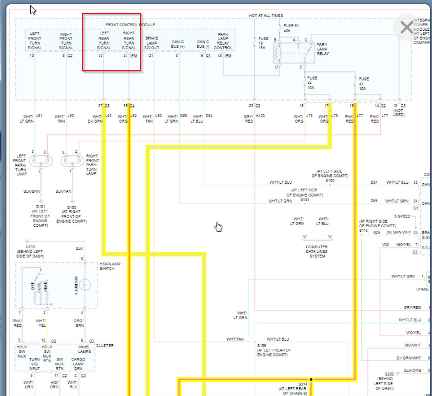

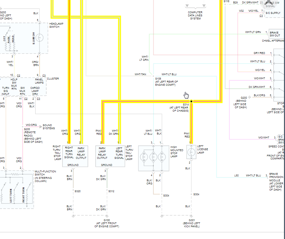

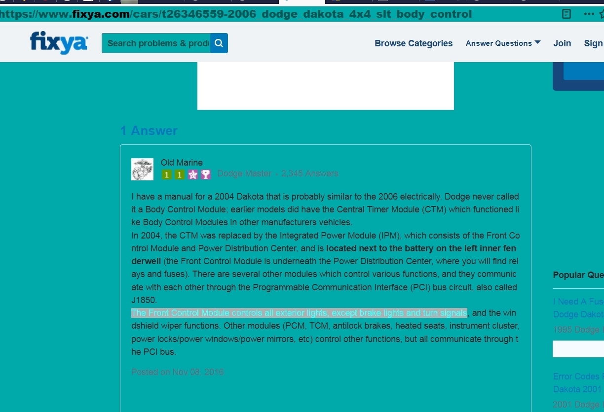

Rear turn,hazard and brake lights are out. all is fine in front. So i know it's not the relay, because relay is for left or right not front-back. Tow connector is hanging from rear bumper for trailer lights. it has been hanging for 6 months but only recently lights stopped working in rear.
