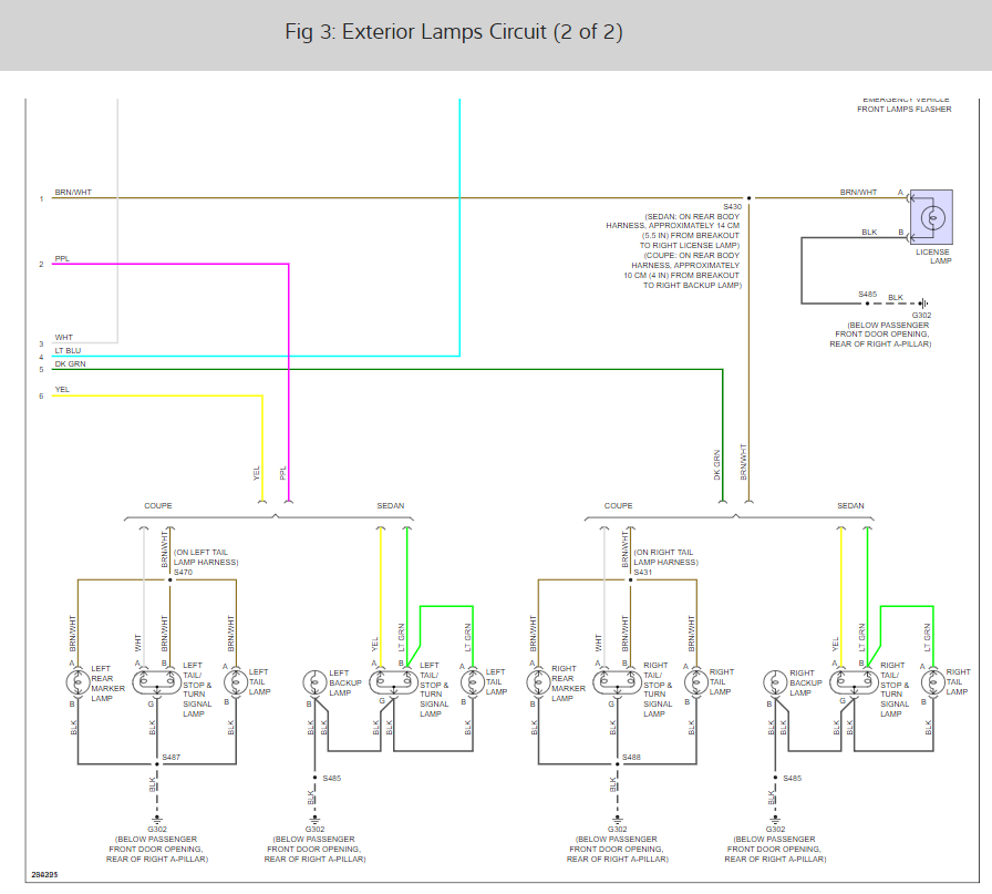

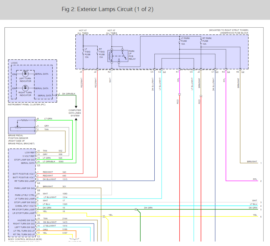

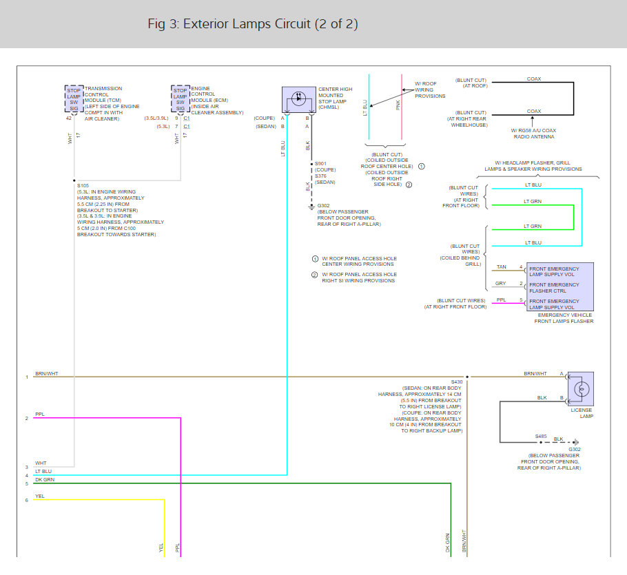

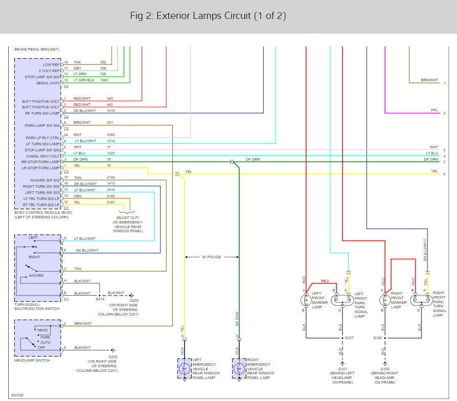

There is a tail light relay #27 that needs to be checked. Here is a guide and the location of the relay along with the wiring diagrams so you can see how the system works:
Jun 25, 2018 at 12:49 PM

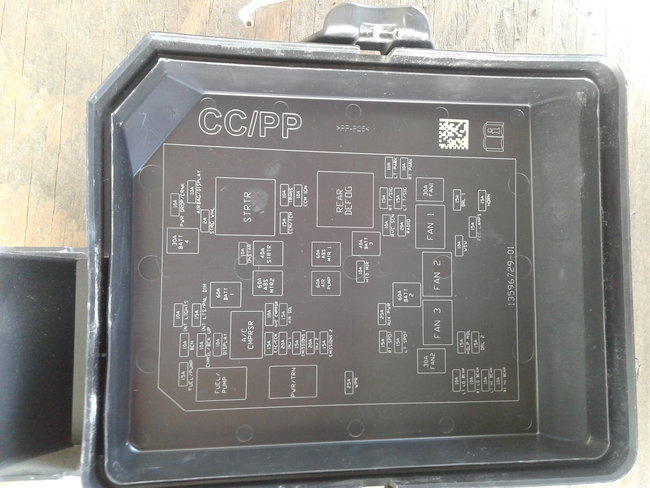

Ken, I check this out and I found that the number in your attachment for the fuse panel cover is 13523182 and the number inside of my fuse panel cover is 13596729- 01. Do you have the same information available for this fuse box because I do not find a number 27?

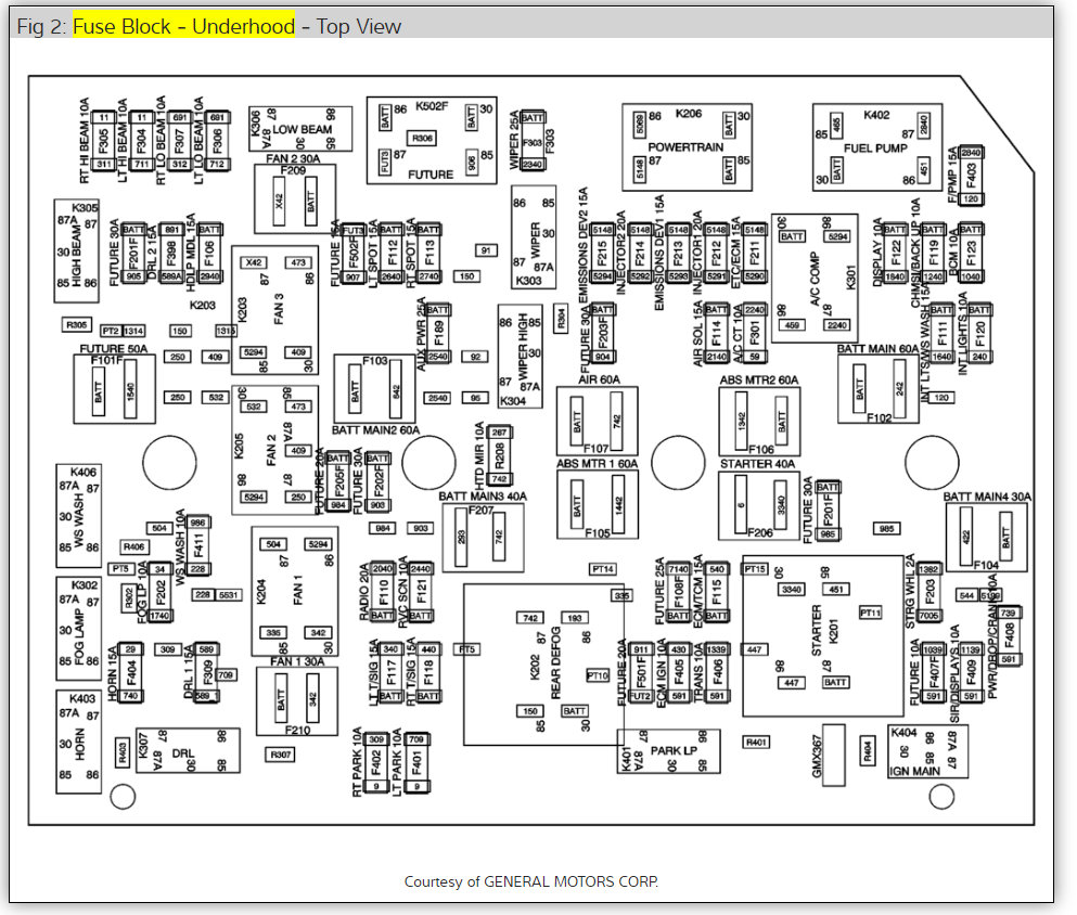

It is a relay in the fuse box #17 which is in the upper left hand corner. Does your PDC have a relay in that position?

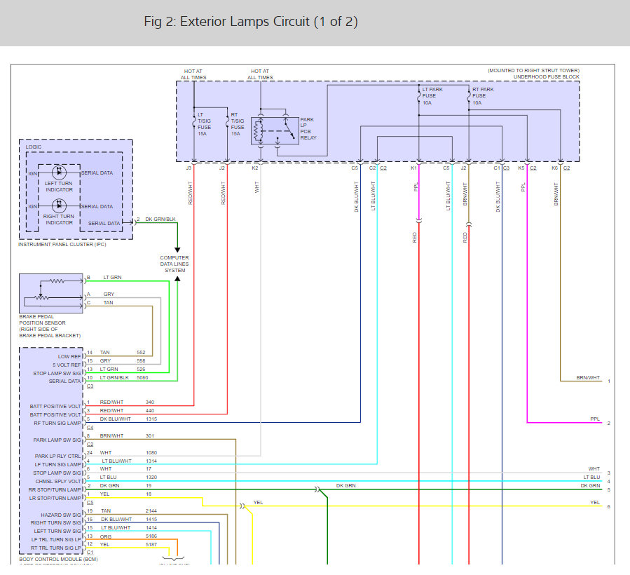

Sorry had the wrong diagram I update the post above. You can see the park/tail/relay below the fuel pump relay.

Please view the my PDC cover diagram. I replaced the relay at #17 position with no positive results.

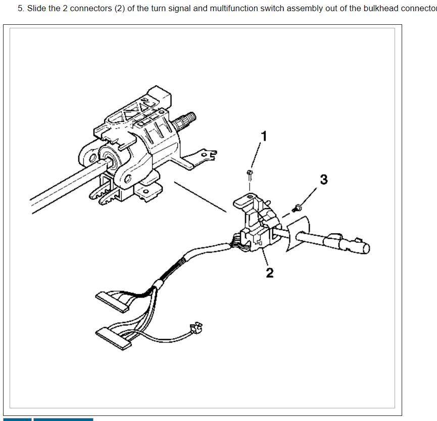

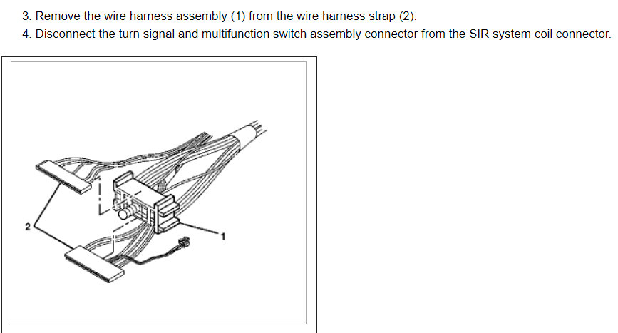

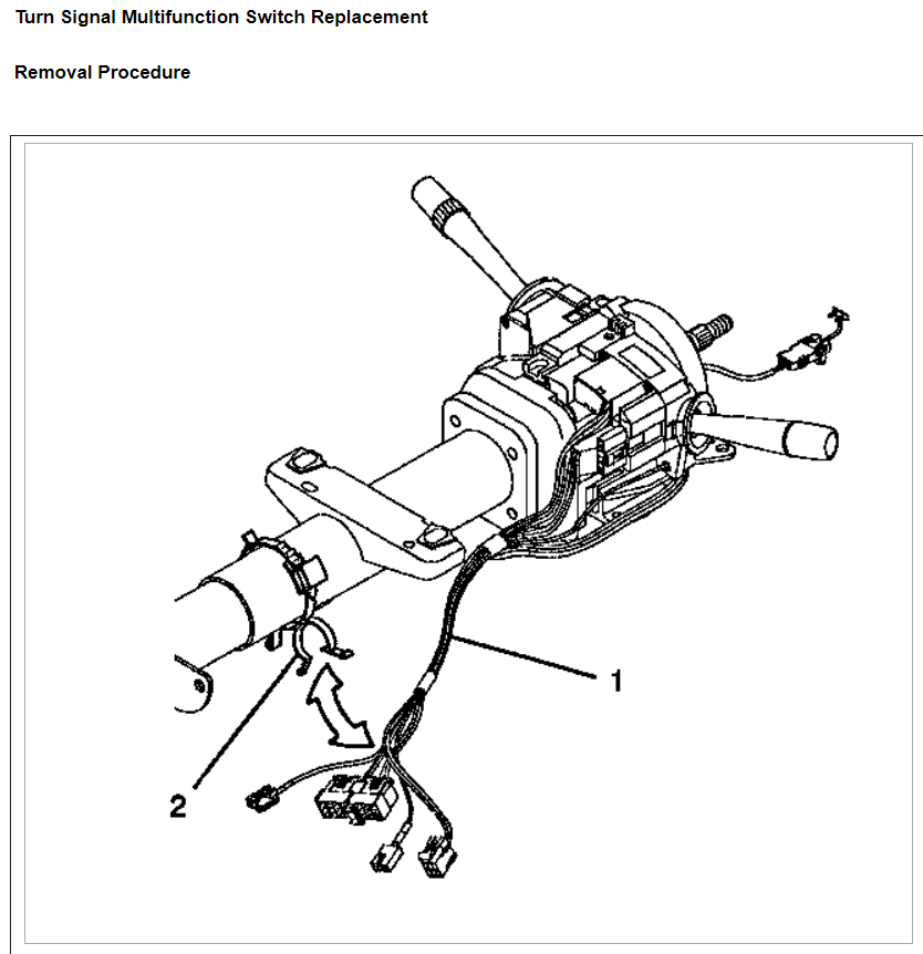

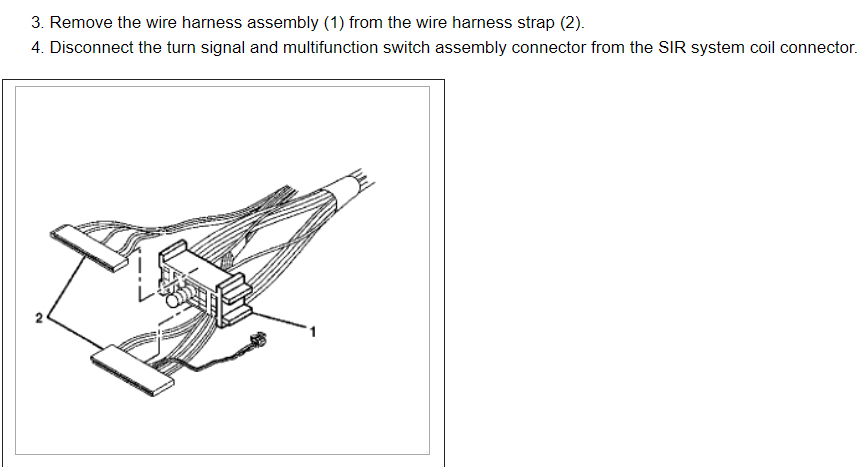

Okay, next let's test through the turn signal switch use the wiring diagrams above and this guide.

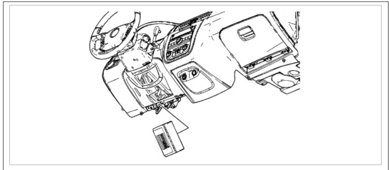

If the switch is okay then it sounds like the BCM is out. Please check all fuses on the BCM as well. Here is the location. Please check all wiring
Check out the diagrams (below). Please run some tests and get back to us.
