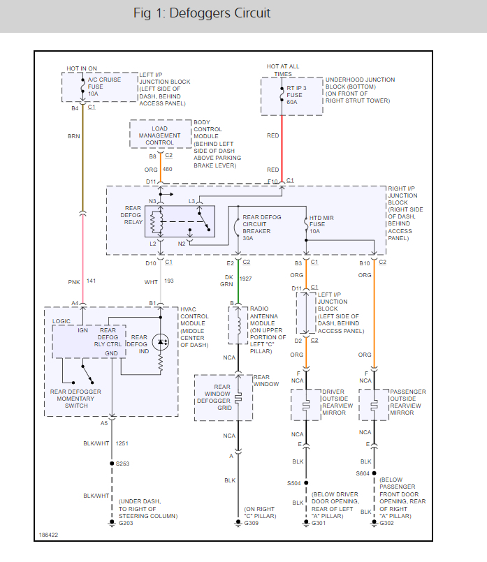

How many terminal on the relay should be hot? And is the heated mirror fuse have anything to do with it? Thanks
Sep 5, 2019 at 6:22 PM
It should be two.here is the wring diagrams and a guide to help you test the relay:
