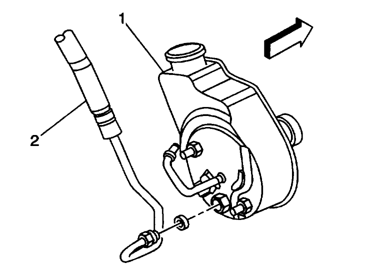

5. Place a drain pan under the vehicle.
6. Remove the power steering pressure hose (2) from the power steering pump from underneath the vehicle.
7. Lower the vehicle.
imageZoom/Print

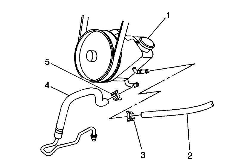

8. Remove the clamps (3,5) retaining the power steering return hoses to the power steering pump and remove the hoses.
9. Remove the lower intermediate shaft from the steering gear.
