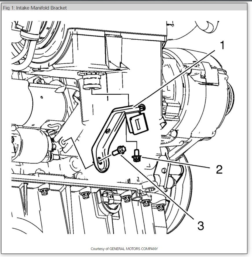

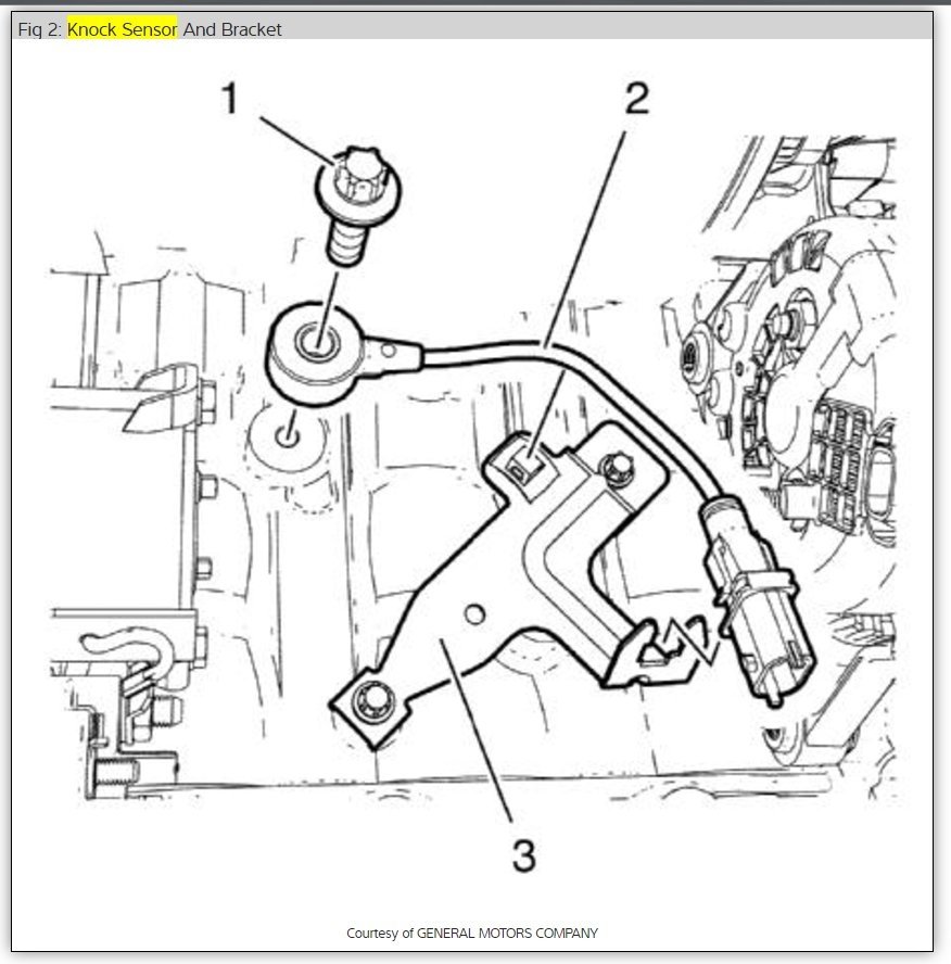

This means the knock sensor has shorted out and needs to be replaced, here is a diagram on the sensor and its location. It could be unplugged as well. You may need to jack the car up
