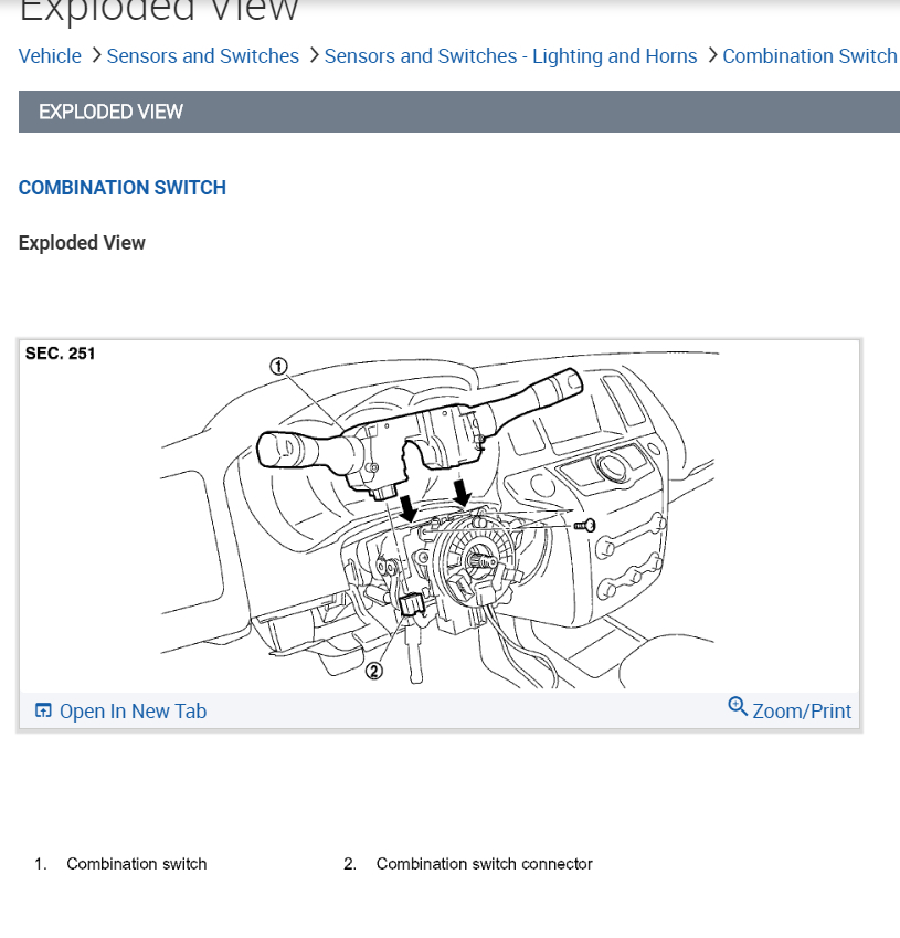

Aug 8, 2019 at 7:18 PM

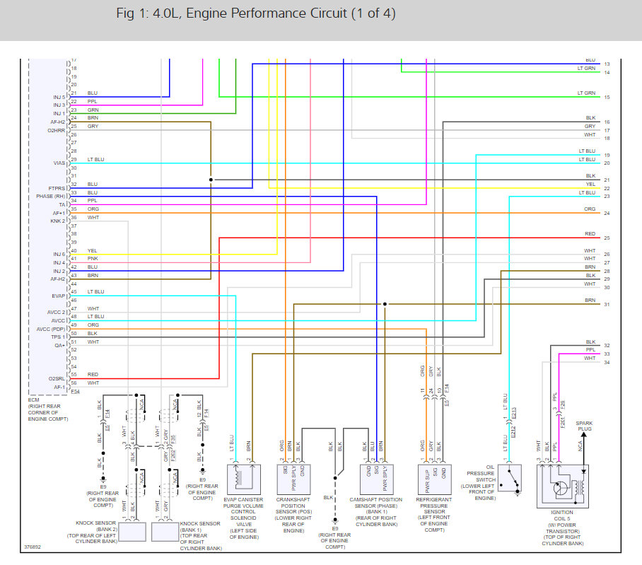

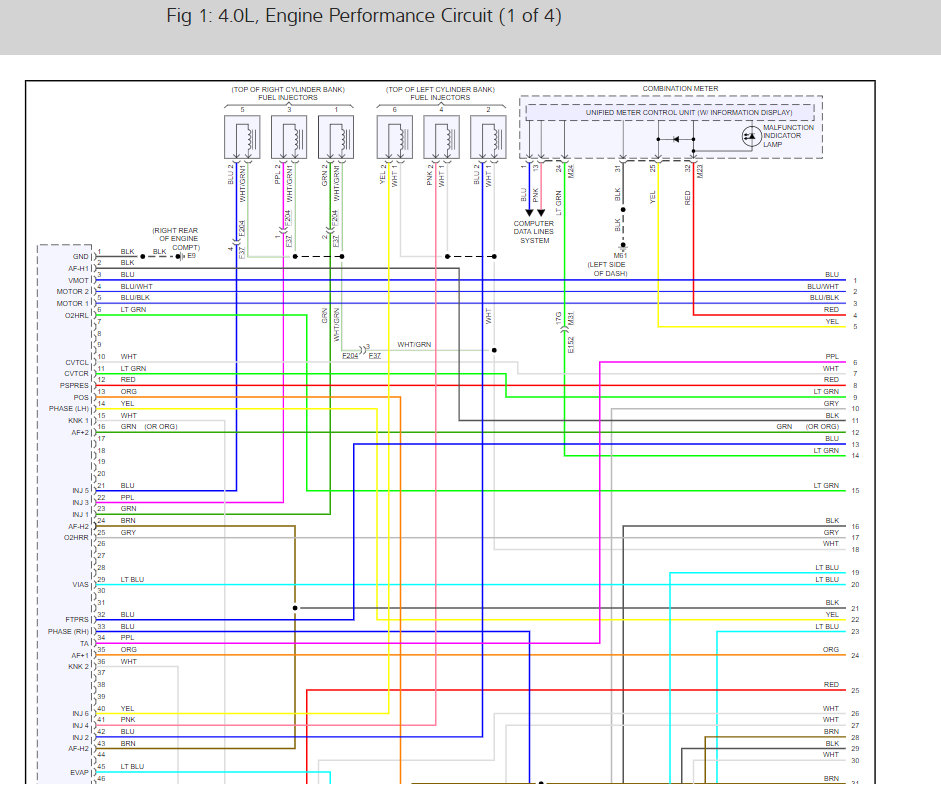

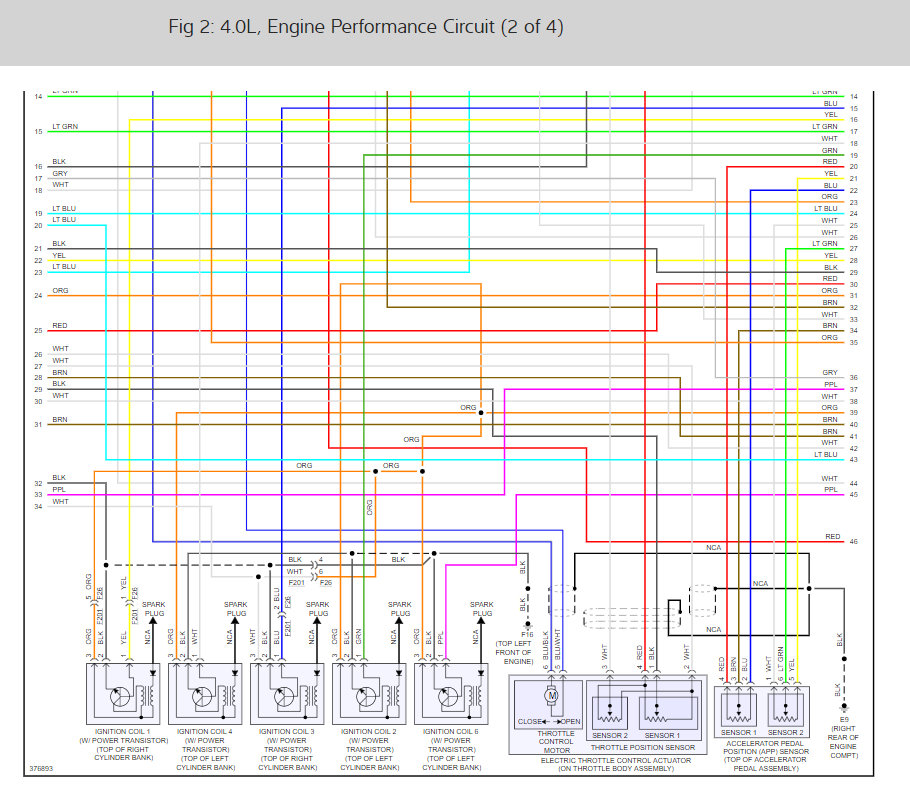

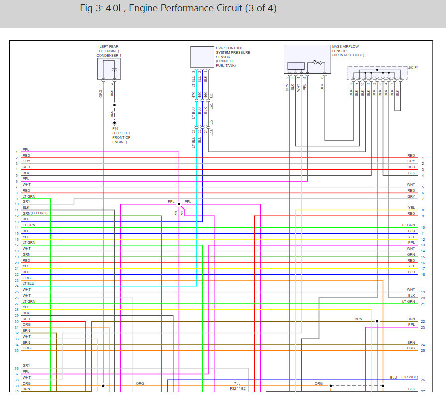

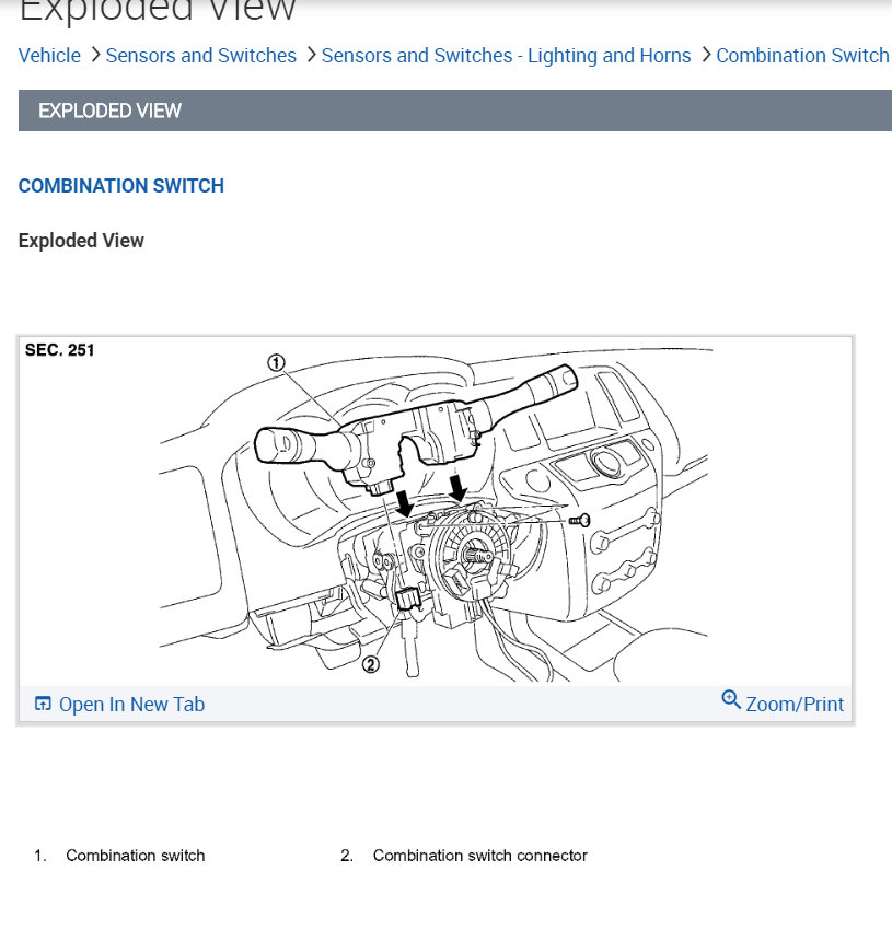

Okay, I see what you are talking about thanks for the video. It looks like the headlight switch is bad causing the issue. here is how you replace it. Check out the diagrams (below). Please let us know what happens.
Aug 9, 2019 at 12:22 PM

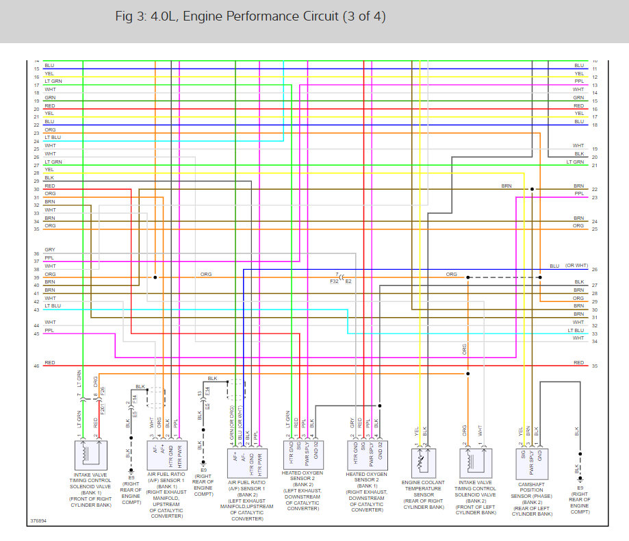

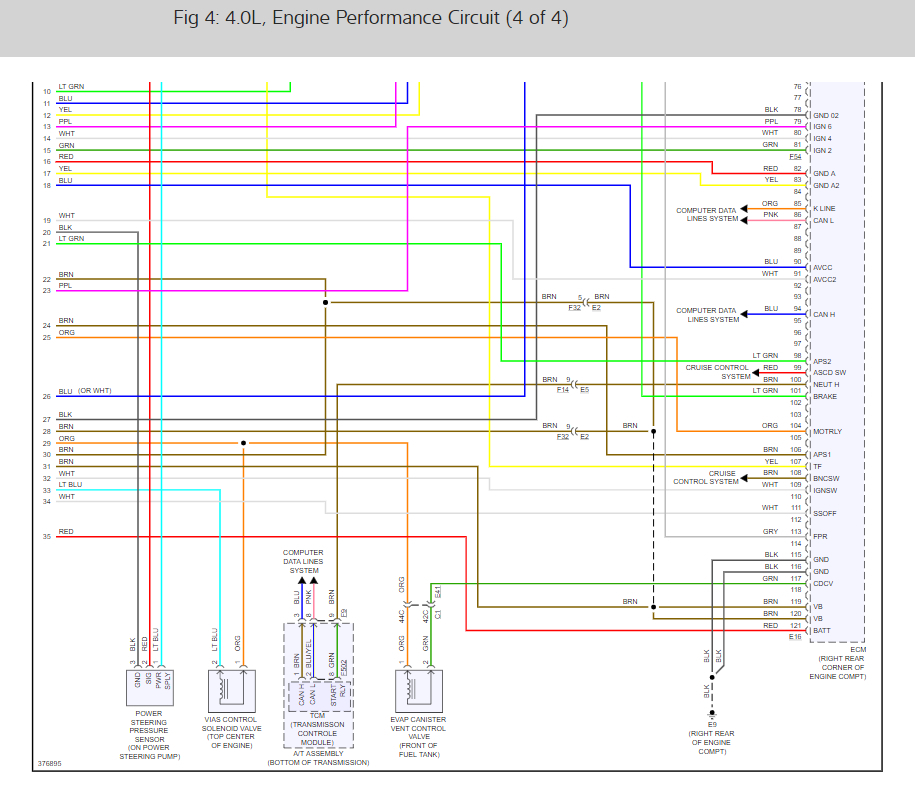

RUDONOVON
  • 12 POSTS

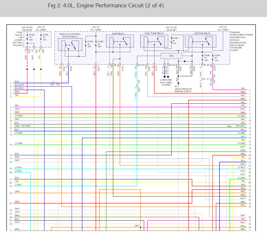

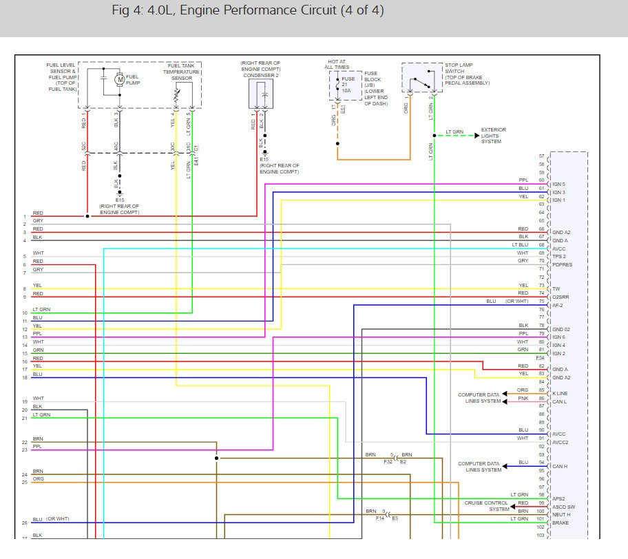

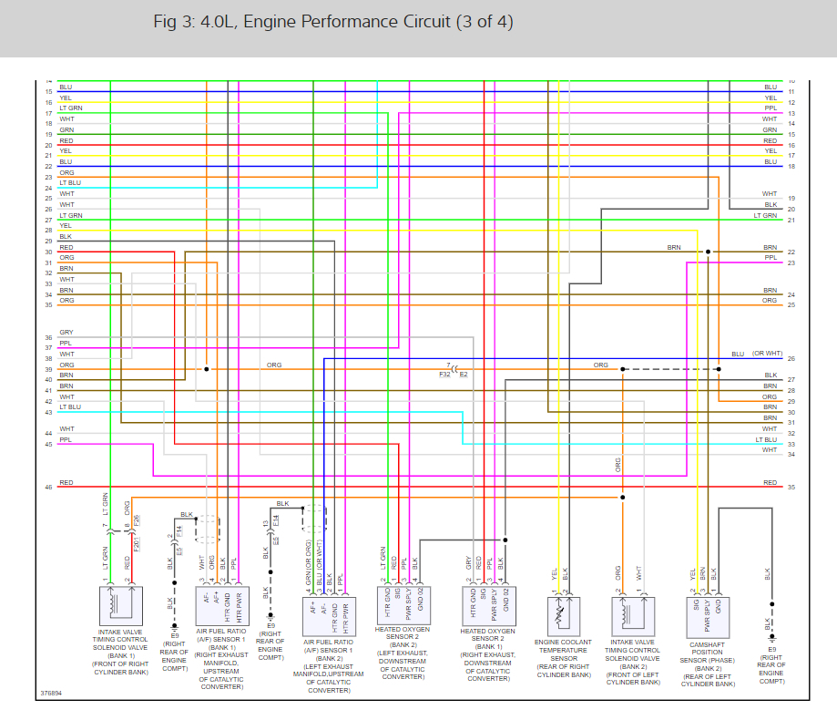

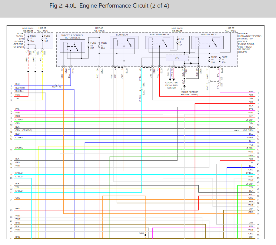

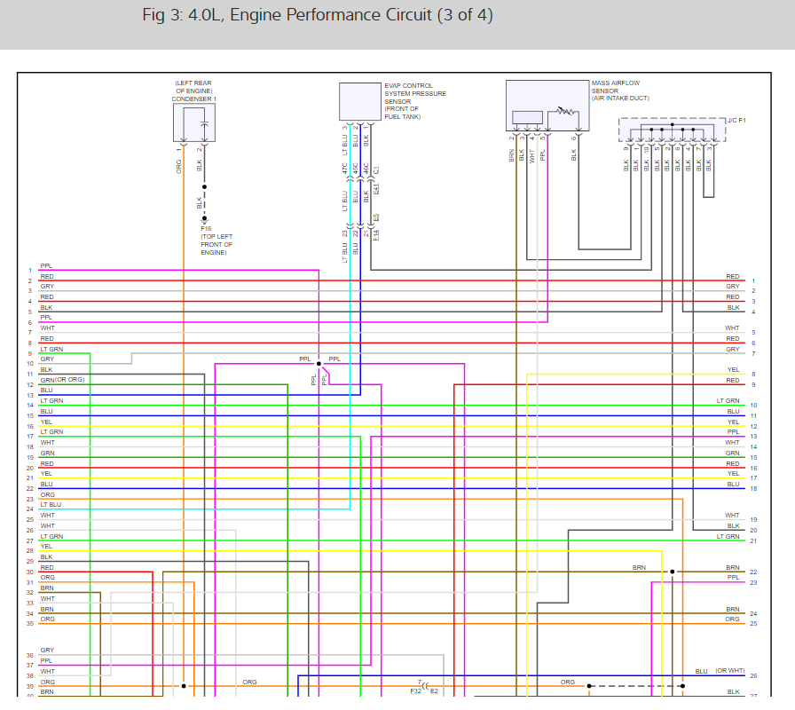

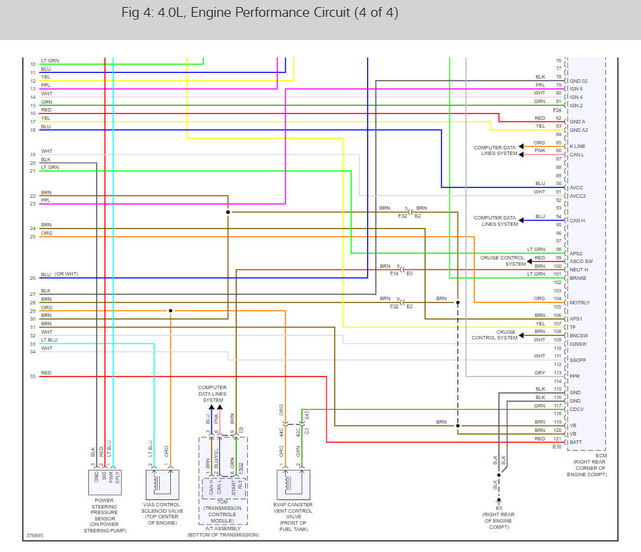

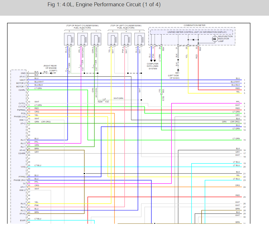

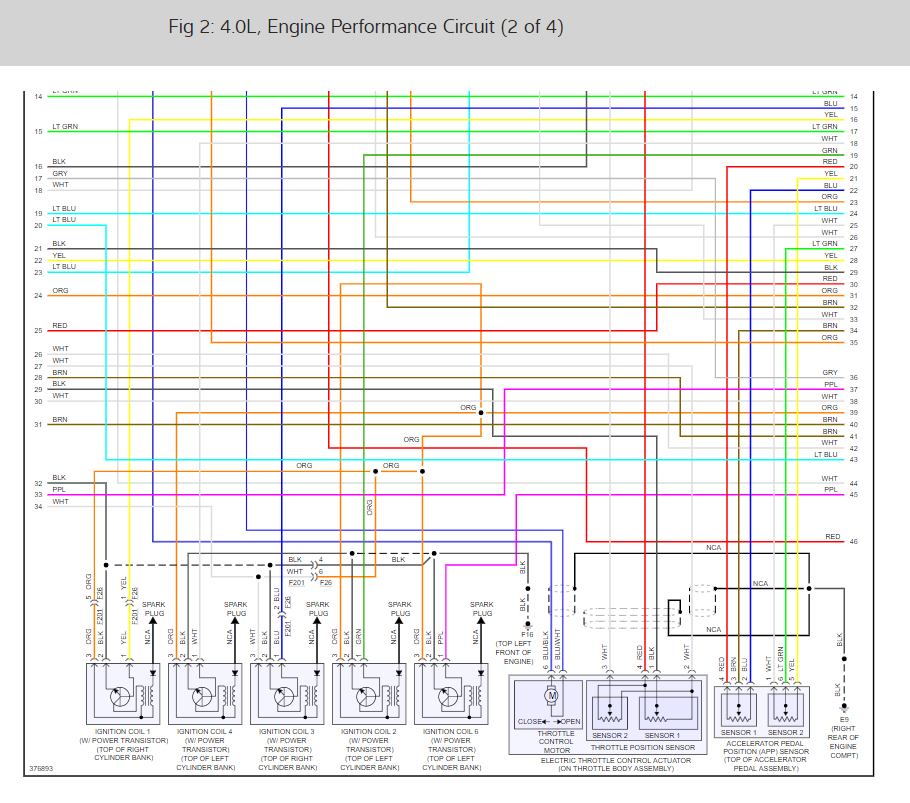

Okay, thanks. The van i have is a Japanese type right hand drive please i would like if you can send me the wiring diagram for the NV200 fuse to relay to switch to lights so i can see if the fuel pump is in line with this switch at anytime.
Aug 11, 2019 at 2:15 AM
Here are the wiring diagrams to help you with your testing and a guide as well:
Aug 12, 2019 at 10:53 AM

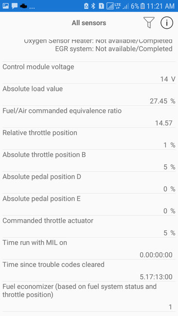

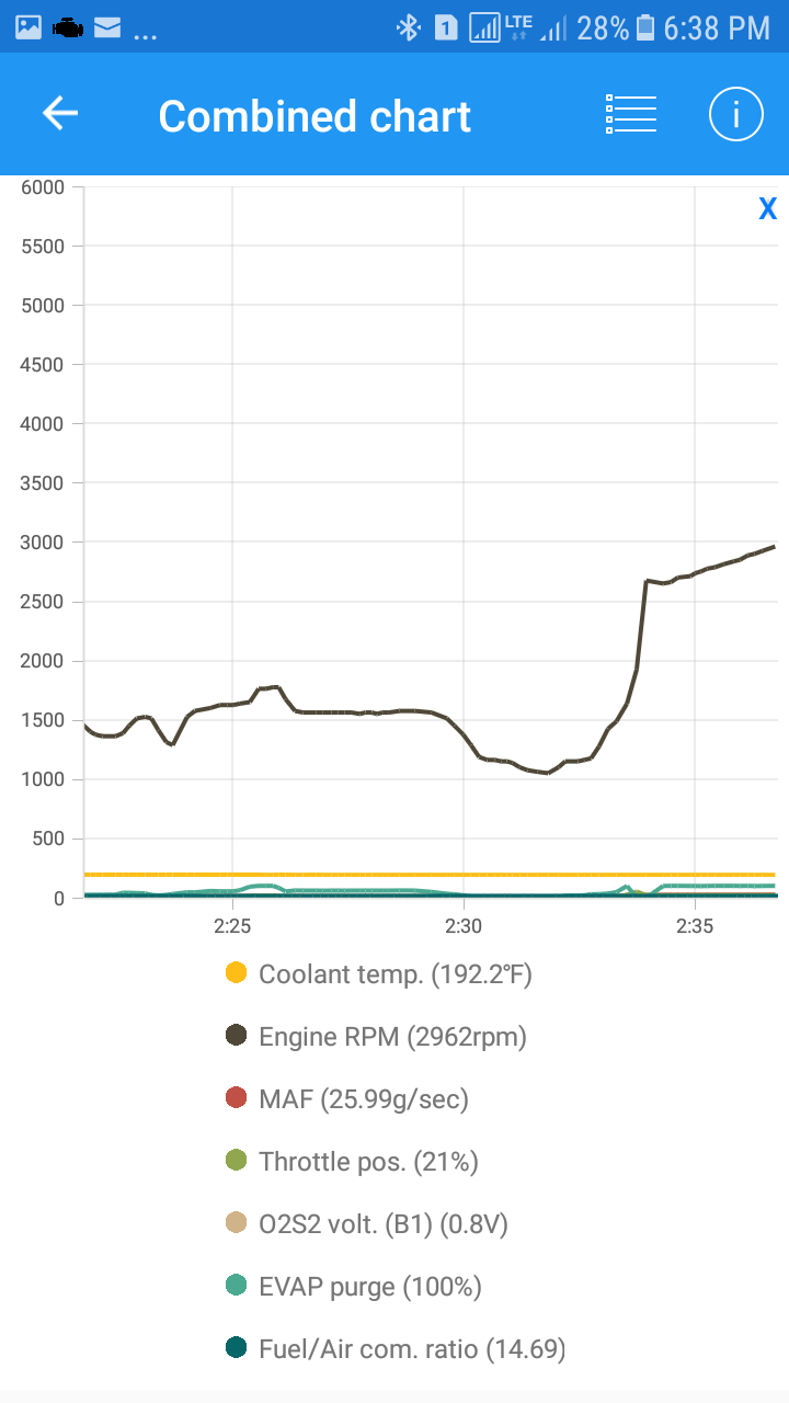

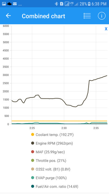

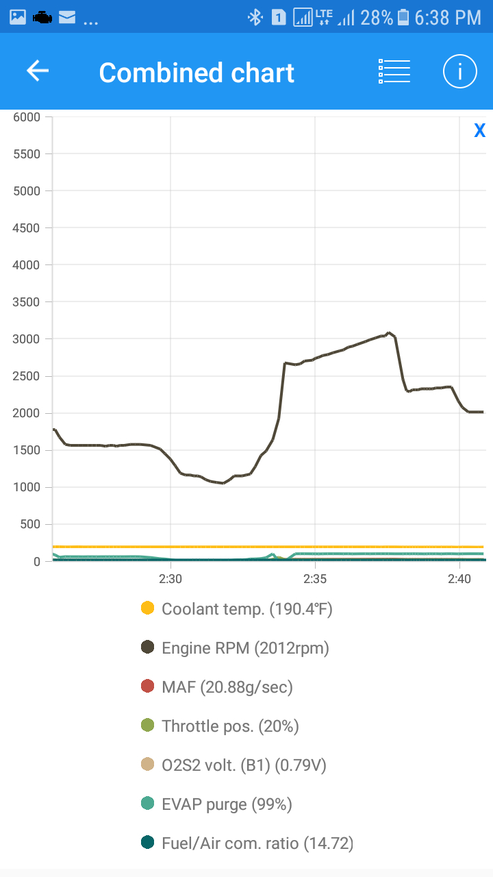

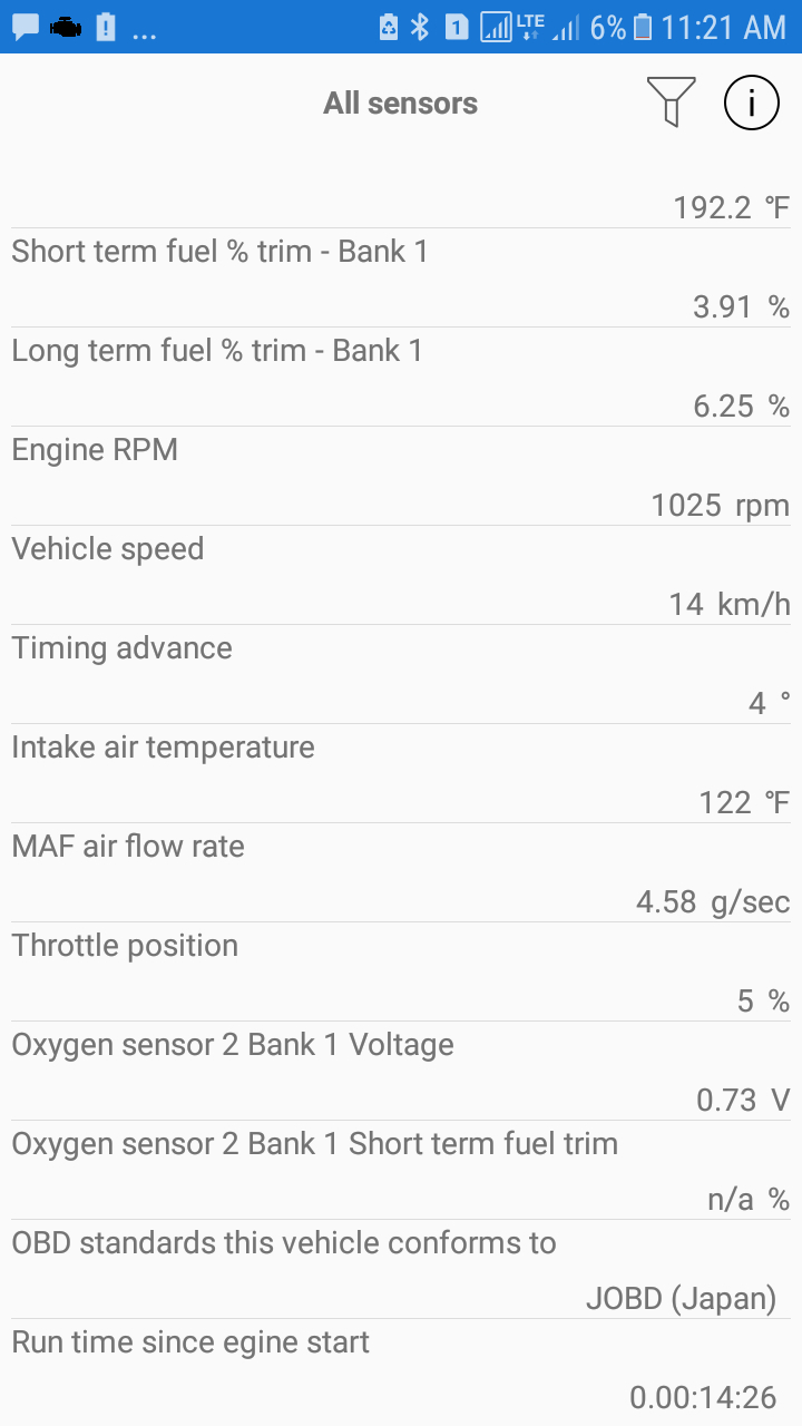

Today i did some observation i used a OBD2 scanner as i was driving. i noticed that while checking the throttle open position it was open to 57% as i switched the park light on it went down to 21%. every time i switched on the light and does not go up until i switch it off .
Aug 14, 2019 at 7:03 PM
That does not sound right at all, so at idle it is at 21%. should be at like 3% this will be the ECU or a throttle actuator issue.
Aug 15, 2019 at 10:37 AM
RUDONOVON
  • 12 POSTS
sorry it is at 4% idle, but when floored the max is 21% no higher when park lights turned on.
Aug 15, 2019 at 5:14 PM

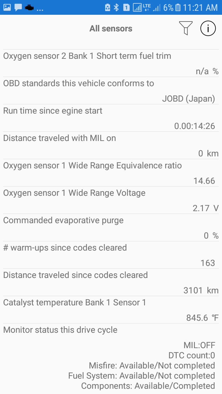

RUDONOVON
  • 12 POSTS

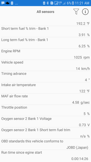

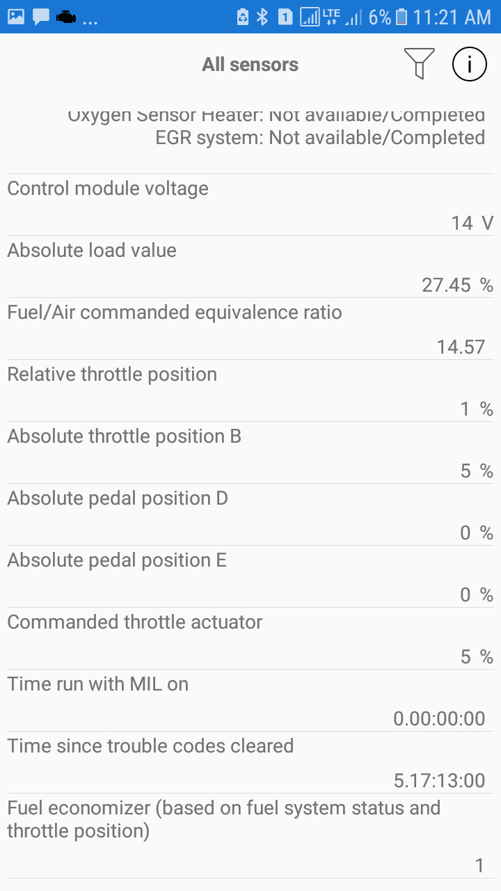

Good evening. Here are some reading from the OBD2 scanner.
Aug 15, 2019 at 5:20 PM
RUDONOVON
  • 12 POSTS
throttle at idle is 5% i see.
Aug 15, 2019 at 5:22 PM
RUDONOVON
  • 12 POSTS
throttle at idle is 5% i see with A/C running.

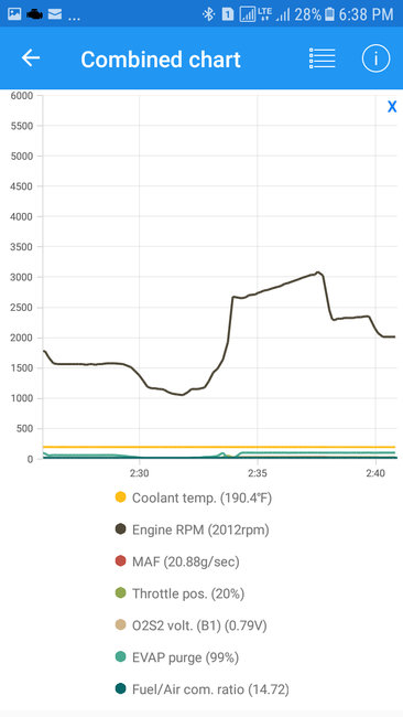

RUDONOVON
  • 12 POSTS
This is the reading second photo with pedal floored park lights on.not opening more than 21% so rev not going pass 2990 rpm.
Aug 15, 2019 at 5:54 PM
The engine will not rev in neutral the computer will not allow it. Did we check the alternator for AC voltage?
