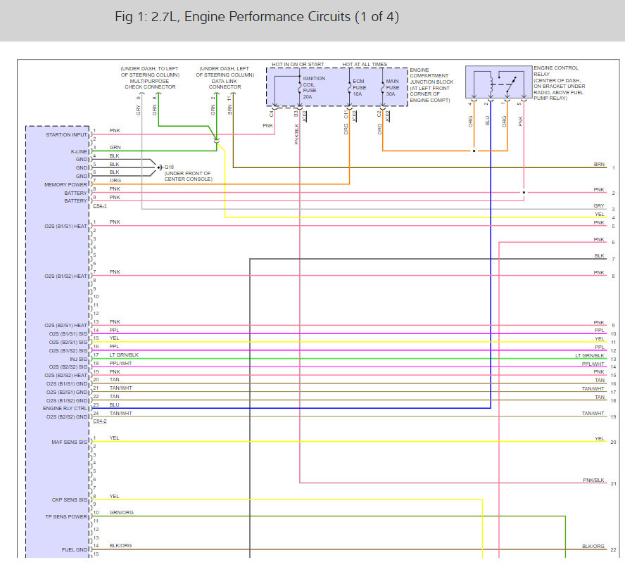

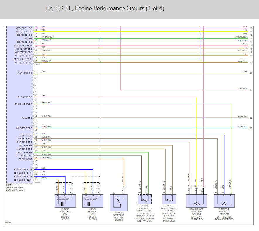

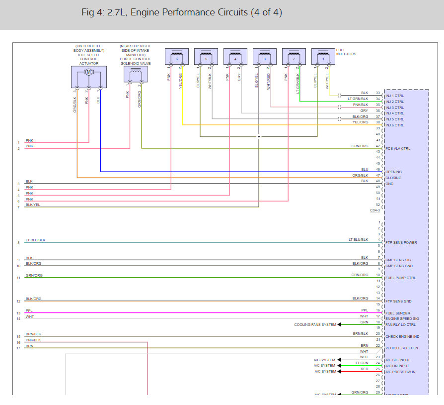

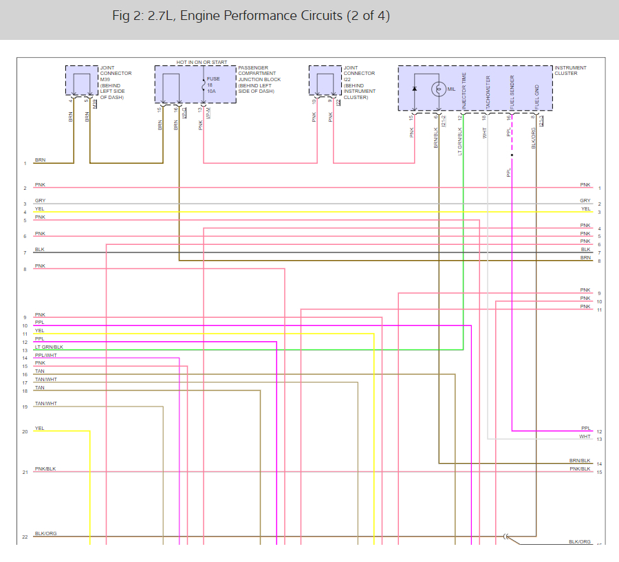

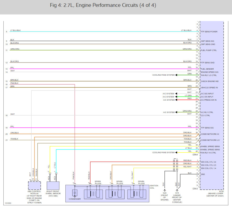

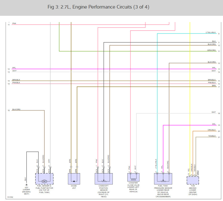

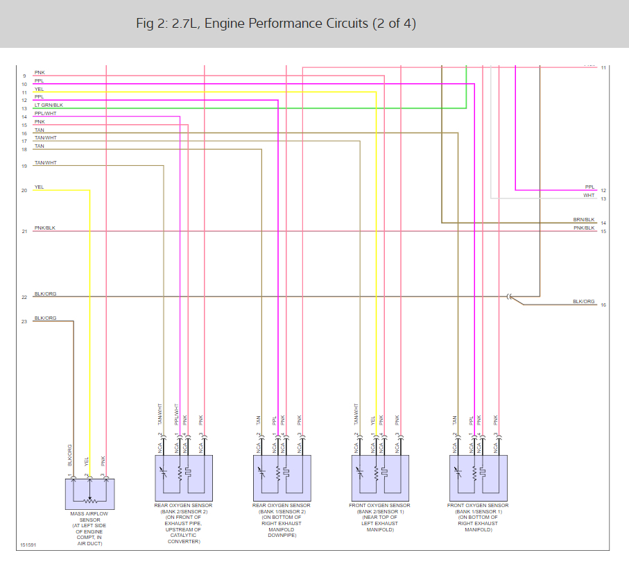

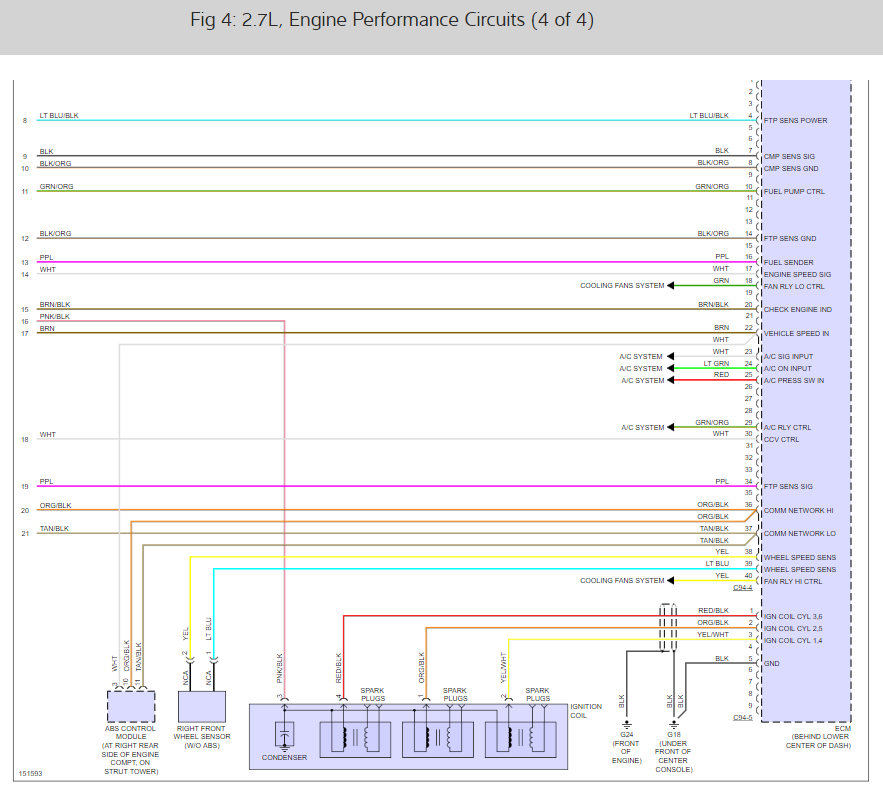

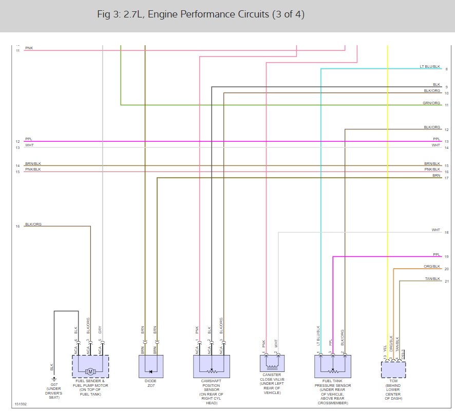

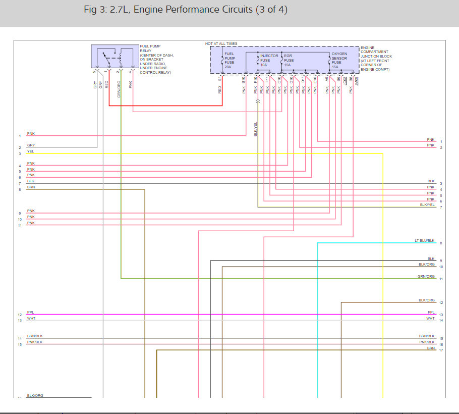

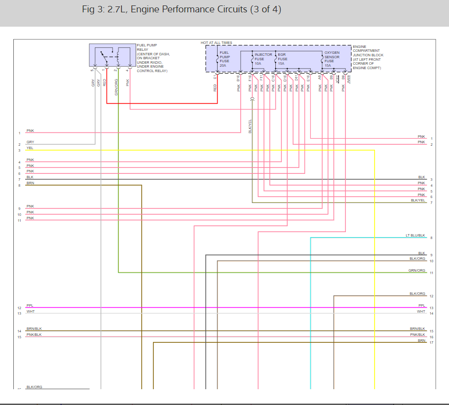

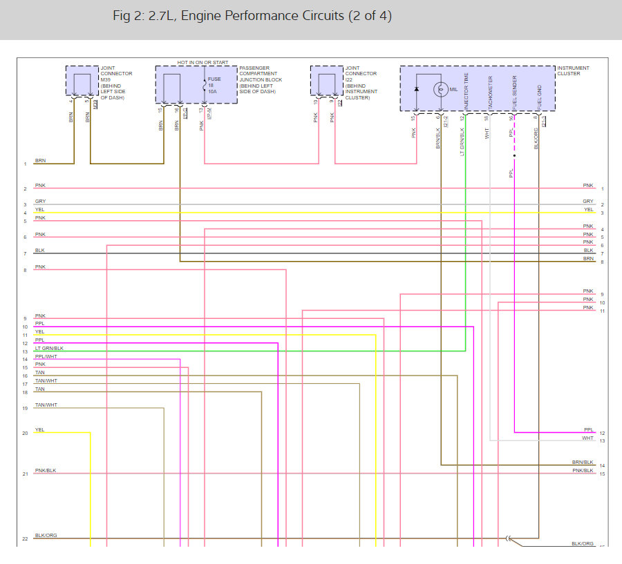

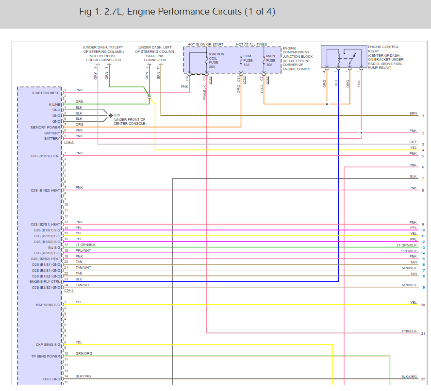

Hello, there is an engine control relay I think is going bad. Here is a guide to help you test it and the engine wiring diagrams so you can see how the system works with a guide to help you test the connections. Also the location of the relay is under the radio next to the fuel pump relay.
and
Check out the diagrams (below). Please let us know what you find.

Hi Ken, Thank you so much for your fast reply. As it turn out all the things that I replaced were good preventive maintenance. The reason I had intermittent starts was a loose ground connection under the driver's seat that includes power to the fuel pump. However, diagnosing the problem came at a huge cost. You see, in order to replace the knock sensors I had to remove the intake manifold. In doing so, I carelessly dropped a washer into a cylinder head and now I'm scrabbling to find a way to pull it our without having to remove the head. The washer is too big to come out through the spark plug hole. Any ideas? Thanks again.
