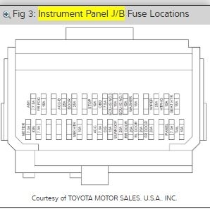

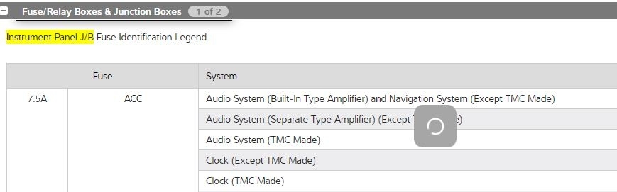

It sounds like you took out a fuse either under the dash or if the new system has an inline fuse, it may have blown. Check the fuse box under the dash. I attached a picture of the fuse box and then a legend of the audio fuses. Check that first. I mention this because you said you checked fuses under the hood.
Let me know if this helps.
