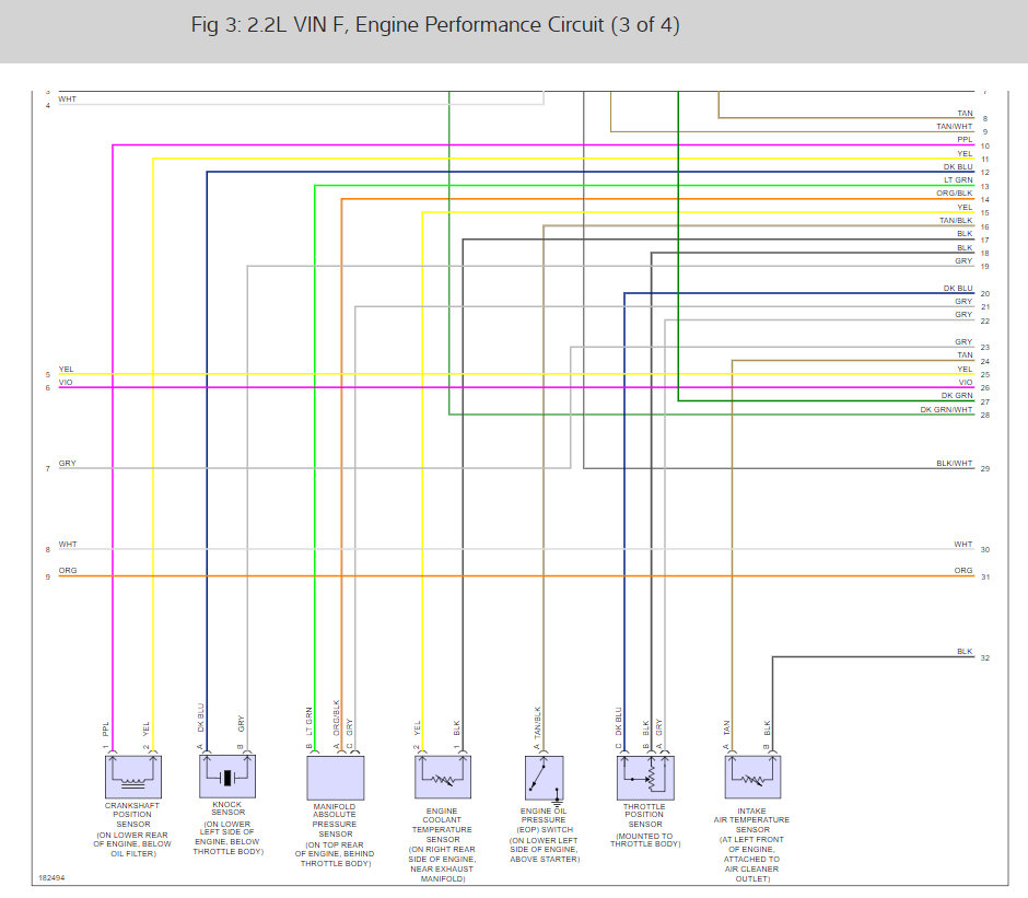

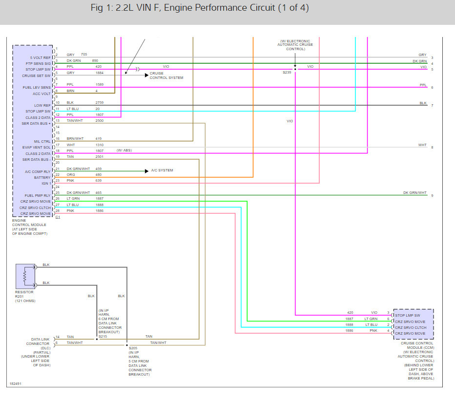

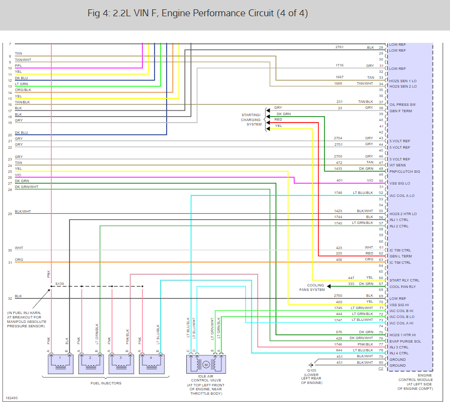

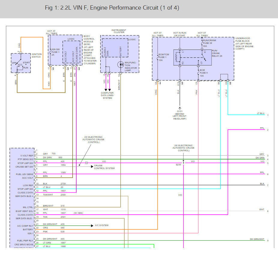

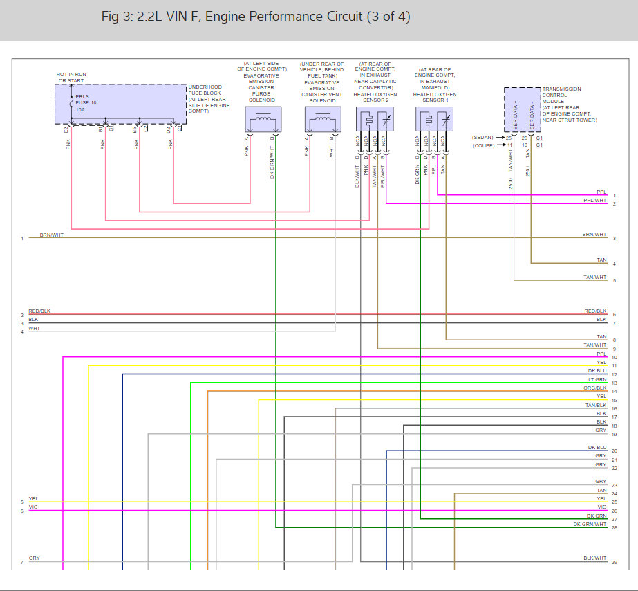

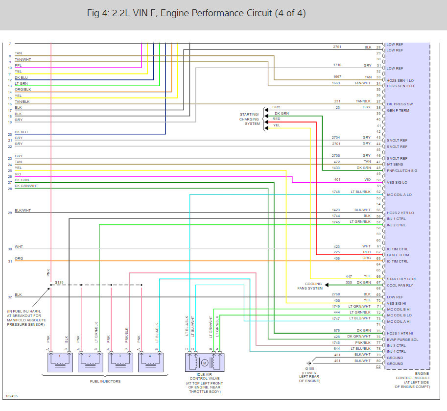

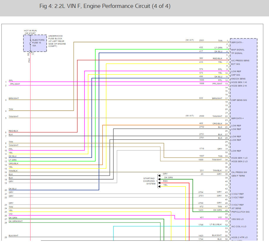

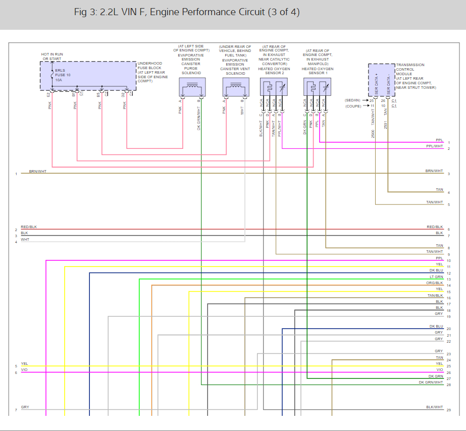

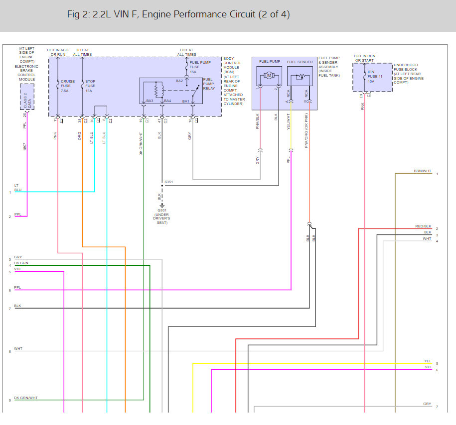

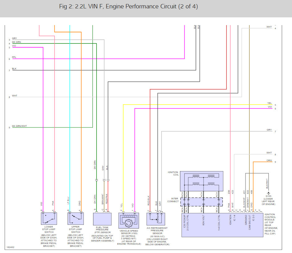

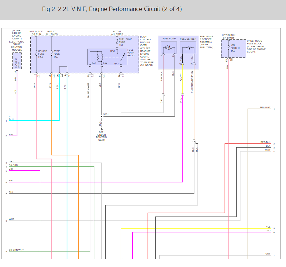

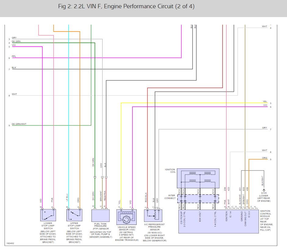

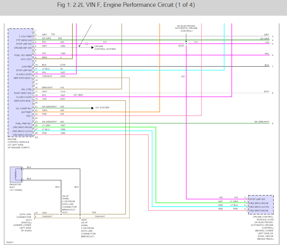

Lets check the wiring for the system to confirm and if okay I believe the PCM has gone out. Here is a guide and the engine wiring diagrams to confirm the issue. Check power and grounds for the PCM.
