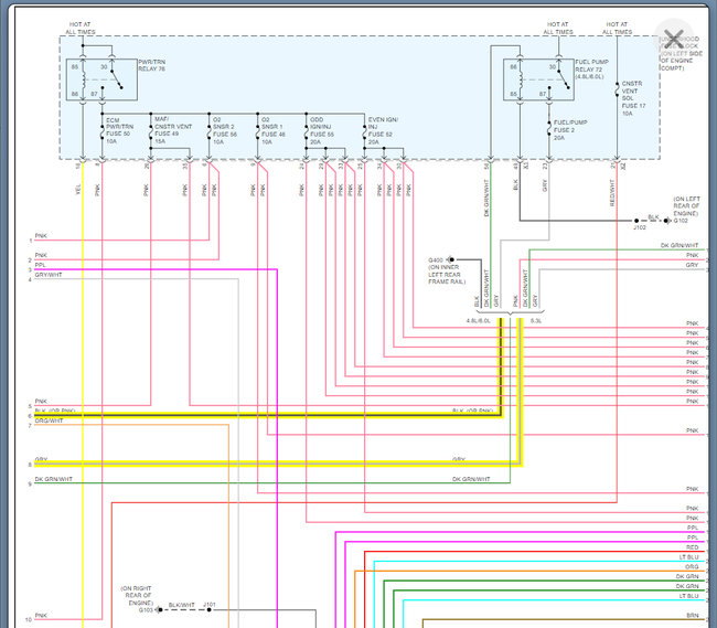

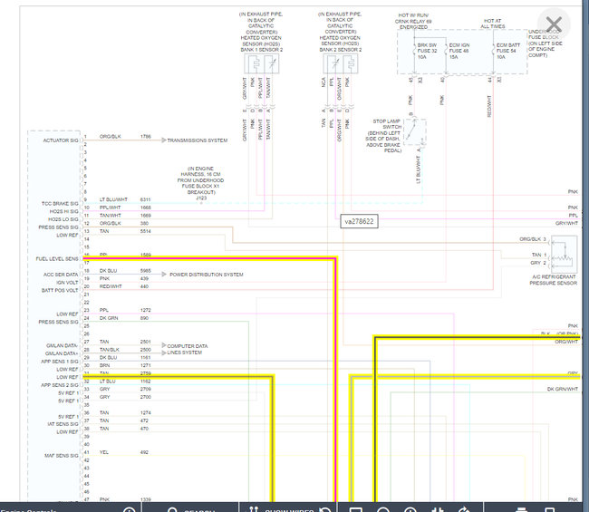

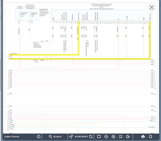

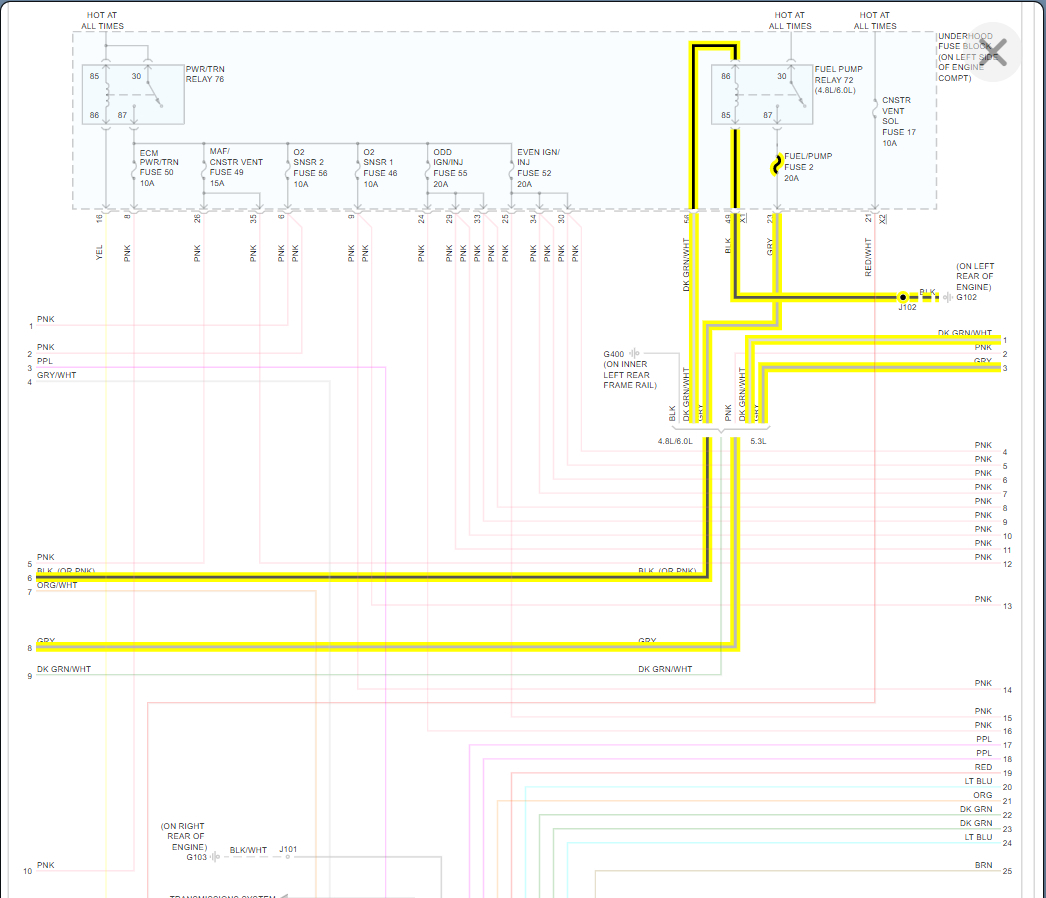

I think you are exactly correct. There is resistance in either the wiring or the control panel/circuit board.

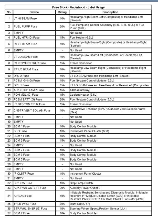

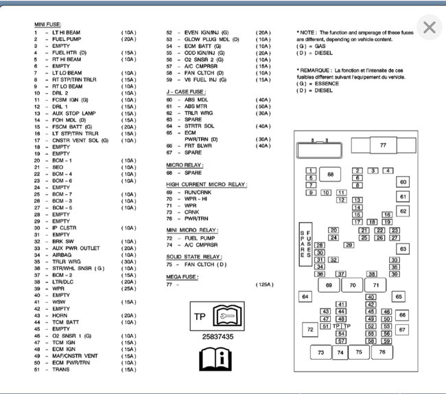

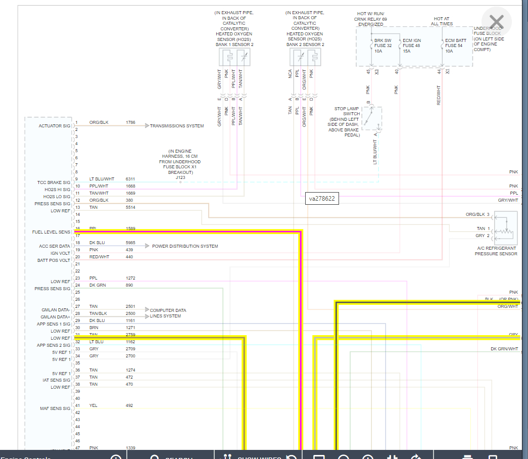

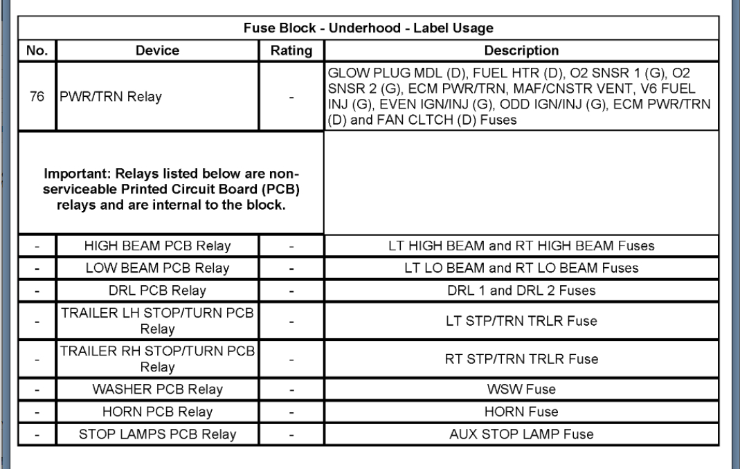

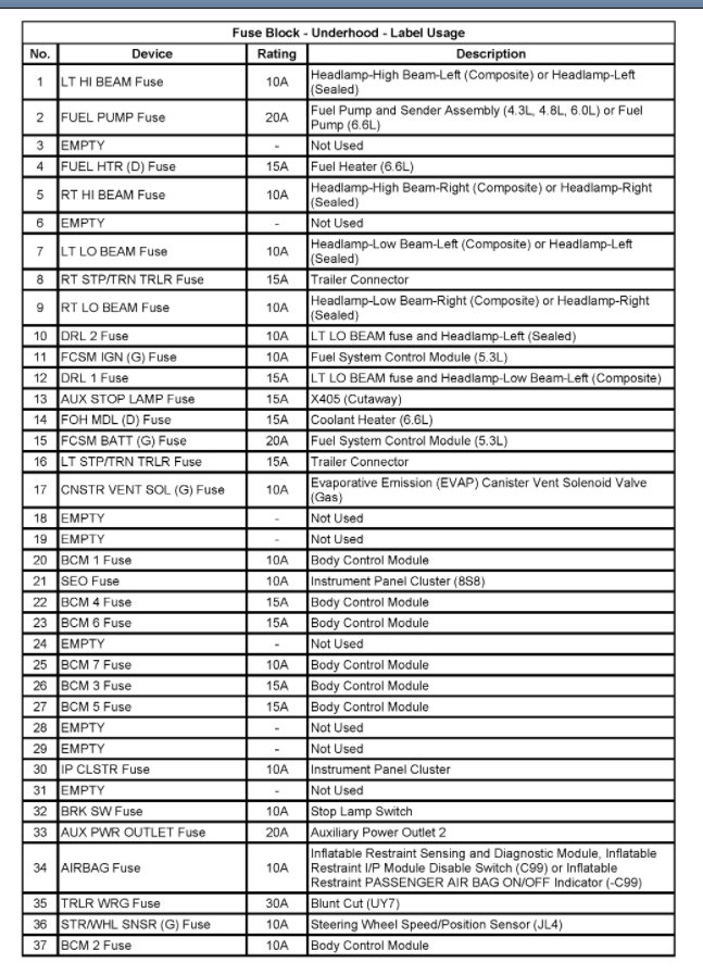

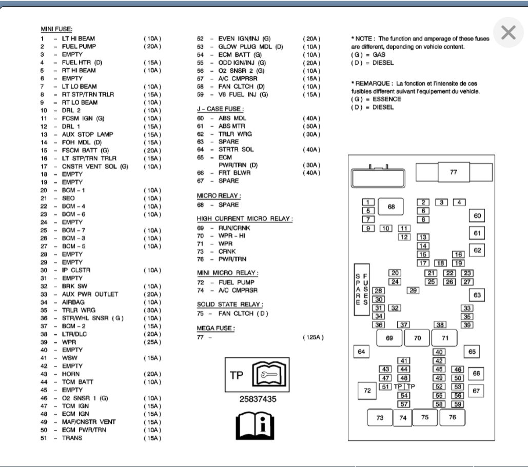

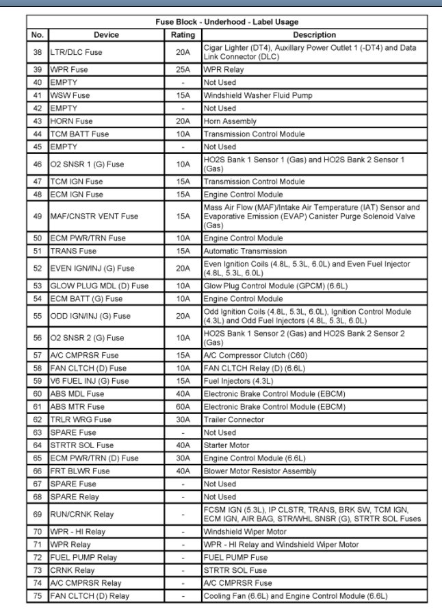

I am attaching the wiring diagram below and the fuse layout if you need (appears you don't).
Unfortunately the manual does not include a process on how to disassemble the fuse box as that is not a common repair. The OEM just recommends replacing it if there is an issue.
However, if you are removing the relay and still have voltage on the fuse 2 then you have a short on the circuit board that is allowing voltage through even though the connection is supposed to be remove.
https://www.2carpros.com/articles/how-a-car-electrical-system-works
What I would do in this case is just wire in an external relay. Basically if there is an issue with this board then you don't need the relay to run through it. You can just take each of these wires and cut them going in and out of the fuse block and wire in your own relay and fuse so that it avoids the issue.
If you are interested in doing this, let me know and we can help with questions. However, there are many kits out there. I included a picture of one below.

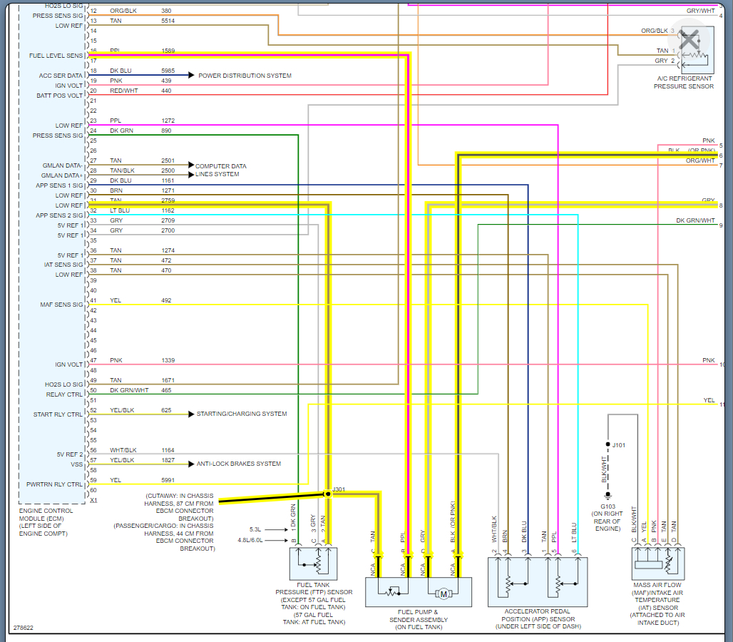

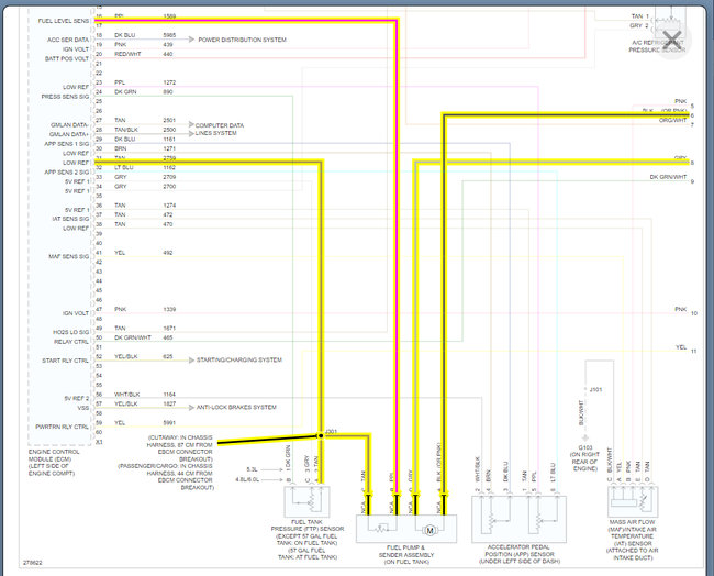

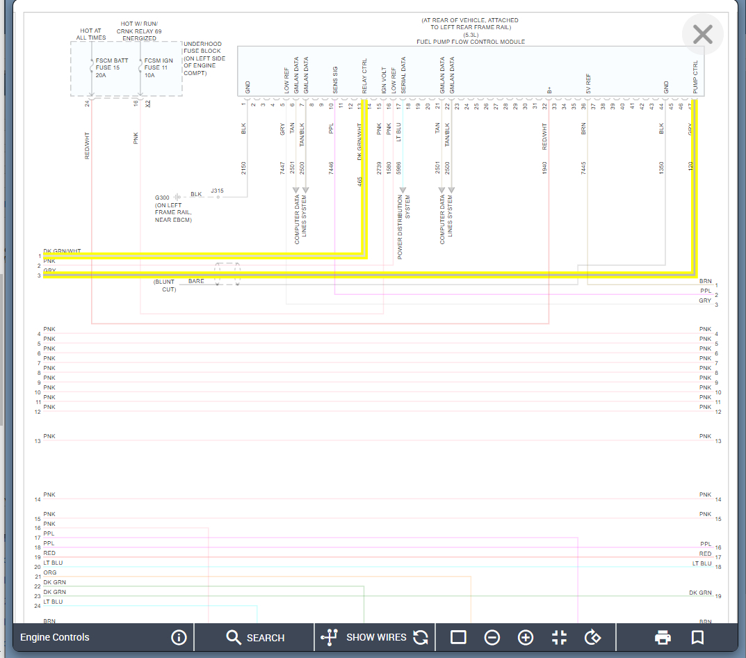

That is interesting. Where exactly did you find the corrosion?

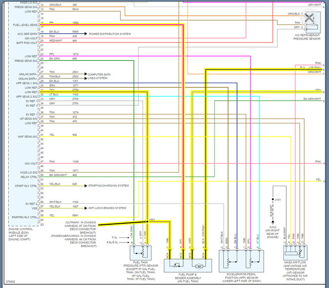

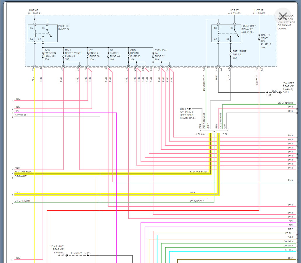

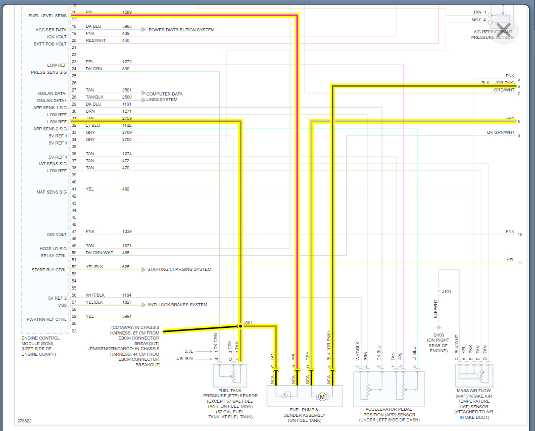

I suspect that is still the issue. I bet if you check the fuel pressure it will be low. Then if you check the voltage at the pump, that will be low as well. Which points to more corrosion or the connections are just not salvable.

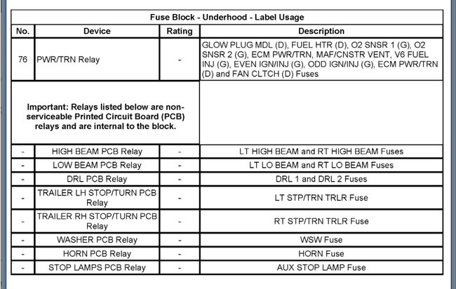

I attached the wiring diagram below but try using starter fluid in the intake. It may fire without the jump box on it and if it does then that is the issue.
