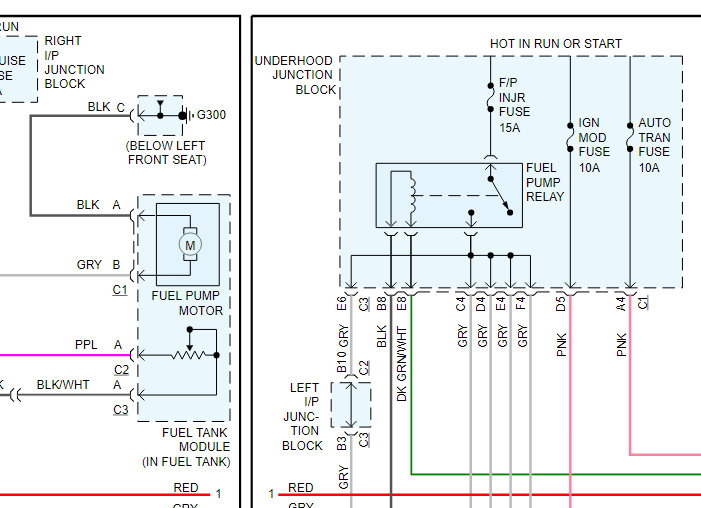

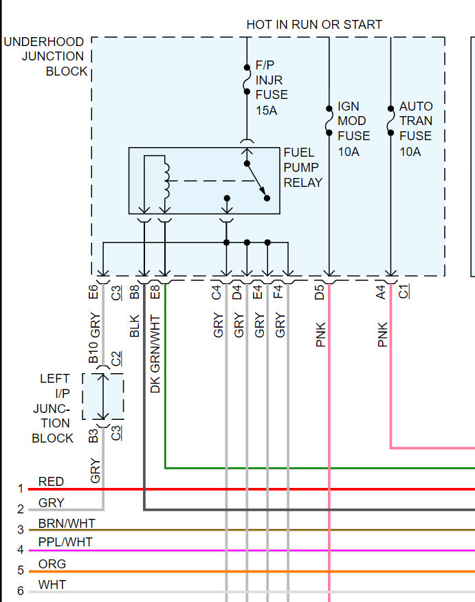

The Passlock is fixed, the security light does not come on anymore. It was solid on, before I did the resistor bypass. Once I added the resistor, I did the 'new key learning procedure' the light went out, and has not turned back on. Doing research on this, I learned that when the key is first turned on, the fuel pump is only energized for a few seconds, and wil turn back on when the key is set to start or the engine is running. From what I can tell, I am getting voltage at the wireharness, but the pump does not run, even for that 2 seconds.
For your other questions, I am getting spark but not fuel. I can get the engine to run for a few seconds by using aresol starter fluid. I can also get the car to run a few seconds by manually energizing the fuel pump at the tank wire harness to pressurize the system. I am getting fuel pressure at the fuel rail when manually running the pump.
I'm wondering if there is an issue with the other wires going to the fuel pump assembly. I think one set is for the fuel level (seems to be working) and the another is for tank pressure.
