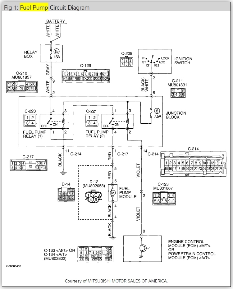

Hey,
I have this complete wiring diagram for the fuel pump for you. Please check the trigger wires and power sources.
Let us know what you find
Best, Ken
Jan 6, 2019 at 8:03 PM
CARADIODOC
  • 34,306 POSTS
They gave it a double whammy. The first relay turns on when the ignition switch is on. The second one turns on when the ignition switch is on AND the Engine Computer turns that relay on. If either relay fails to turn off, the other one will handle that.
What I would do is remove relay number 2, then connect terminal #4 to terminal #1. The fuel pump should run by just turning on the ignition switch. If it does, there's one other test, but the definitive test is to stick a tiny piece of wire into terminal #4, reinstall the relay, turn on the ignition switch, then the pump should run when you ground that wire. If it does, the Engine Computer isn't turning it on during cranking. If the pump DOESN'T run, the circuit can be left like that for troubleshooting.
