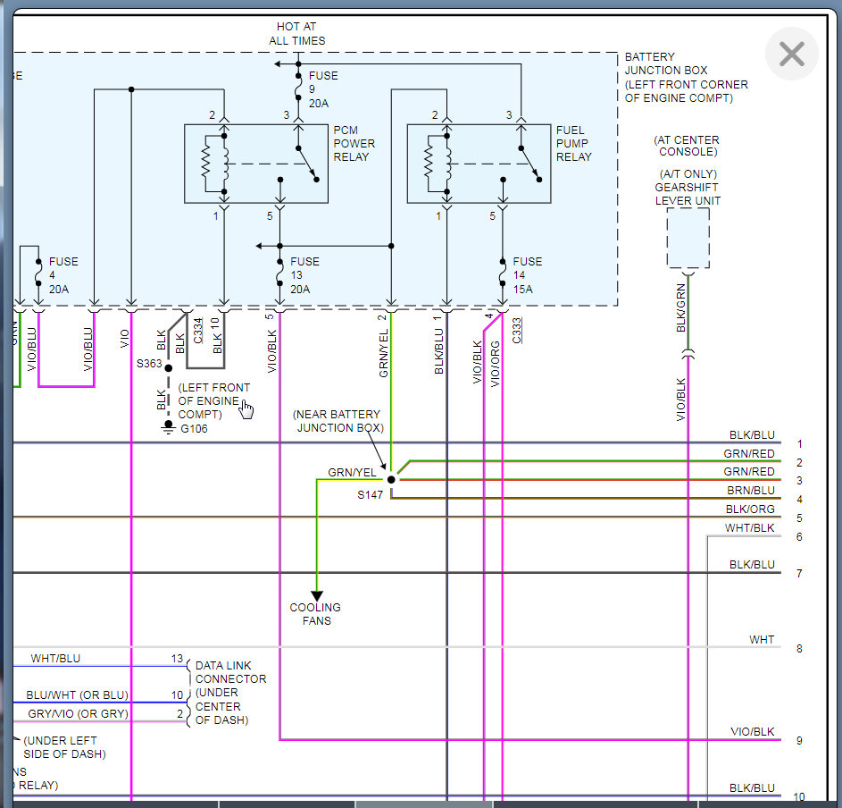

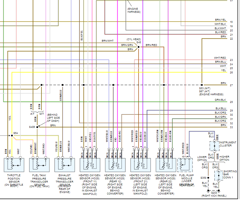

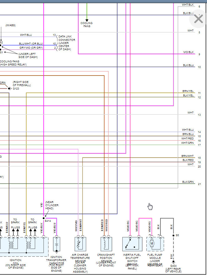

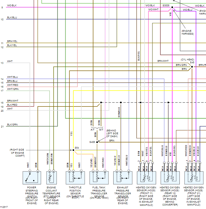

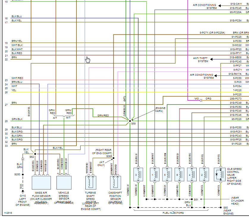

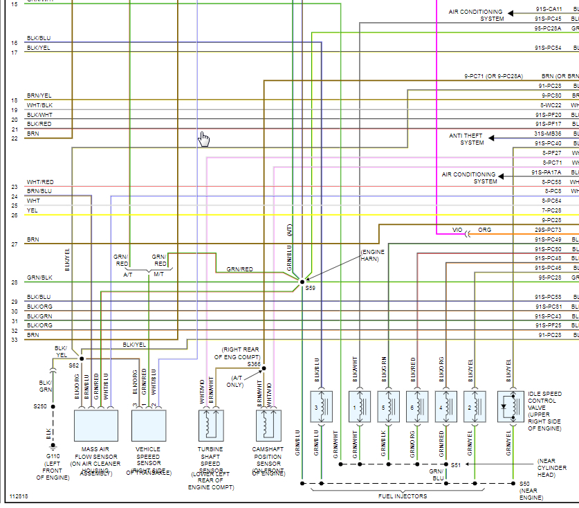

Here are the power-train management diagrams that includes the fuel pump which should get you started.
As you can see this is a pretty involved diagram and due to the way we have to break it up to attach it, it is 12 pages by itself. So attaching all vehicle diagrams would be a lot of info.
I would suggest working on each system and when you need a diagram for that system, start a post requesting that one and we can get it pretty quick for you.
