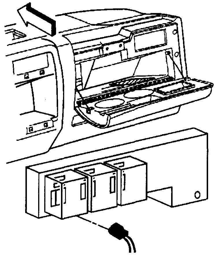

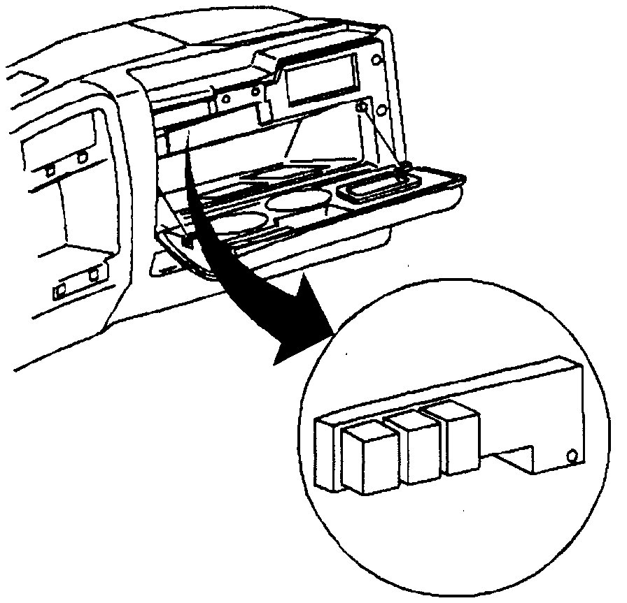

Before you take the tank out to check the pump (which may be bad), confirm the fuel pump relay is bad. It is behind the glove box. Here are the directions for removal and replacement. Don't just replace it without checking it first. If there is another relay in the box that has the same part number, switch them or here is a link showing how to check one:
_____________________________
Here are the directions. That attached pictures correlate with the directions.
1996 Chevy Truck S10/T10 Blazer 4WD V6-4.3L VIN W
Fuel Pump Relay
Vehicle Powertrain Management Fuel Delivery and Air Induction Fuel Pump Fuel Pump Relay Service and Repair Procedures Fuel Pump Relay
FUEL PUMP RELAY
pic 1
Fuel Pump Relay Retainer
Pic 2
Electrical Center Connector
Pic 3
Fuel Pump Relay
pic 4

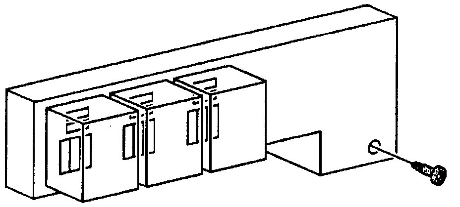

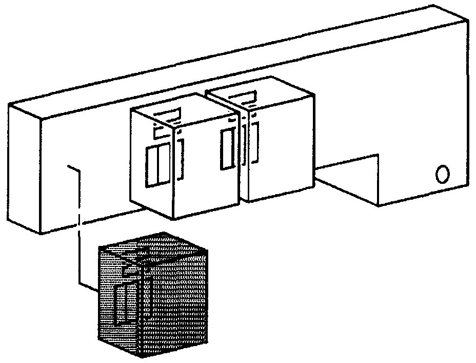

REMOVAL PROCEDURE
NOTE: The relay center is located in the glove component.
1. If installed, remove the retainer.
2. Remove the electrical center connector.
3. Remove the relay by depressing the bracket clip at the rear of the relay or by removing the bolts from the retaining bracket.

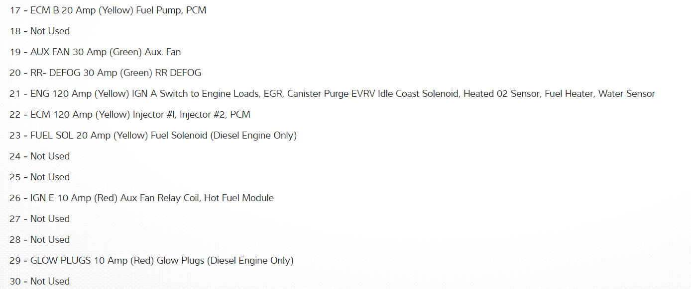

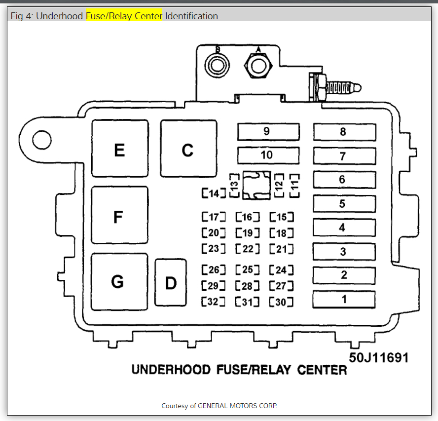

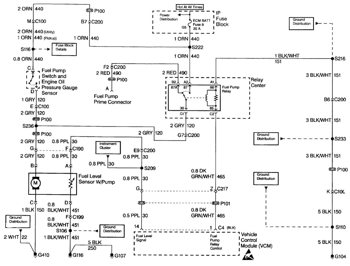

First thing will be to test the pump and it's wiring to see if it works. To do that go to the relay box under the hood. and look at the harness coming out of it, there will be a short Red wire that isn't connected to anything. That is the fuel pump prime connection. If you apply battery voltage to it the pump should come on. If it doesn't pull the fuel pump relay and you will see a diagram on it showing what the blades do, you want the ones numbered 30 and 87 Those are the feed to the pump and the battery feed from the ECM BATT fuse (#9). Take a test light and connect it to battery positive and touch those two contacts in the relay socket. On pin 30 the light should come on if the circuit through the pump is good as it will be a ground through the pump. If no light you have a problem in the Gray feed wire in the harness to the fuel pump. If it seems to work then connect the test light to ground and touch the 87 connector. This is the battery feed to the relay and the light should come on.
If those show good put a jumper across them and the pump should come on. If it does then you need to test the control side of the relay. Those are pins 85 and 86. With a test light connected to battery positive touch pin 86, it should light as this is the ground for the relay. Next connect the light to ground and touch terminal 85, then turn on the key, the light should come on for about 2 seconds. If it does the control side is working.
As it has been setting I would suspect either the pump connector to have corrosion (very common) or the pump itself is bad.
The other circuit that can verify this is to crank the engine until the oil light goes out or the gauge shows pressure. That will trigger the power feed through the pressure switch and send power to the fuel pump. If the pump doesn't come on in either case you will likely be dropping the tank to get to the pump connector and pump. You might be able to disconnect the pump pigtail without dropping the tank, if you can reach it.
Another test is to give the fuel tank a couple solid hits with a rubber mallet or similar, if the pump is marginal and sticking on a bad segment this can sometimes shock it enough that it starts working at least enough to test it, if it does start working this way do not trust it to keep working though.

Thank you very much! You guys rock! I removed the no name alarm/remote start, verified the relays were good, then put power to the red wire under the hood. I loosened the straps enough to get the connector off the top of the replacement pump, and realized it was not attached to anything in the pump. The connection came off in the pump! I removed the pump and re-connected the wires and it is up and running on it’s own!

See below to locate the pump relay
https://www.2carpros.com/forum/automotive_pictures/12900_pumprelay1_1.jpg
https://www.2carpros.com/forum/automotive_pictures/12900_pump_relay2_1.jpg
https://www.2carpros.com/forum/automotive_pictures/12900_oil_sending_unit_and_fuel_pump_circuit_14.gif

RASMATAZ
  • 75,992 POSTS
The fuel pump relay is in the convenience center see below
https://www.2carpros.com/forum/automotive_pictures/12900_fp_relay_9.jpg

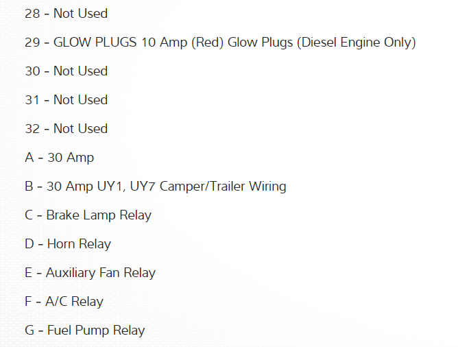

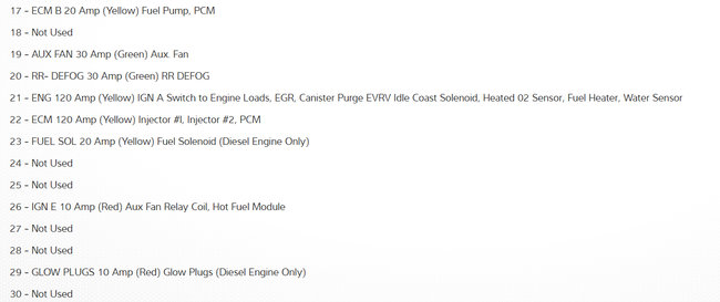

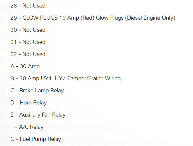

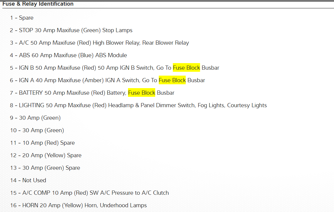

CBBECK
Will not start fuse is good. Need to check relay next but don't know where it is
Jan 30, 2021 at 8:36 AM (Merged)
WRENCHTECH
  • 20,761 POSTS
It's located behind the glove box but this truck is designed to run without aq fuel pump relay. https://www.2carpros.com/images/external/83268759.gif
