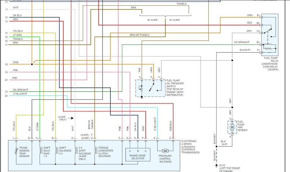

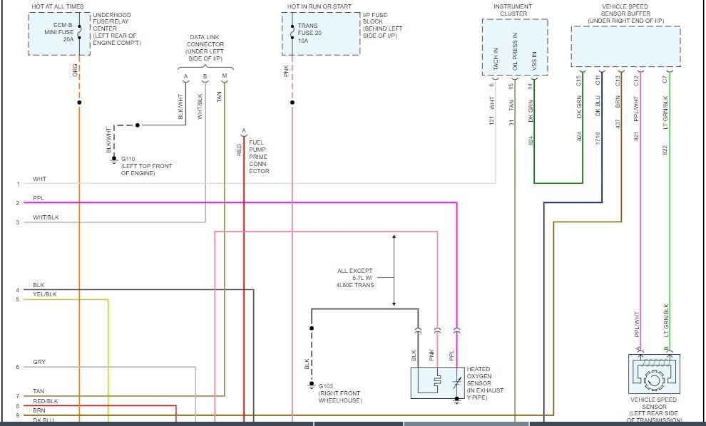

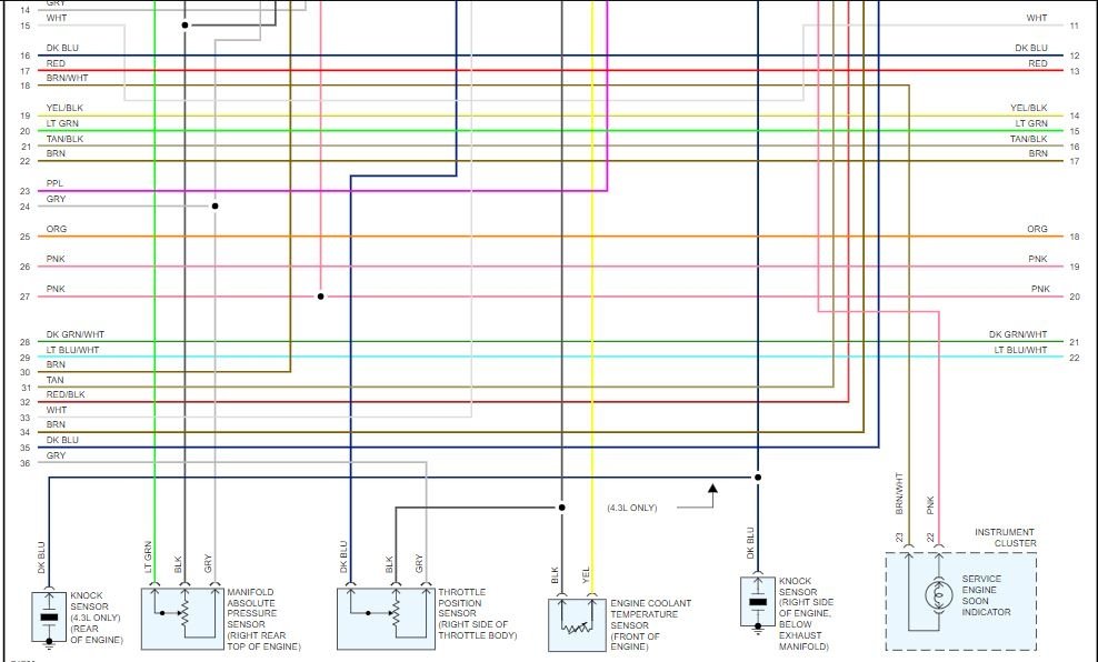

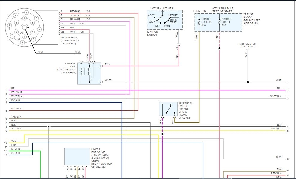

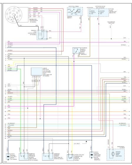

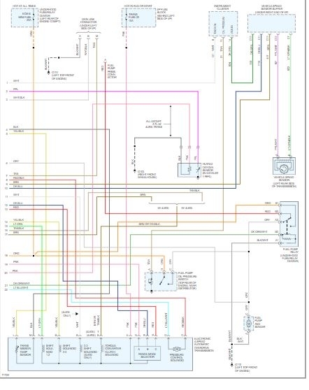

Good afternoon,
I thought I would help out as well.
The ECM should only provide 5 volts to the MAP sensor, TPS, and the EGR valve grey wire. If you have 12 volts, it is either a short in the harness to the 5-volt circuit or a bad ECM.
I attached a wire diagram for you to view the system.
Oct 25, 2019 at 8:36 AM

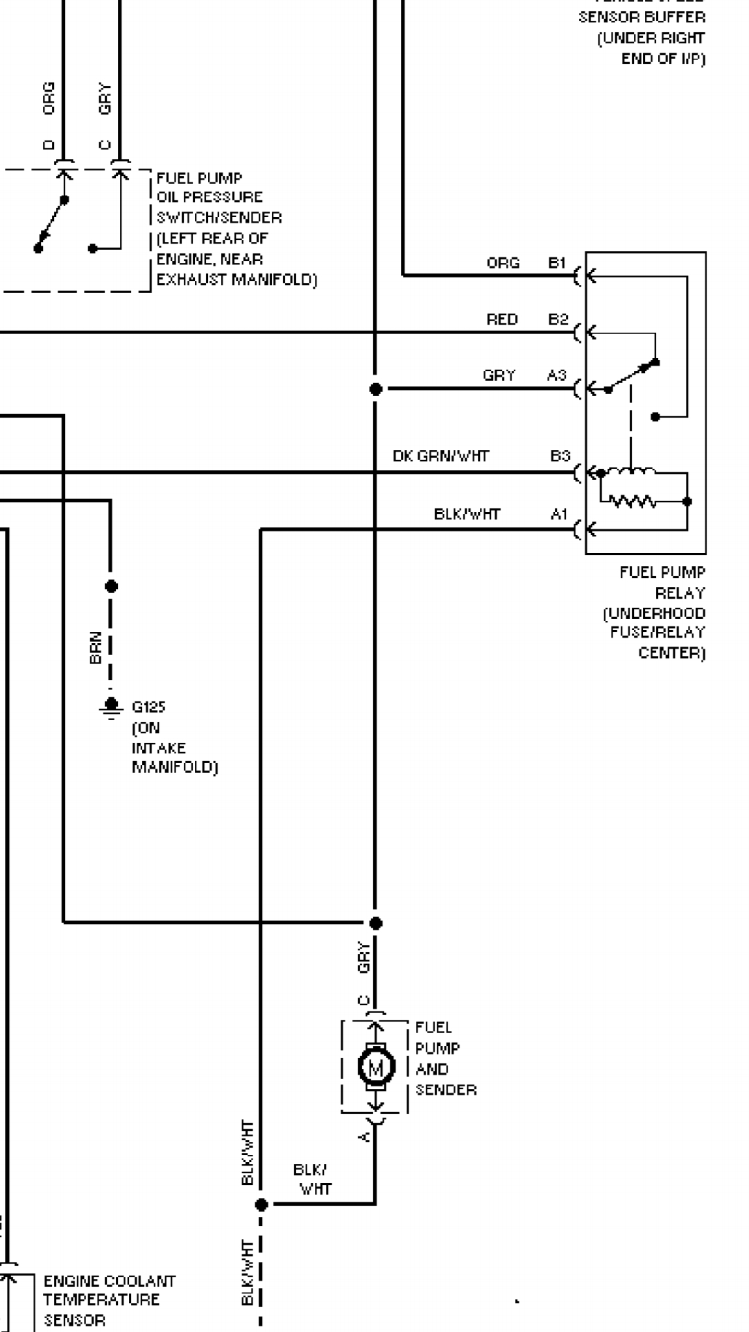

Okay, are you getting 12v to the fuel pump while cranking? Here's some diagrams to check it correctly: https://www.2carpros.com/articles/how-to-check-fuel-system-pressure-and-regulator
Oct 27, 2019 at 11:49 AM

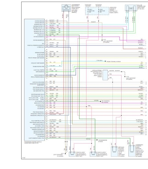

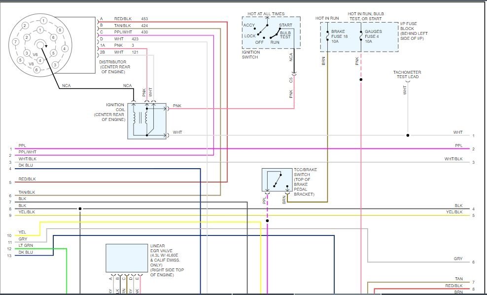

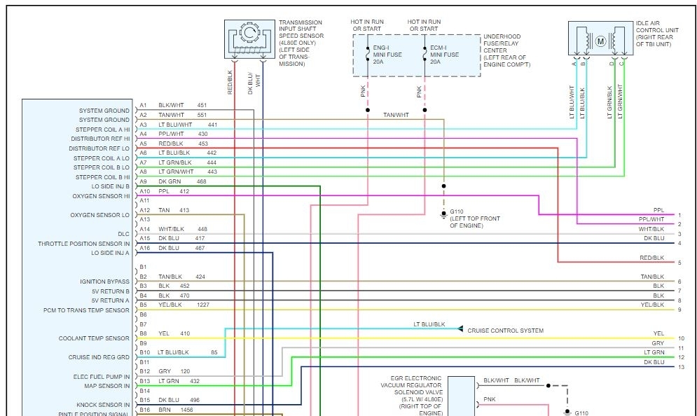

Also, check the end wire on the EGR. I sent you a diagram that included the EGR. It should be 5 volts as well.
Oct 27, 2019 at 12:04 PM

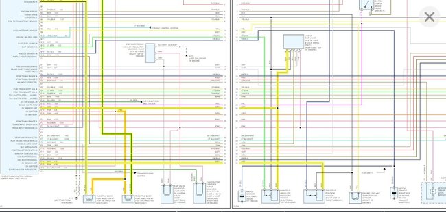

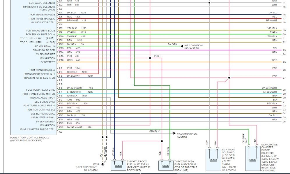

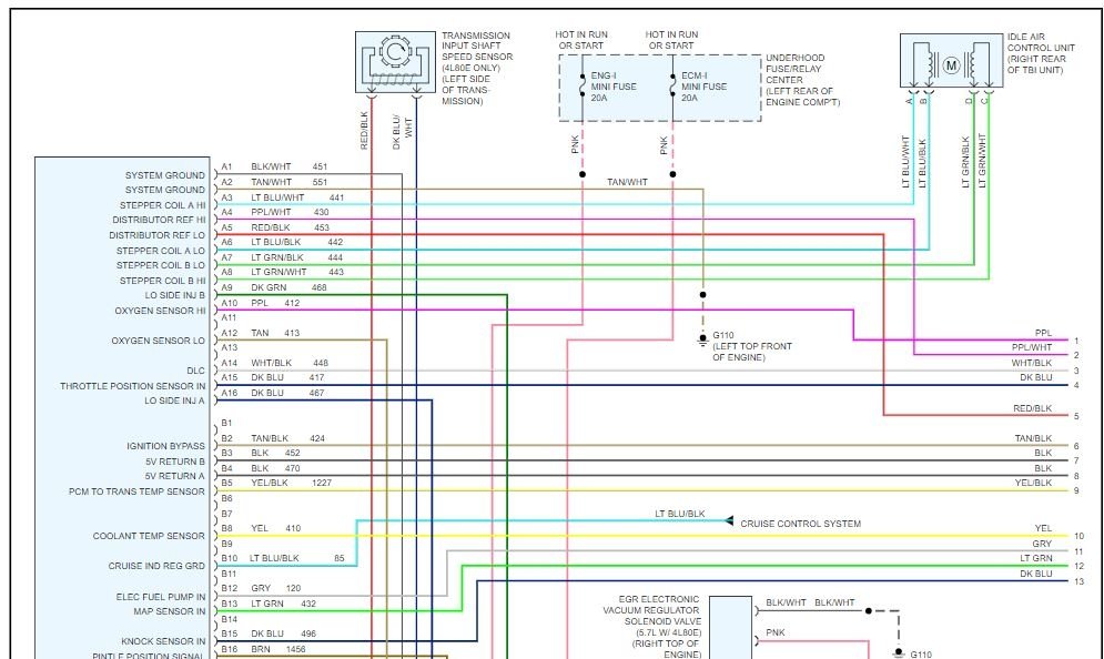

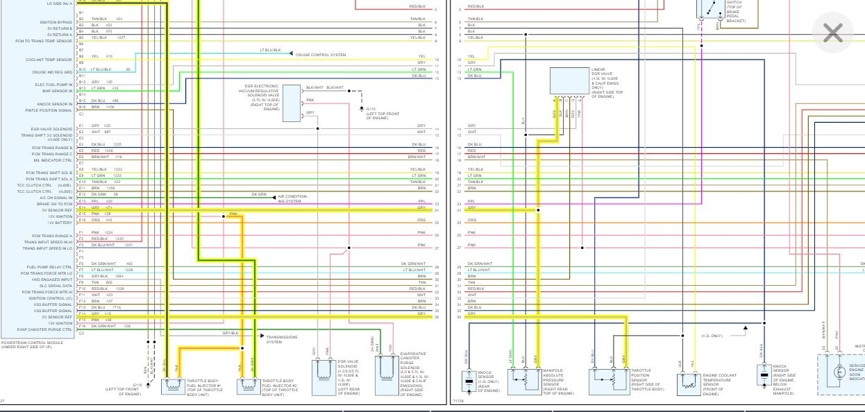

I sent you the complete diagram for the power train management system. There are 3 parts.
Let me know if you have an issue reading them.
Oct 28, 2019 at 8:22 PM
I blew up the diagrams for you so you can see better.
Oct 29, 2019 at 4:39 PM

Yes, I have 12 volts to fuel pump and no voltage at a4 where EGR comes from computer.
Nov 2, 2019 at 12:07 PM
That should be 5 volts and comes from the ECM.

You have a wiring issue. The gray wire at the map sensor is the same wire. There is an issue in the harness where they come together. I would check the harness carefully for any damage. You may have a break inside the harness.
