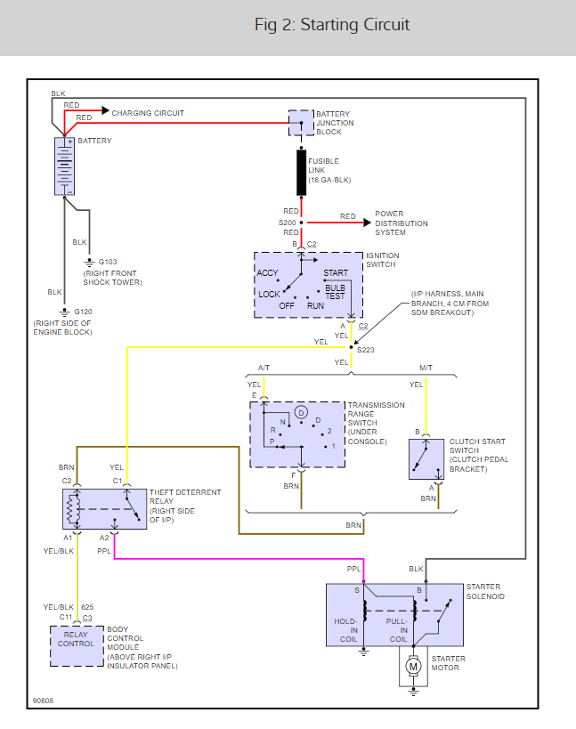

Looking at the diagram it looks like it has a junction block after the battery where the fusible links are on this one, not at the starter. Here is the starter wiring diagrams so you can see how the system works and a guide to help you see where you are losing power.

Yup. I tested every single fusible link with the test light. They were located by the battery. They were all good. Also, I got the ignition switch because the AutoZone tech said that was the problem. After I found out that it was not, I returned the switch. So do not assume I just throw parts at a problem. So after the fusible link junction, the pink ignition wire has no power at the fuse box under the hood. Do you know if there is somewhere else that wire goes before reaching that fuse box?

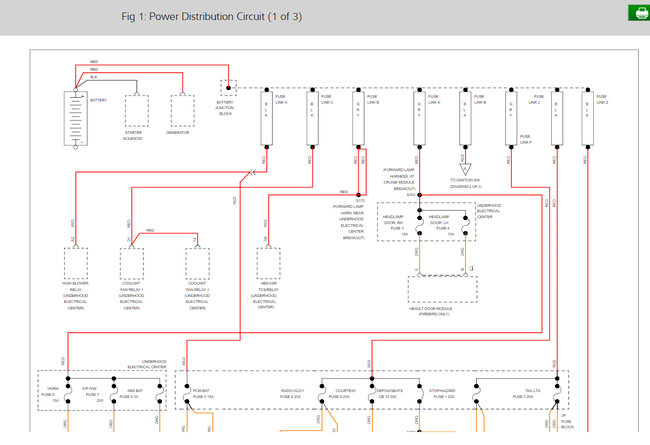

The power feed for the ignition switch comes directly from the fusible link on the red wire, from there the ignition switch feeds all the "keyed" fuses. http://i1198.photobucket.com/albums/aa448/Wrenchtech/62461479.gif https://www.2carpros.com/images/external/62461480.gif

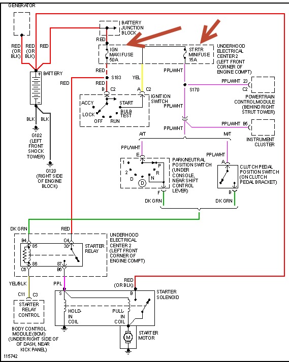

The main supply goes into the ignition switch and then the ignition switch feeds the inside fuse box. Access that connector from under the dash. It is probably bolted together with a single bolt through the center, accessed from under the dash.
Please check fusible link "E". Here is a wiring diagram below so you can see what I am talking about:
This guide should help as well.
Check out the diagrams (below). Please run some tests and get back to us.

Thanks for the guide and wiring diagrams. You hit it on the money the fusible link was out. I replaced it and the ignition switch and the car works great! I love this site.

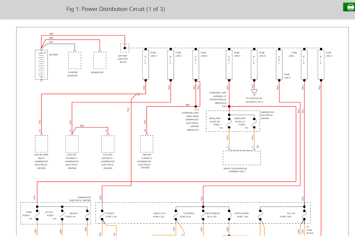

Check fuses pointed out in drawing under-hood fuse box.
