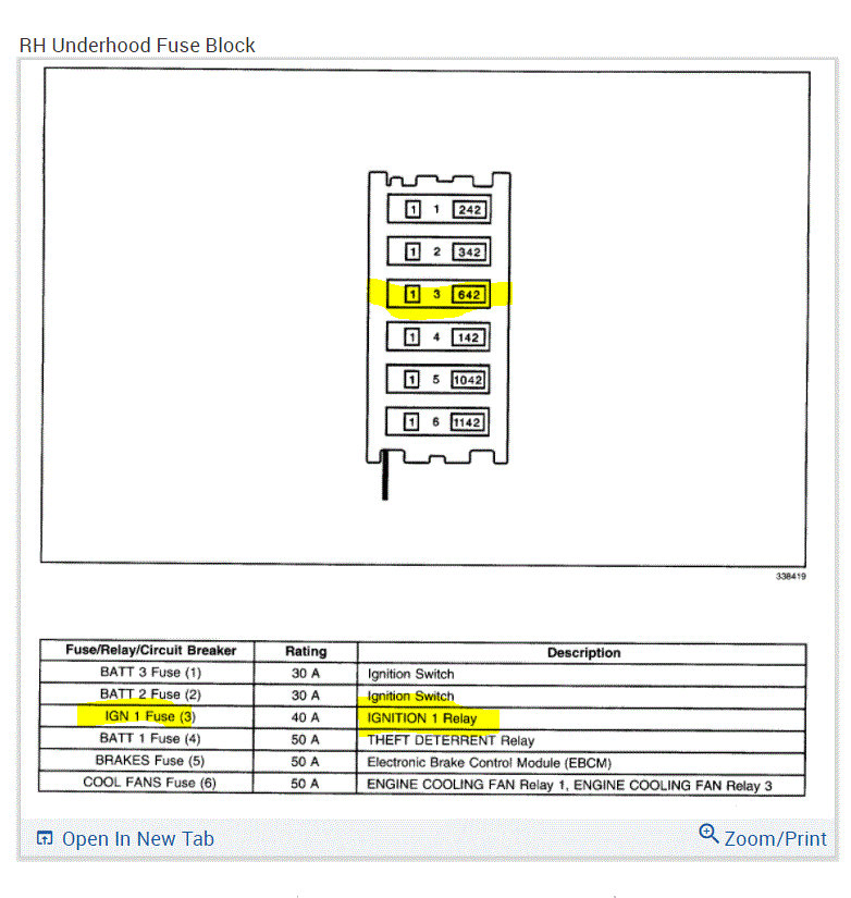

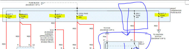

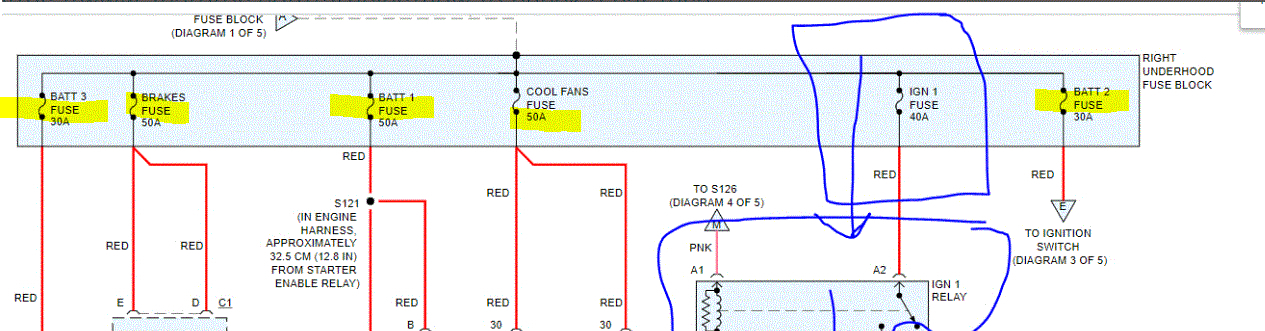

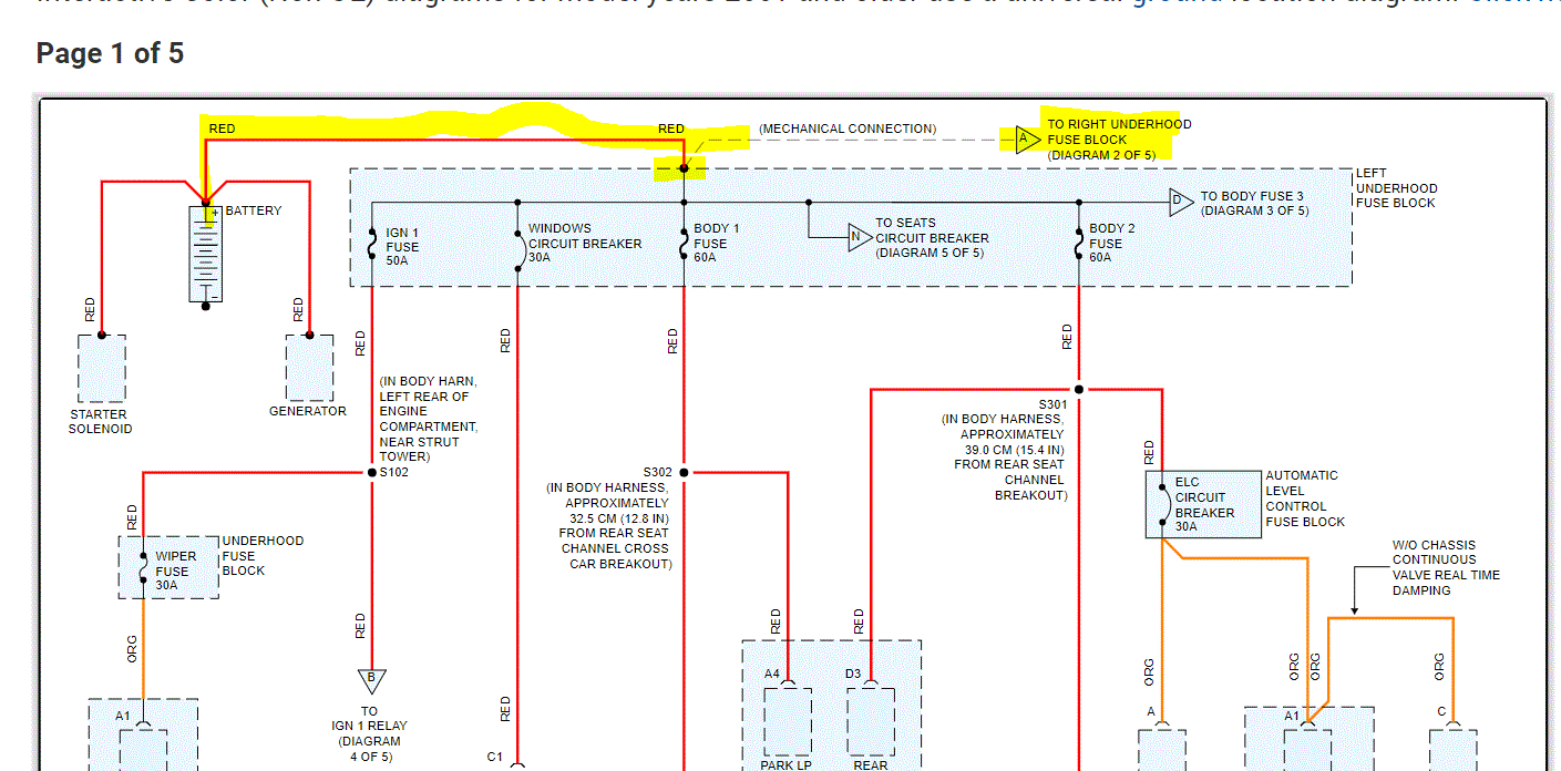

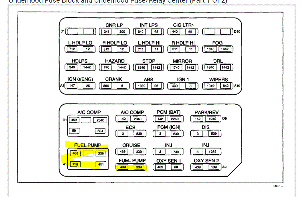

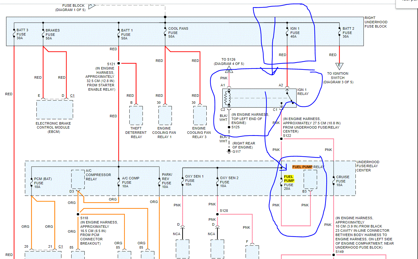

I tested the fuse panel for power and found that only some of the fuses are getting power. The fuel pump fuse and ignition fuses along with a couple others aren’t getting power. I can jump the starter relay and get the car to crank but it won’t start because no fuel is being fed through the system.
