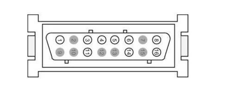

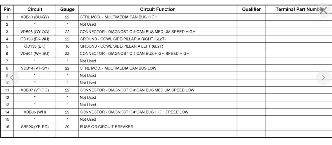

Was there power to the data link connector? Did the shop verify that?
Feb 12, 2020 at 9:20 AM
WILLIAM WARNER
  • 4 POSTS
Yes there is power to it.

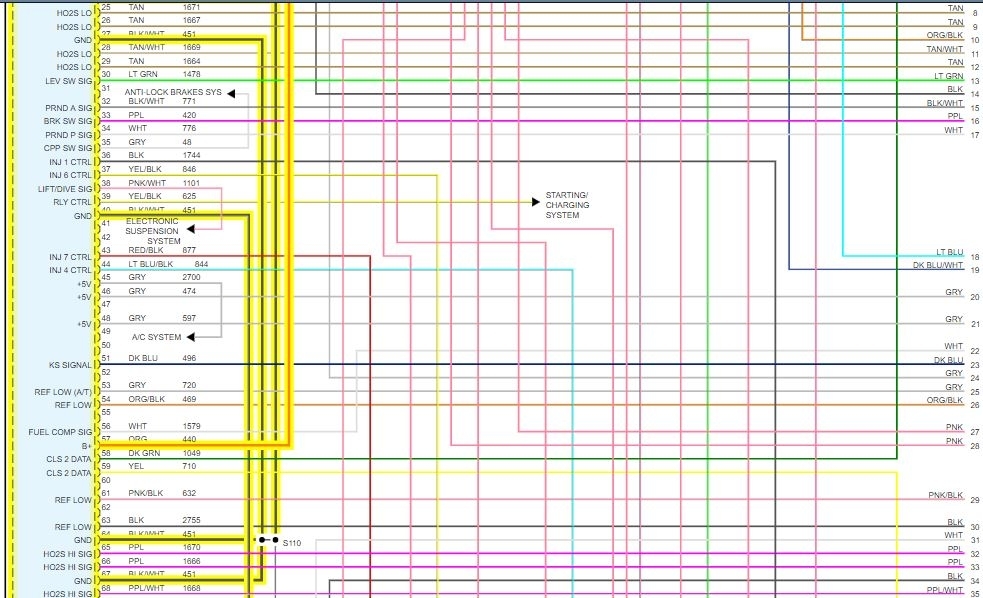

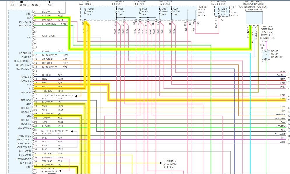

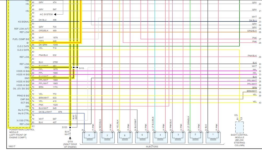

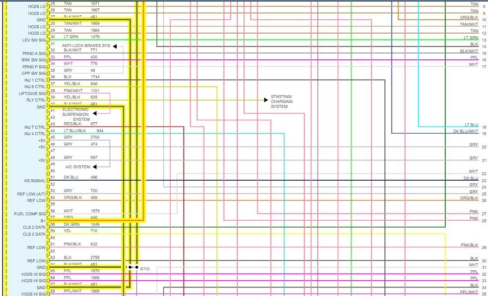

Okay, back to power. Did the shop check for powers to the modules? The ECM would be the first one to check.
Does the check engine light come on with the key in the on position?
I attached the powers and grounds to the ECM to be checked. Check those pins for power and the grounds as well.
