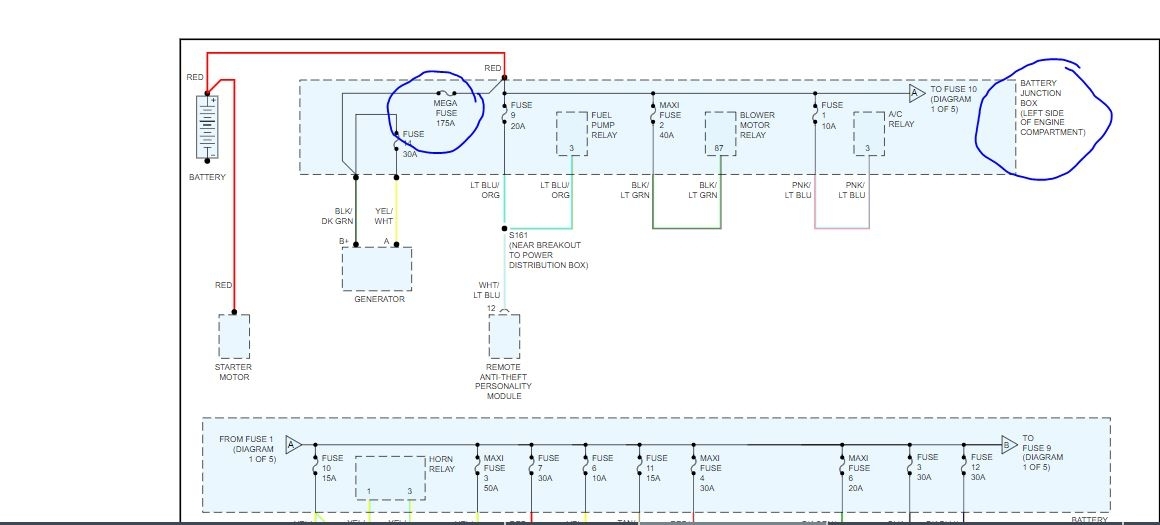

i just got done putting a engine and transmission in my Suv listed above SOHC . when i try to start it the battery arced significantly when attaching the positive cable.I disconnected the cables going to the power distribution box. i left the hot wire going to the starter and hooked a hot wire to the alternator I don't have any power whatsoever.I have tried to find information on the battery to power control box and exactly what goes where and all i get is stuff about mega fuse. any information you could give me about what should go where starting at the battery would be greatly appreciated.
