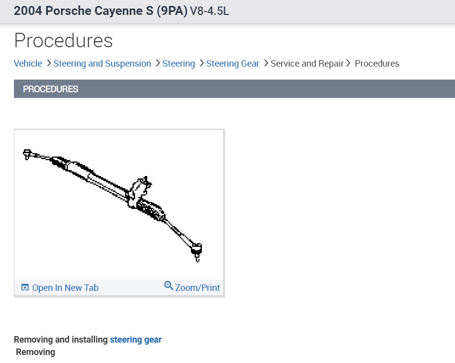

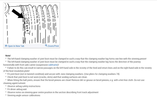

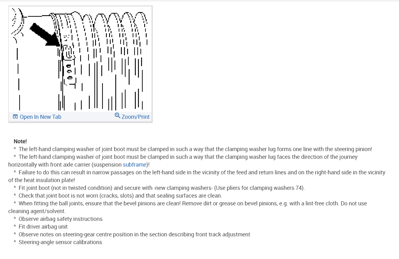

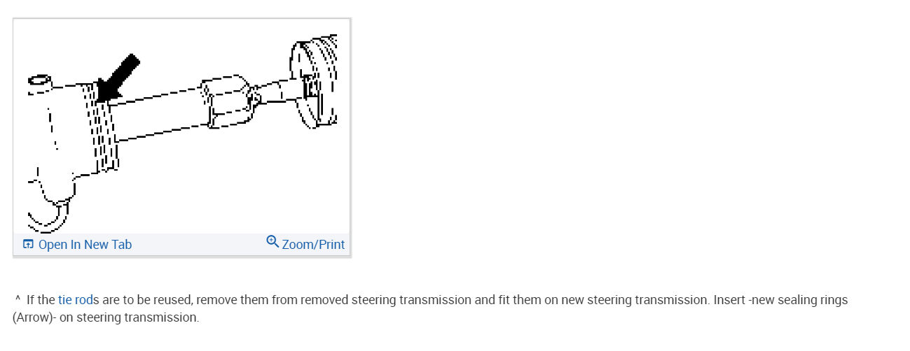

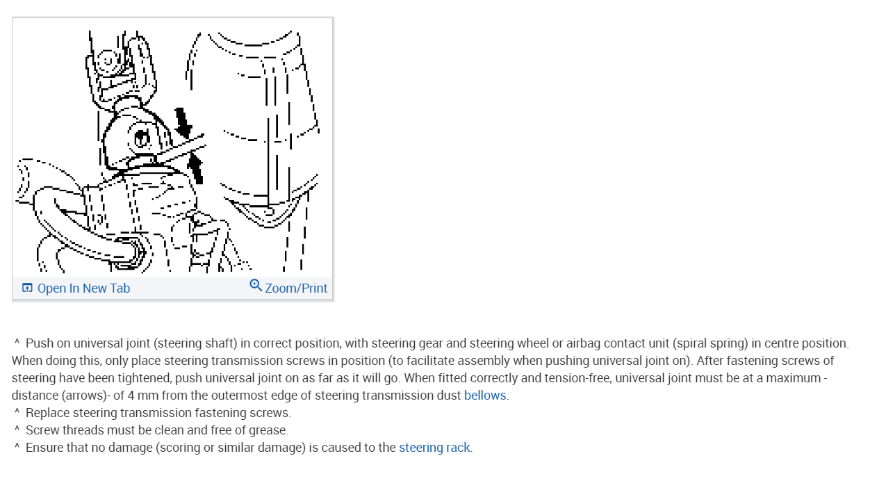

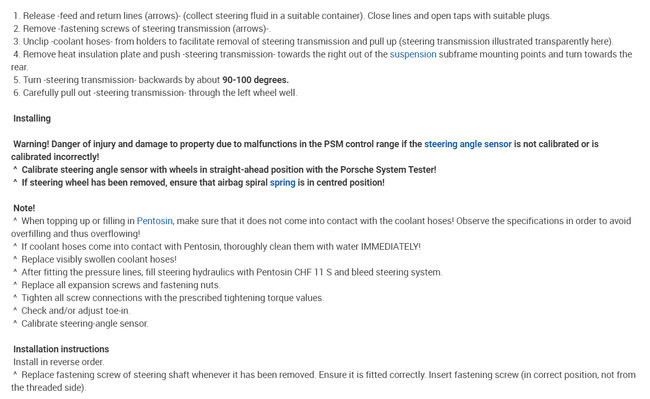

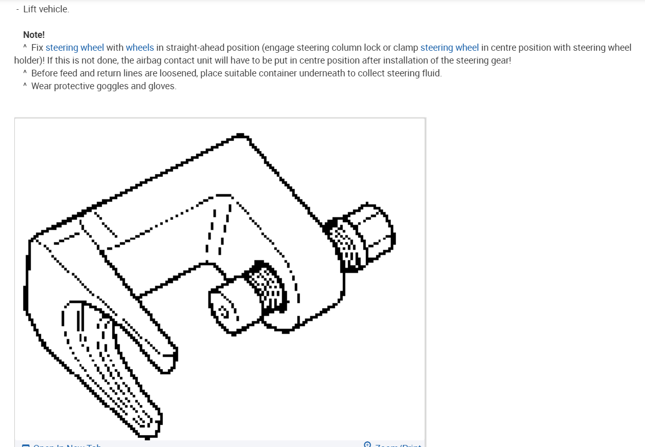

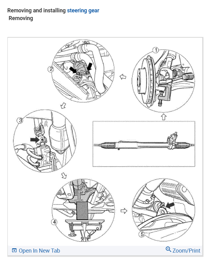

No, the pressure will go to zero when blocked, the pump has an internal relief valve to dump pressure when blocked or none is needed. Does the pump have wires coming off of it? If not the selector valve inside the rack is out and needs replacement. Here are instructions in the diagrams below on how to do so. Check out the diagrams (below). Let us know what happens and please upload pictures or videos of the problem.

The fact that it goes to 1,300 pounds means the pump is working. When the wheels are not being turned the pressure is idle 80 pounds, then when needed the pressure ramps up. Are there any codes? If you have not run, then we should this guide can help, also are there any wires coming from the pump? The pump could be on the edge of not working and it needs a rebuild but I have seen this problem before and the rack fixed it.

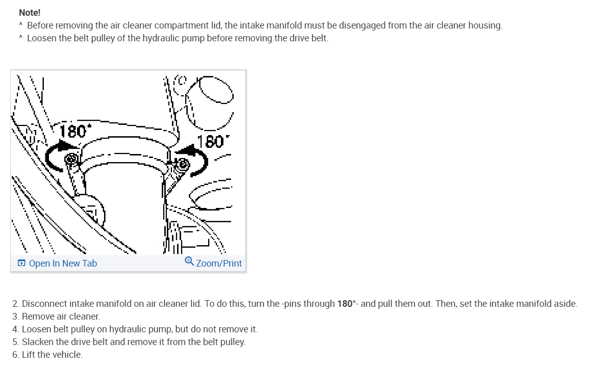

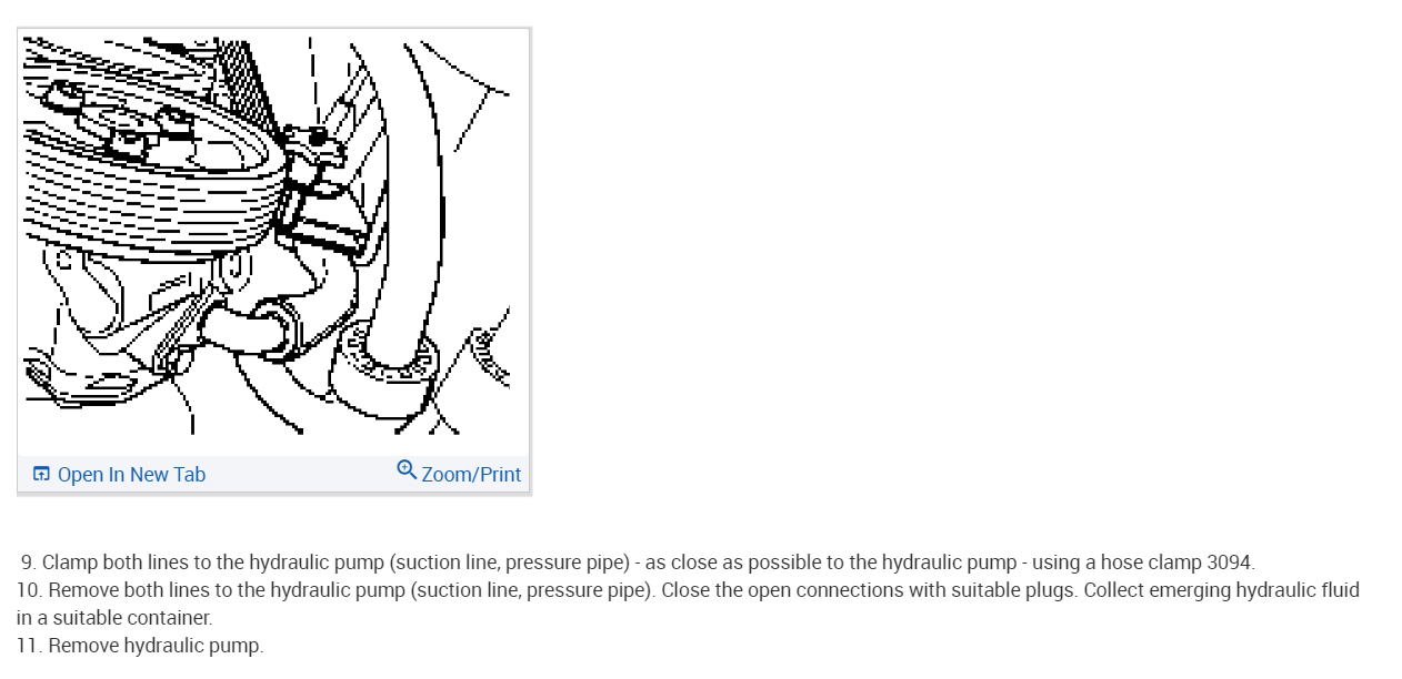

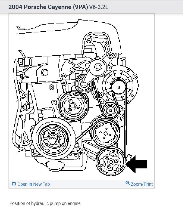

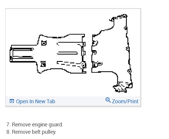

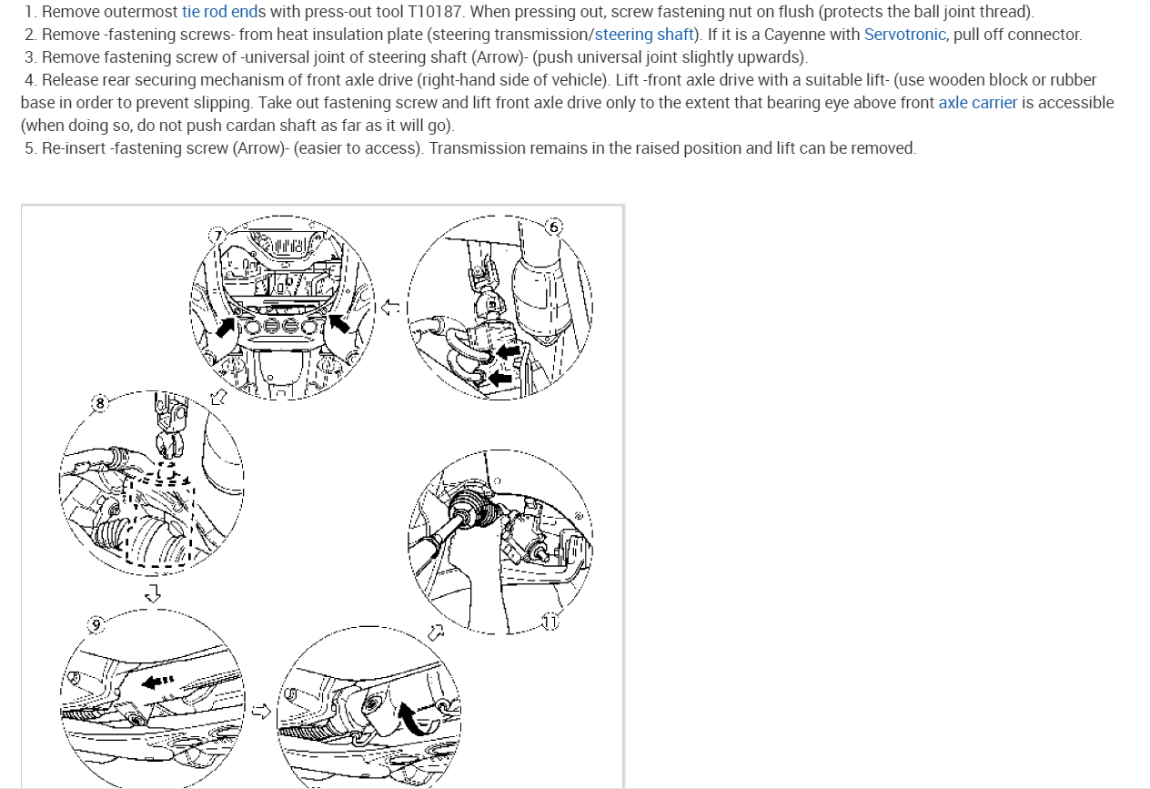

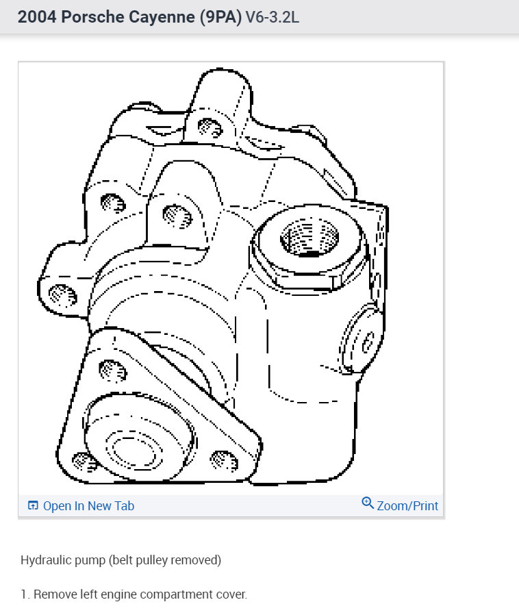

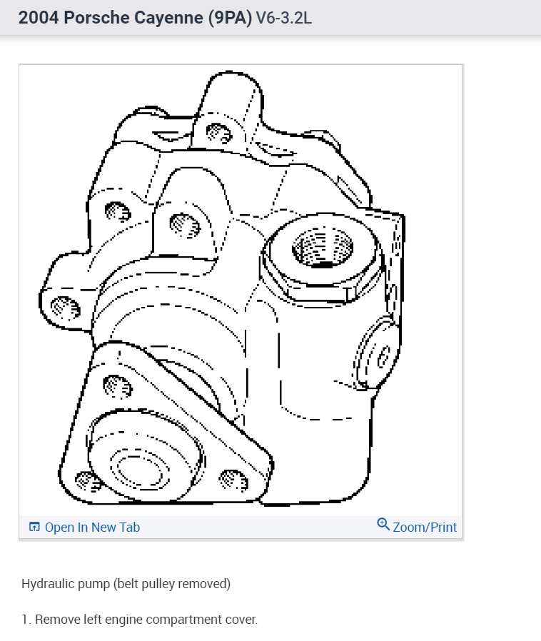

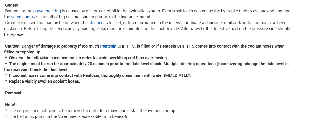

Yep, it could be the pump failing intermittently, here are the instructions on how to change the pump out. Check out the diagrams (below). Please let us know what you find. We are interested to see what it is.
