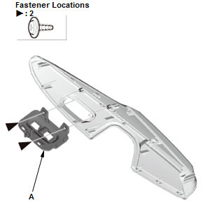

1.
Remove the pull pocket cap (A) and the screw (B). Pic 1

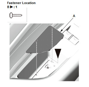

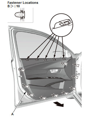

2.
Start at the bottom edge of the front door panel (A), remove the clips (B) with a commercially available trim pad remover. pic 2
3.
Starting at the rear, pull the door panel. pic 2

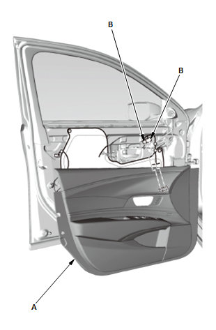

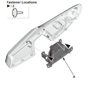

4.
While holding the front door panel (A) away from the door, disconnect the front door wire harness connector(s) (B). Pic 3
_____________________
Door armrest removal See picture 3
1.
Remove the front door armrest (A).
2.
Driver's side: Disconnect the power mirror switch connector (B).
3.
Disconnect the power window switch connector (C).

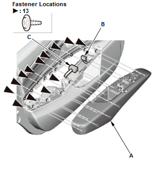

Door Pocket Picture 4
1.
Remove front door pocket (A)

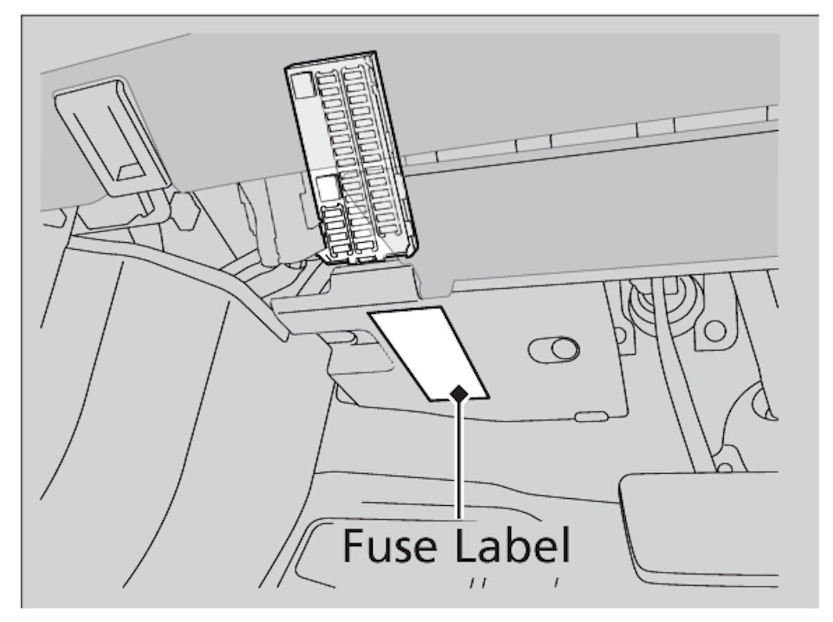

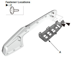

Power window switch Picture 5 and 6
1.
Remove the power window switch panel
_____________
The last pic shows where the wiring harness connects. Install is the reverse of removal.
